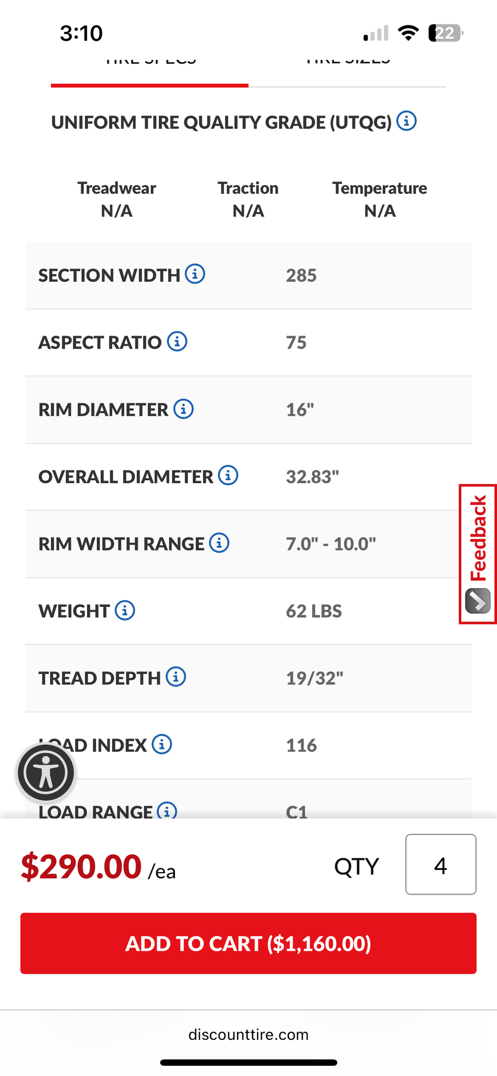

Load range C is probably much more appropriate, but have very limited offerings for a 33” tire, except for a 17” wheel. There are few 5x150mm 17” wheels, with a reasonable offset.
The 51lb 17” (285/70R17) tire, is 9+lb lighter that the 60-62lb 16”(285/75R16) tire, on paper 🤷🏻‍♂️
I think that you’re “losing the forest, for the trees”, by locking in on wheel weight, ignoring wheel offset, and tire weight/options, but I’ll bow out now.
Toyo 285/75R16 load range C:
Pick your poison. Wheels/offset/tires/weight, but I’m using simple old school math.

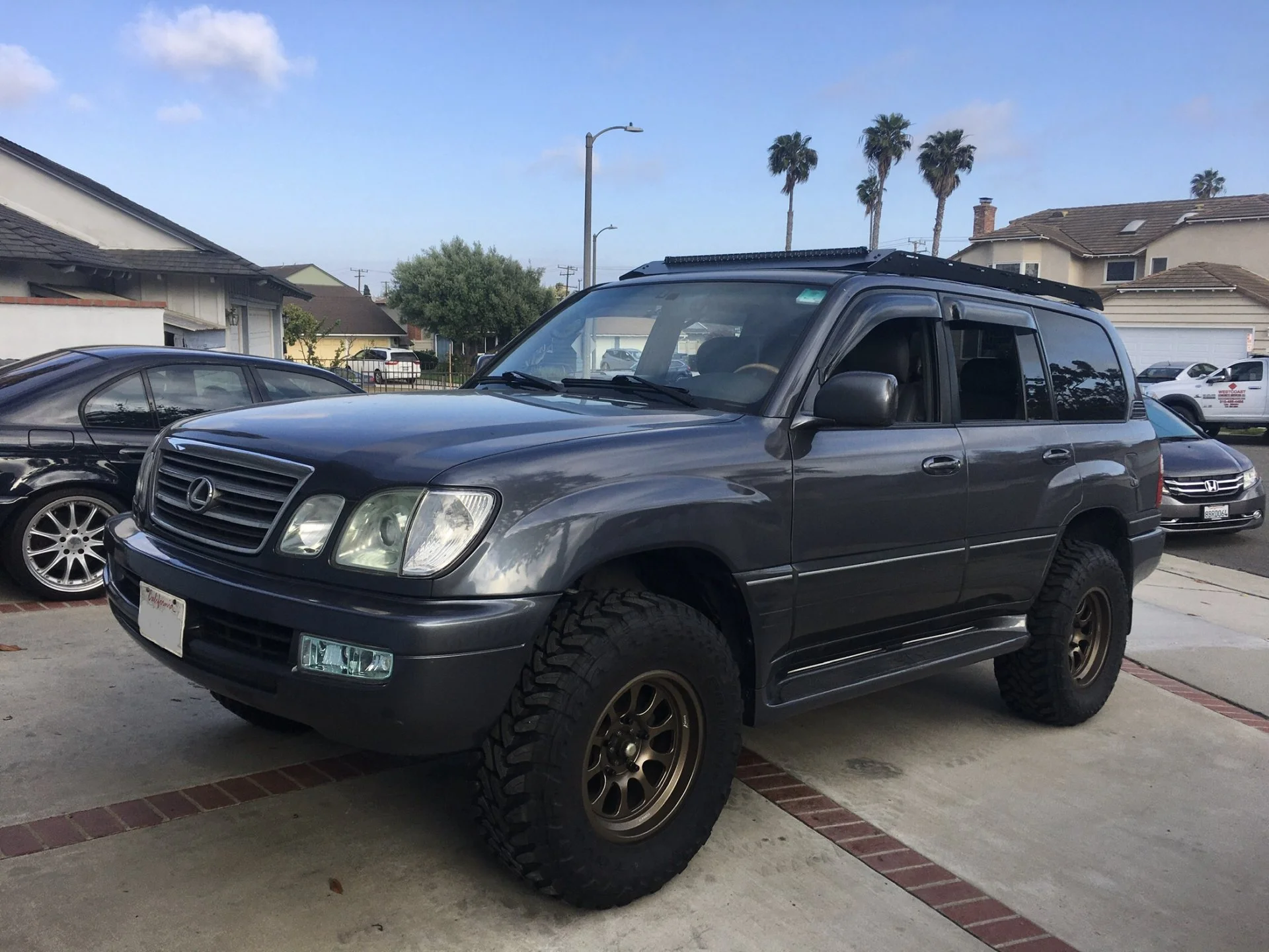

So I've narrowed this down to the following light weight Method options with offset being an important factor as well.
Method 705: 17x8.5 +35 offset
Method 316 : 17x8 +25 offset
I will run the 285/70/17 Ko2 in a C rated. Which offset would be more ideal for fitment and articulation? Does the 8" vs 8.5" wheel width effect how far out the tire will poke?
