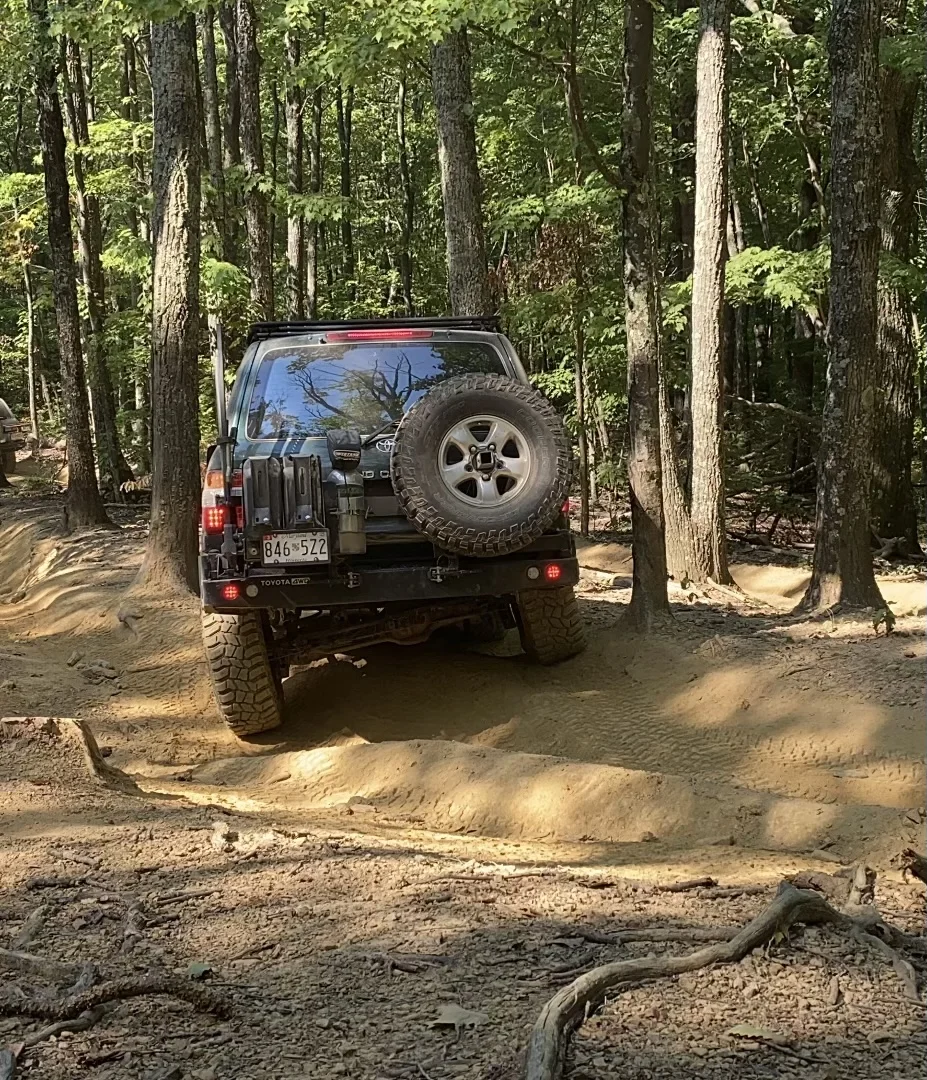

Are you able to have the wheel mount in place or does it cause a clearance issue? Nice set up BTW I have the same color. I'm kicking around the idea of color matching the bumpers to the molding. Have you seen that done?

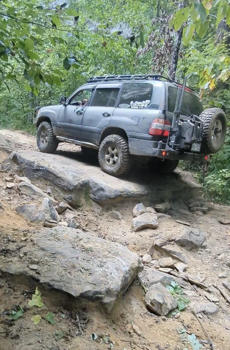

Dobinson - I have had one for about 5 years now and the main reason for purchasing was of course the price (at the time of purchase i believe it was about 1500.00 shipped to my door) . I've put this thing through hell and it has taken the abuse and keeps coming back for more. I've dragged it over rocks, come down off ledges right on to it, backed it into a tree lol. Its a very stout bumper for the price and comes powder coated with the swing outs and all the lights.
Is it bulky? - Yes
Is it strong - Yes
Does it have the best departure angle? - No
Is it by far the best bang for your buck? - Absolutely!
PROS :
cheap
durable (for what it is) are there stronger ones? - of course but no where near this price point
build quality - I've found for the price the built quality is very good
comes powder coated - and the quality of the powder is good as well
comes with both swingouts and all the lights
No cut design, direct bolt on
CONS :
bulky
poor departure angle
no integrated tow hitch ( @Hoserock designed to be used with an OEM hitch) i don't tow anything so this wasn't a problem for me
If you want protection, tire carrier and to add some accessories, this will fit the bill perfectly, If I was wheeling the Rubicon every weekend I probably would have gotten something with more clearance. We run some pretty difficult trails here and its been great. Also some might not agree with me but I particularly don't think its the worst looking bumper out there and overall it fits the big wagon well. With all that said I would buy another one for the price, you cant beat it :beer:
