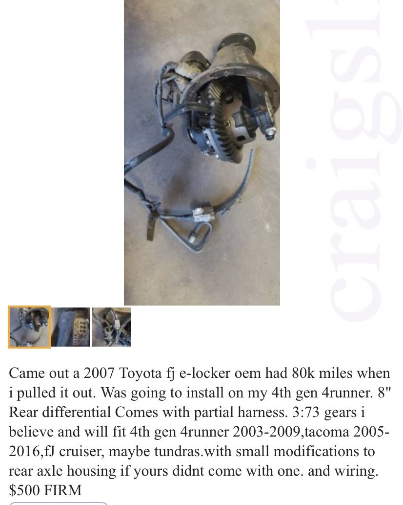

Thanks for the replies. I understand (now) that simply adding a locker won’t strengthen the axle, but what about capability? This e locker will allegedly improve capability in certain situations? It sounds like maybe it is worth the $500 the guy is asking.

For $500 plus $10 for a gasket (to template where to cut) $15 for a drill bit and tap and about $10 for the 8x111mm 1.25 studs and flange bolts and $45 for a solid pinion spacer, you have the parts to install the 3rd. Dont forget new gear oil... Follow some of the DIYs online and fab yourself a wiring harness and for under $650 you improved your truck.
I'd argue for $650 and an afternoon's worth of work, there isn't much else you can do to your truck in that price range that will give you the same return on investment.
