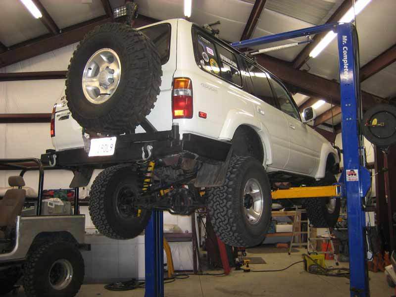

Not the best photo, but here's a picture of my '93 with a semi-float rear axle. You can see the diff studs on the diff cover. This was the night I installed an Aussie locker in the rear diff and I know we didn't have to pull the third member out.
driveline5 by Adam Tolman, on Flickr
My '95 with full float does not have a bolt on diff cover.
