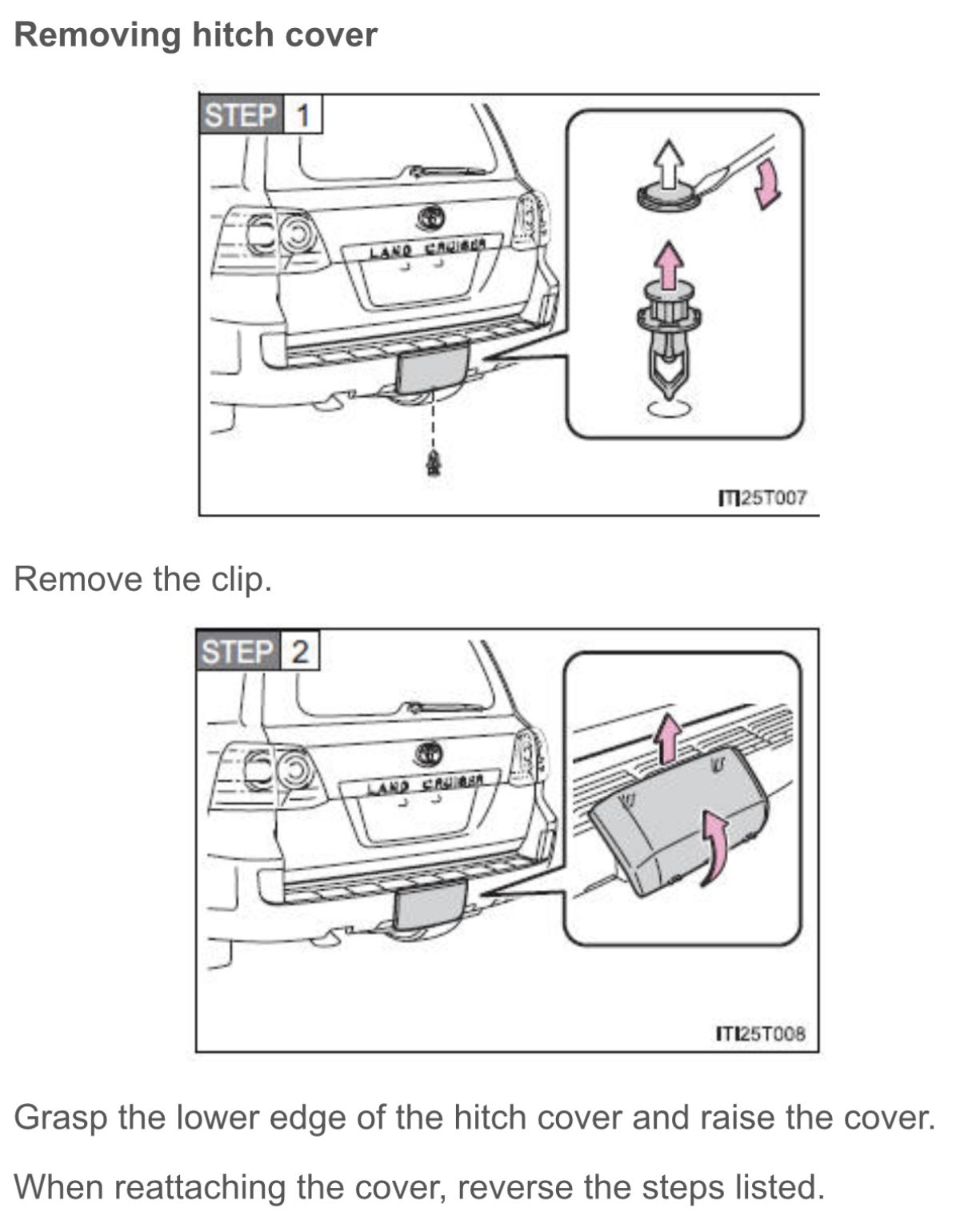

How do you get the hitch cover off, I tried prying off the clip the holds it in with a key, but it just bends the plastic tip. Am I doing something stupid? How did everyone else there's off?
1987119
Did you see the second part of the graphic?
See below...
Give it a strong pull from lower edge.
:cheers:

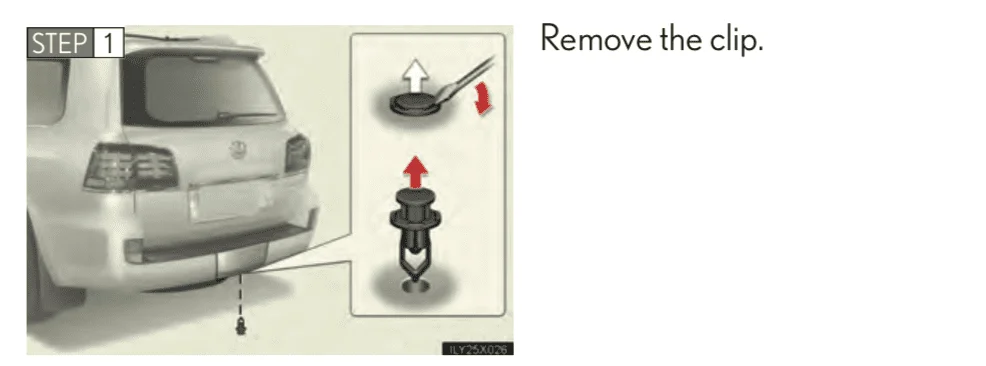

I never bothered to do step 2, because i couldn't get the clip out in the 1st step, all I did was bend the plastic, it never came out like the pic:

What do you use to pry it out like that?
Thin flat-head screw driver.
Don’t pry under the whole pin. Just pop up the middle a bit...then pull entire pin.
The middle pin doesn’t need to actually come OUT...just UP enough to allow the lowerpart of the clip to contract so it’s barbs clear the edge and pops out together with the inner pin.
See the top graphic.
A thin screw-driver or knife blade is wedging under the middle “pin” portion of the clip. Not under the outer edge...but the edge of the smaller, inner pin edge.
PS.
It’s not such a dumb question. :)
You’ve either dealt with these clips...or you haven’t... And until you see it’s structure, it can be confusing...especially since some other clips on your truck require pushing the pin IN to release...and still other clips have no pin at all.
Personally I think evil clip-makers devise new ways to confuse... ;)

Does this look right to you
It's for 2019, but the clip looks the same. I could never get it to come down :(
I'll give it a go tomorrow, thanks for your help.
Yep.
The LC cover in the graphic may be a bit different than the cover in your video and on your LX...but the clip function should be the same.
