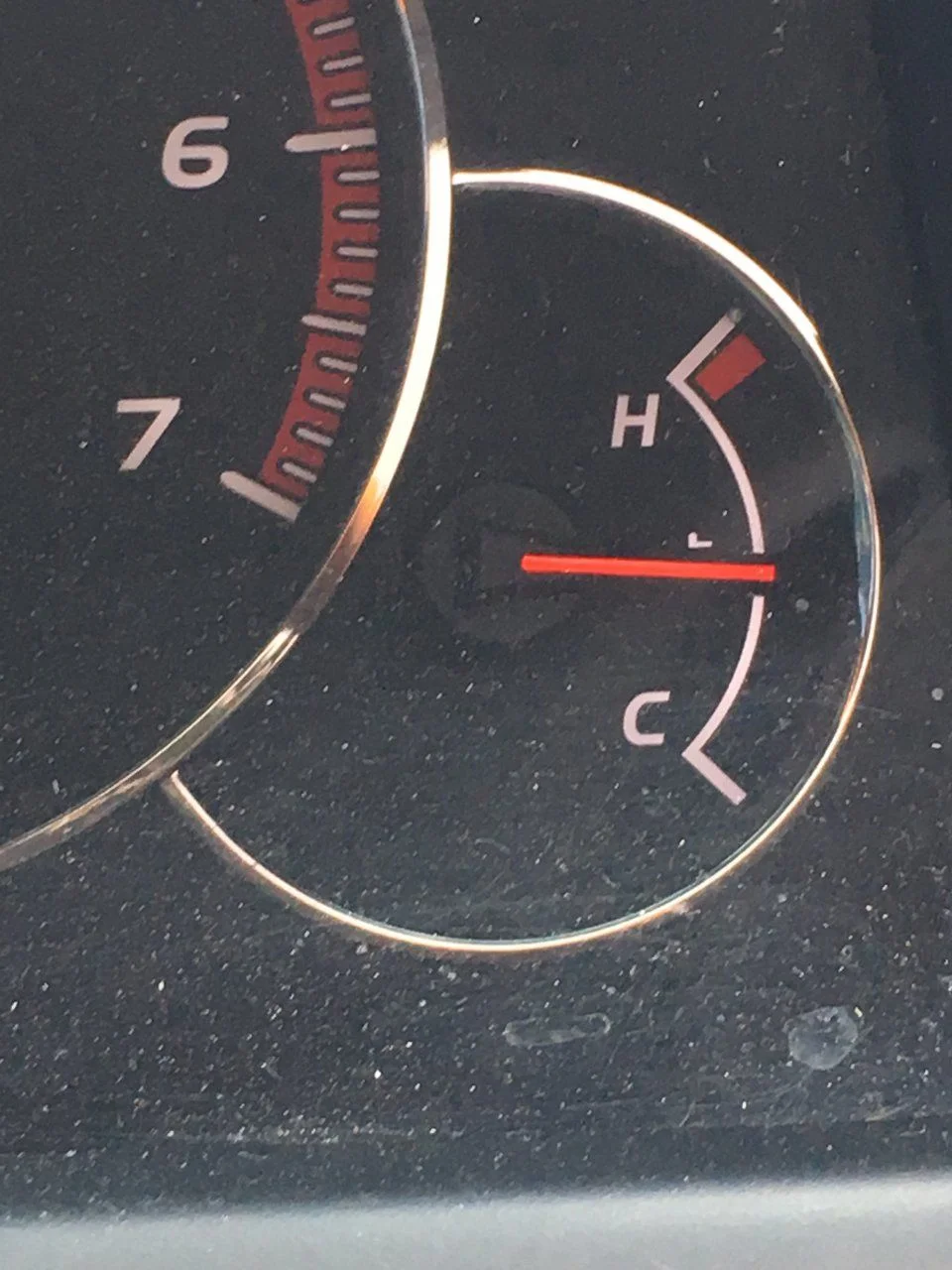

Well gentlemen I was able to get it home yesterday without any more overheating. The shop in Del Norte did a pretty good job besides the coolant level being a little off but as Coops2k mentioned it might have just been an air pocket that needed to be burped. I drove 12 hours with the gauge consistently at this level. It seems a needle width higher than I had in the past but it didnt budge the whole trip so I feel pretty confident that the issue is resolved.
Side note - I am glad that I had the radiator flushed independently and then turned upside down and flushed because the "gasket" that my father in-law said fell into the radiator was actually the bottom rubber stopper that had fallen into the radiator. If you have the time and feel like taking a look at the radiator cap it is the black rubber stopper on the bottom of the cap. :bang::bang::bang::bang:

Good to hear! My temp gauge is always right there. Never had any issues with overheating. I think that needle location is normal.
Get yourself an Ultra Gauge if you really want to be neurotic about temps. It is lit up in front of you at all times and actually moves as opposed to that needle.
My temps are always at 195 once fully warmed up. And then you will see it go up to 199 on any slight grade on the freeway . I think the highest I have seen it go was 205 in Baja with the AC going on a very warm day while doing 75 up a grade.
I really taxed the cooling system that trip with a toddler sleeping and dealing with fevers I left the truck parked for about 20 min with the AC kicking while everyone was stopped at Coco's corner for a beer break.
