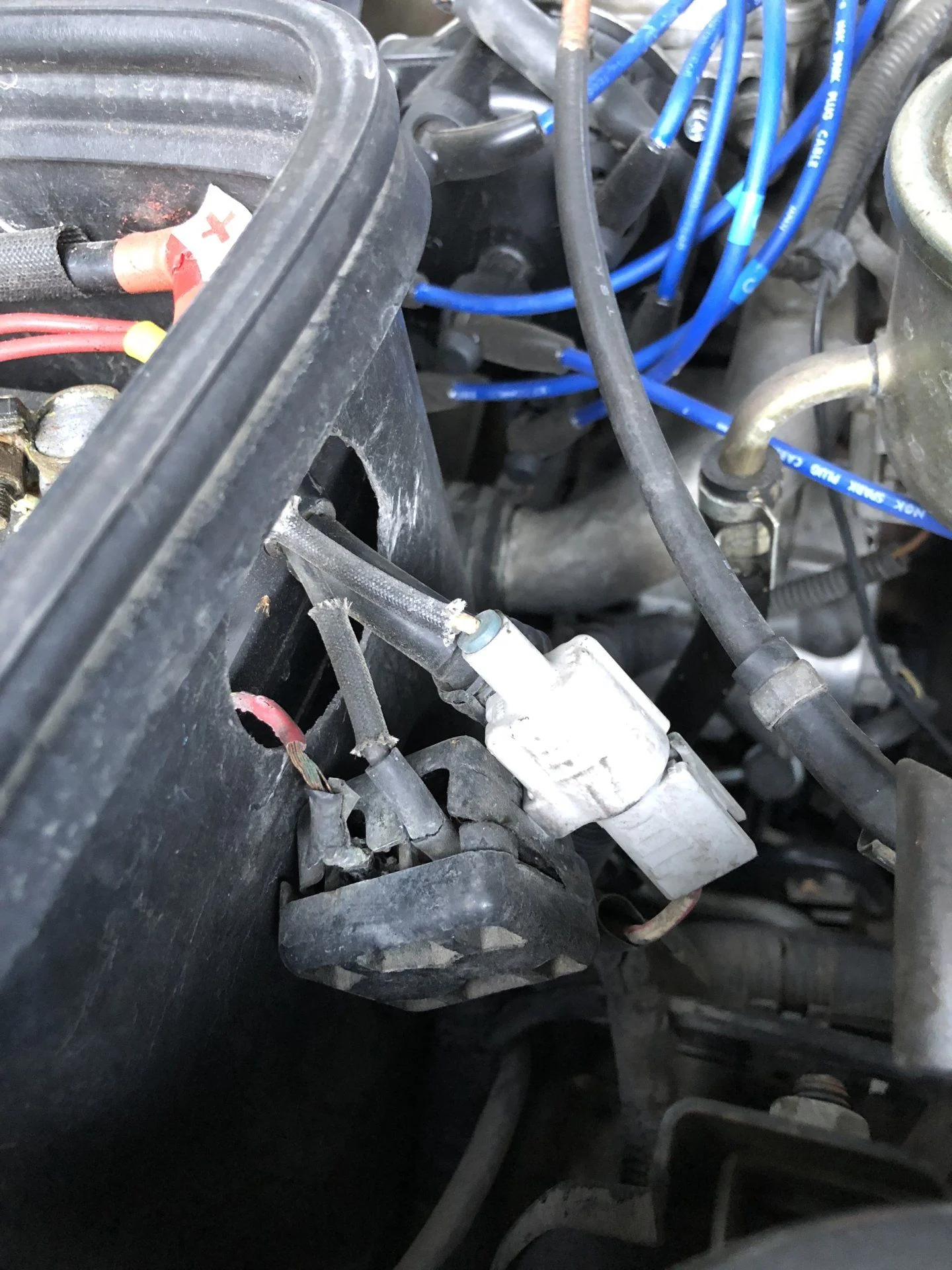

No. There is a set of fusible links attached to the positive battery terminal that control all of the circuits to the truck to protect them if there is a failure of something to keep from burning the truck to the ground. When they get old and brittle, they start to crack and fail. It is Toyota P/N 90982-08264
Look for the black box shown in the picture attached.

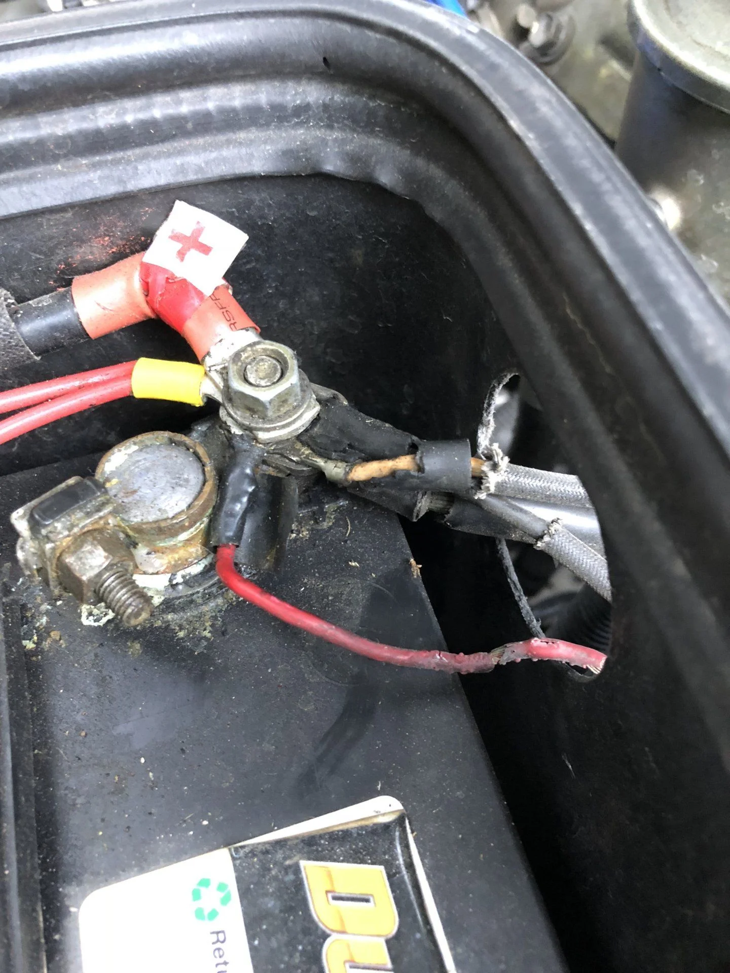

I can see your problem right there on the RED wire. The insulation is melted and everything is VERY crunchy!
Go buy TWO sets so one goes in the glove box and one gets installed!

PN 90982-08264 looks like it doesn't replace that red wire that's almost bare. Do you know which PN the red wire is?
Red wire doesn't look factory to me?
Not on my 97.
The red looks li ke some auxillary business not part of the fusible link but not sure. Checking my truck now
That red wire is something someone (PO) cobbled in there and removed the "fusible" part of the link because they probable smoked it. You're lucky the truck hasn't burned down....
The CORRECT color for that wire is BLUE.

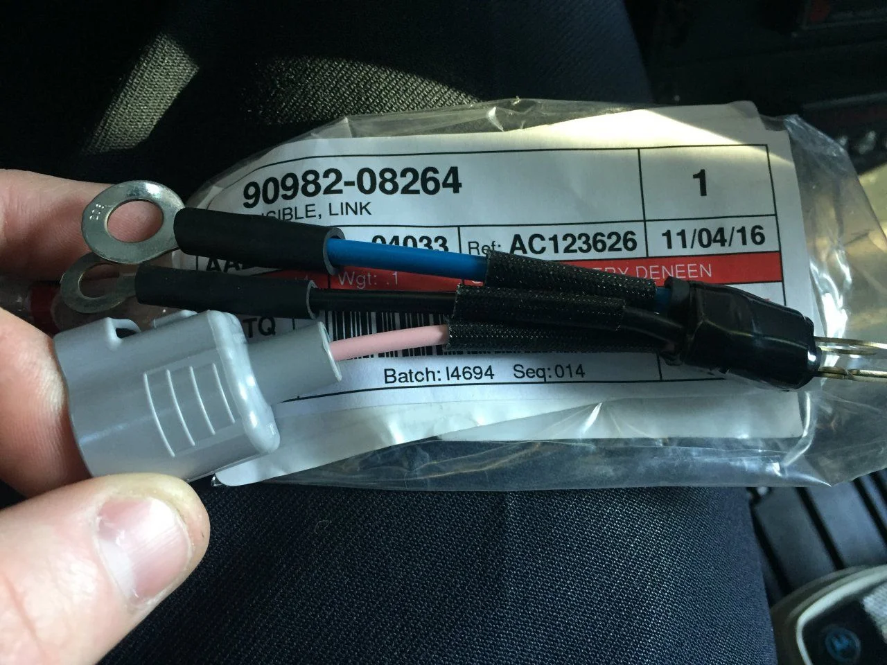

Yeah, the fuse link is 3 wires, black blue pink.
