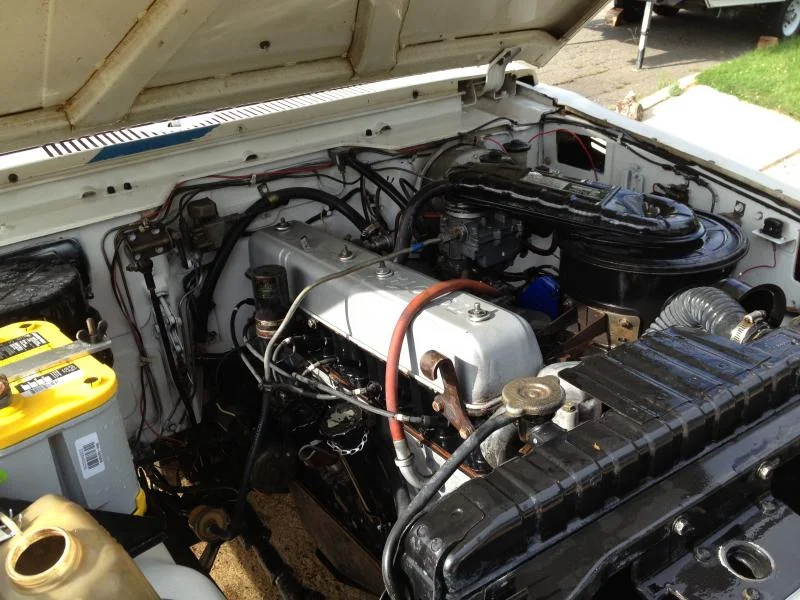

I just wanted to say thanks for all the advice and ideas. But i have taken my project in another direction all together.
Well after digging thought the internet for motor a Mercedes Benz Diesel ended up in my garage.:bounce2:
I am glad to say I have made great progress on the swap. And because everyone likes pics.
Great Idea
That Diesel will provide some low end grunt power and hopefully won't take out the axles.
Yes! So much better. Om617? A friend of mine swapped one into his tacoma.
Yes the motor is om617 out of a 1985 Mercedes Benz.
Does anyone know any info on wiring or more or less getting the Mercedes alternator to play nice with the Fj55 Wiring harness?
I've got the merc alternator wired in but haven't tested yet… I ran it to the + terminal of the ammeter gauge then from the - to the battery. Should be the right flow for measuring current… bench tested the gauge at least. It sounded good at the time after overhauling the entire harness
