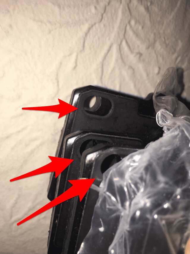

Perhaps my terminology was unfortunate... Red arrows point to what I am talking about. The squealer (green arrow) is not attached to this piece of metal.

Are they detached or still firmly attached, but mis-aligned? Could just drill out the shim so that your pin fits through properly. Again, that shim isn't necessary for the operation of the pad, just there to reduce noise (as apposed to the gizmo you aptly described as the "squealer" :) )

Define “firmly.” :) One set still attached, one peeled off with fingers, which makes me think superfirm attachment is not critical.
Drilling out holes won’t leave much metal at some of the corners, might leave none at all (does that matter?)—so thought I’d ask about regluing in proper position.
Then I would rip them off completely and leave it that way. There isn't any adhesive I know of that will survive the temperatures those will endure. My uneducated hillbilly opinion :hillbilly:
