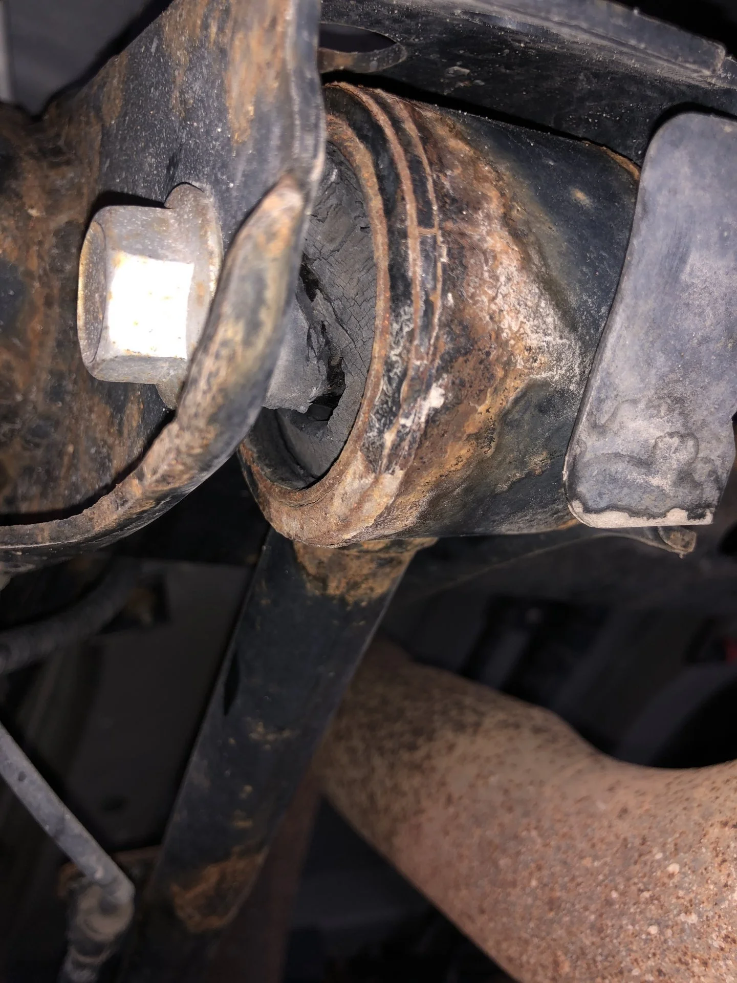

Just an update, I had the sway bar end links replaced, checked the brake components, and made sure nothing was loose underneath. The rattle persisted. I checked the bushings and yep, they look pretty bad. This will be the next thing I tackle, as I'm thinking they are the most likely culprit.
That doesn't even deserve to be called a bushing anymore. It's just a trashed piece of old rubber.
Haha, yeah… they’re pretty bad!! Should be fun 🙄
Nice to be able to see an issue and I bet you will have some nice ride and noise improvements once those are replaced. Also made me realize mine aren't that bad after seeing yours =]

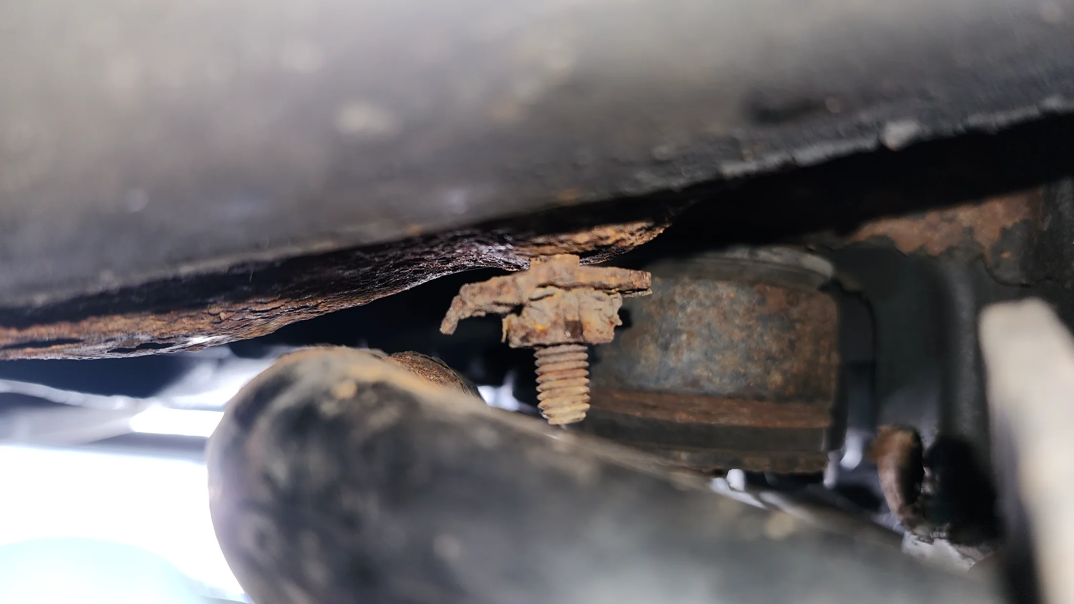

I have been dealing with a front end rattle for a bit now, didn't sound like something clunking or major. Finally found that my Sway bar bushing bracket had completely rusted and snapped off! The one that sits under the AC line. The bolt is just hanging onto the nut and rattling. Now to figure out how to get that out with minimal access.
