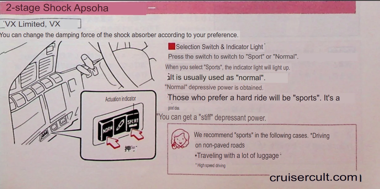

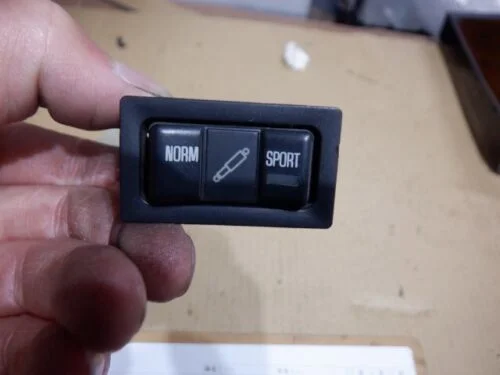

- I just bought a JDM 80 series and I cannot figure out how this works

Mine lit up with a green light in sport mode until I installed OME shocks. When it “worked” I honestly couldn’t tell a difference between normal and sport but my shocks were old I suppose
