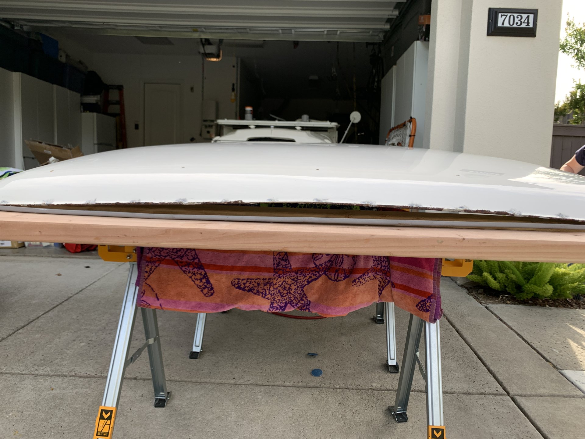

Not sure how to approach this. The front of my top always had a strange peak. Now that it's all taken apart, I want to have the front profile flat, or close to it. Here's the issue, when I try to bring the visor and top together, it takes a good amount of force to get them together and it goes back to that darn peak again!
I think this might be a job for a fiberglass expert. Any ideas?
I would agree fiberglass work is needed from the looks of it. I would think you could do the work yourself. Watch some YouTube videos. Fiberglass work is not hard, just nasty.

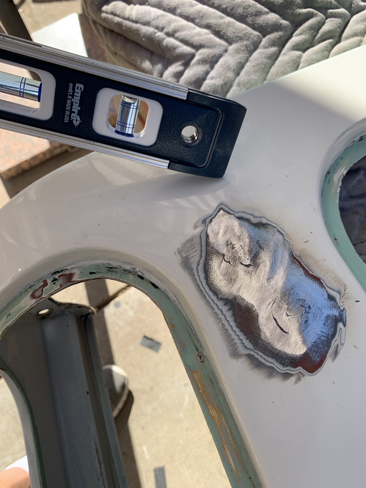

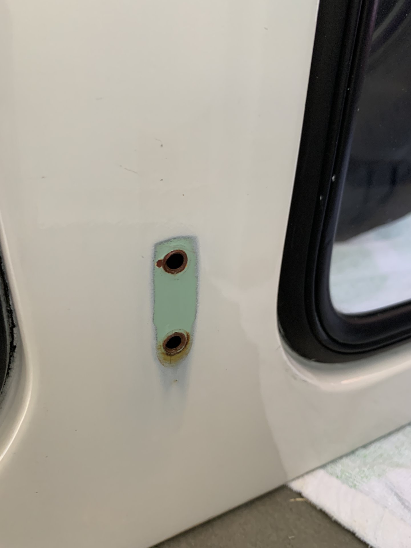

I had these holes filled/welded the other day. I want to start working body work but had a question. It appears there is a little bump right between the top of the rear corner glass and side glass. Was this there before or did the heat from the welder and grinder cause the bump? I can knock it down into shape and use some body filler to make it look pretty. Just not sure if there was a bump there before I had it fixed.

yeah I would guess you have a little warpage from the welding. If it's not too noticeable I would almost leave it. If you're going for show quality, then probably going to want to fill and fix.

My money is on whatever was bolted to those holes bent the sheet metal around it, looks like it was torqued on and made a high spot at the mounting area...
That "hump" is supposed to be there. I think if you flatten it out, you'll have water sitting there.

Also, regarding the hard top side- It definitely looks like weld warpage to me. Whoever welded that up didn't hammer the welds out as they went and/or put too much heat in the panel. The hammering is important, because when the weld filler goes on, it's in an expanded (molten) state. As it cools, it shrinks, pulling the panel in and causing shrinkage. To be fair, it's also possible that whoever drilled those holes also over-tighted the bolts that went in there. That section of the hrd top side is double-walled, so if they used bolts that passed through to nuts on the inside, it's very possible that the bolts were over-tightened and dimpled the sheet metal.
But if you paint over it as is, it's going to look pretty bad. Hard to tell from the picture- if the low spot is less than 1/8" low, then you can get away with just using body filler. If not, you'll want to try to pull it out somehow before body filler.

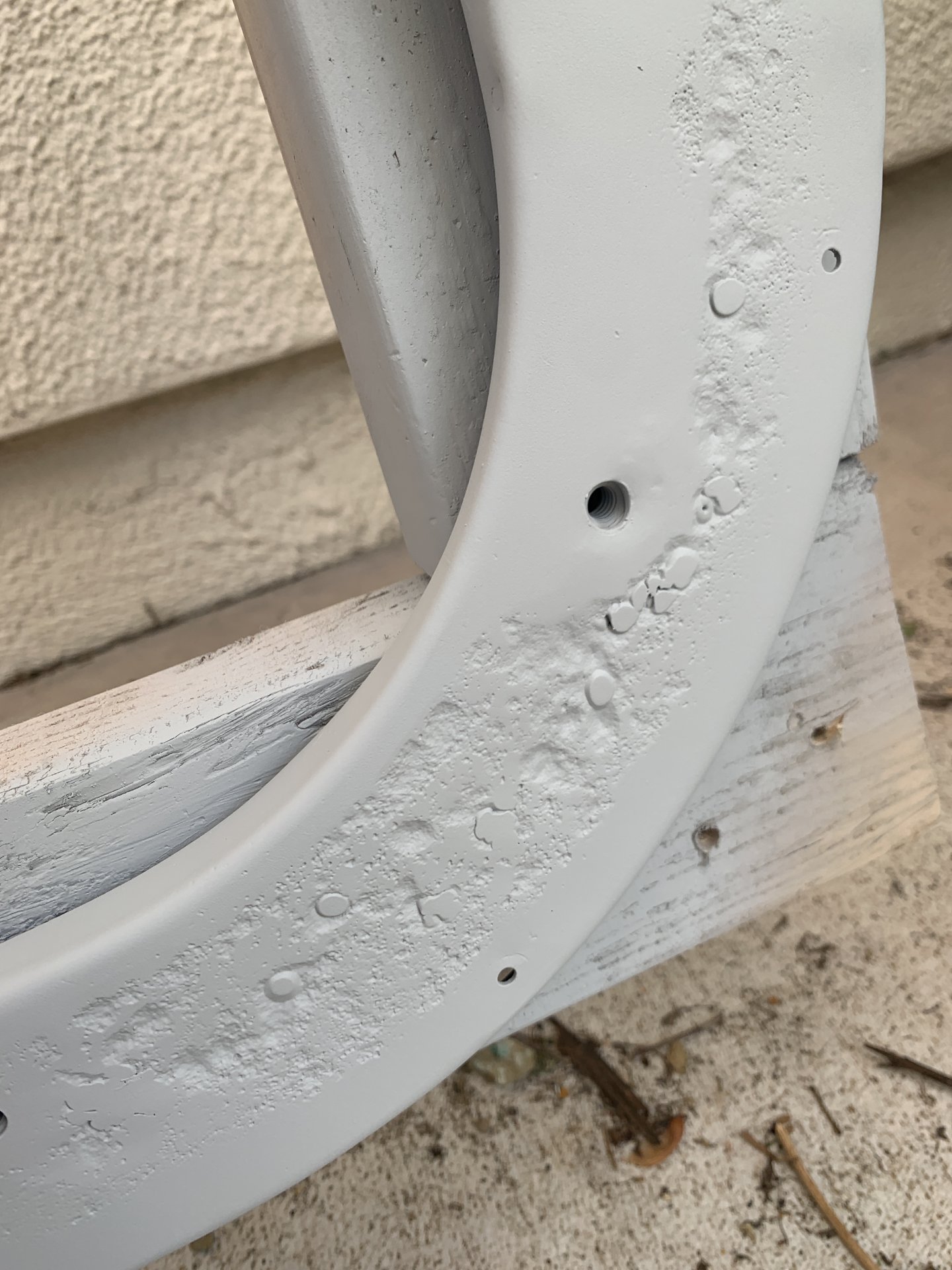

The gutter is just about ready to go and I am going to begin the fiberglass. Well, let me take that back, I am passing it to someone who can shape the fiberglass, put it all back together, and then paint it. I don't have the fiberglass skill to do this right so I called a boat shop.

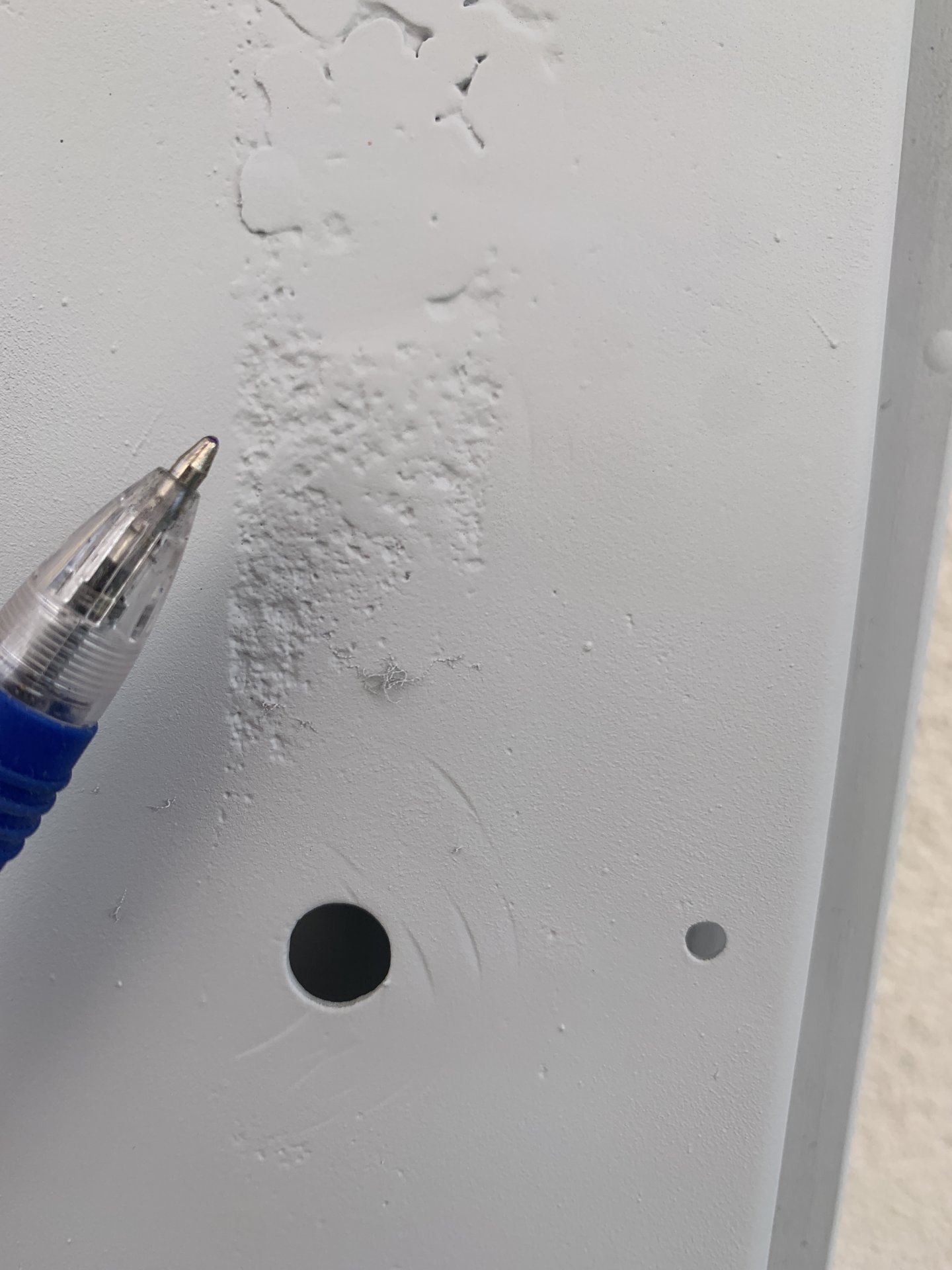

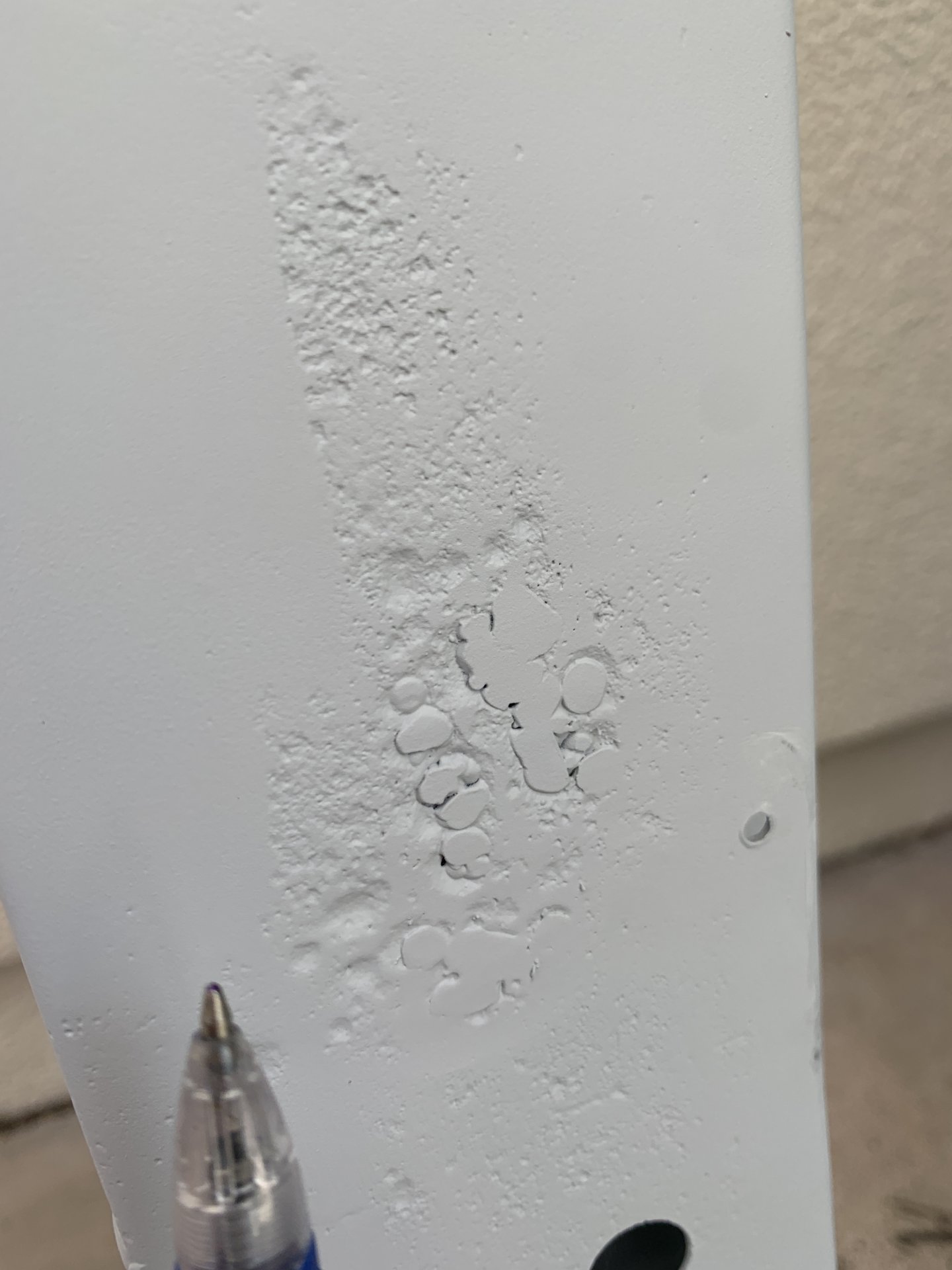

Finished up the epoxy primer today. On the bottom of the gutter where it meets the weatherstrip seal, there are some small pits from where the rust once lived. Should I fill these with bondo or something thinner like a puffy that still uses a hardener?

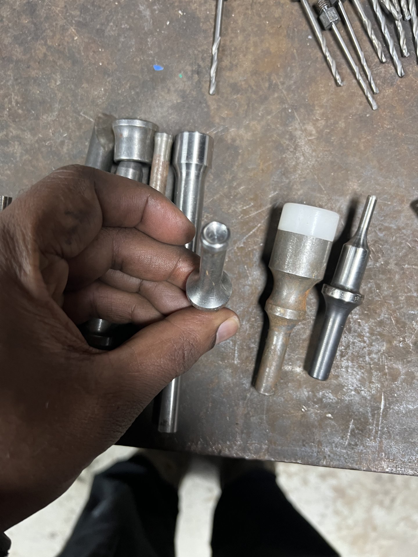

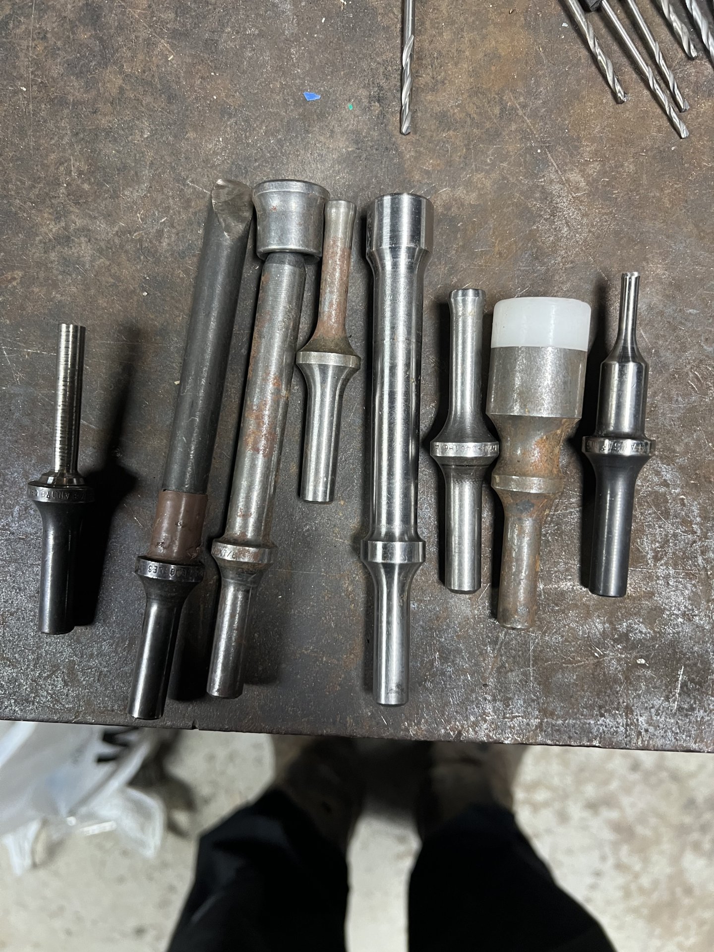

Thought I would share. The aircraft industry has perfected rivets. Look up aircraft rivet tools. The river shaver cuts the cap of rivets without damaging the fiberglass top. Rivet squeezing tools using air tools work well.
