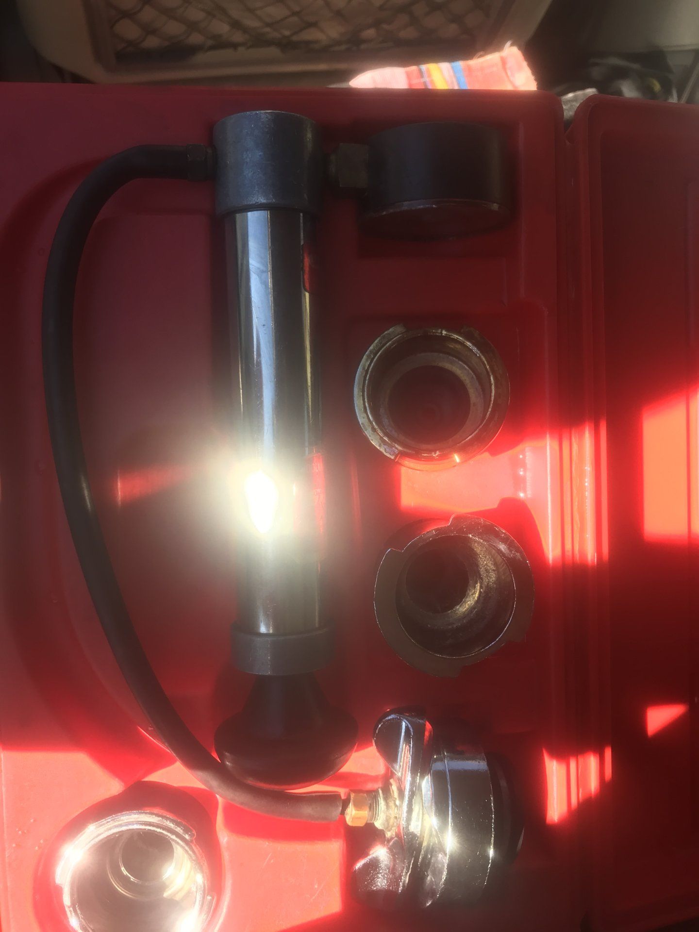

i just pressure tested my radiator with a snap on loaner from a local toyota tech.

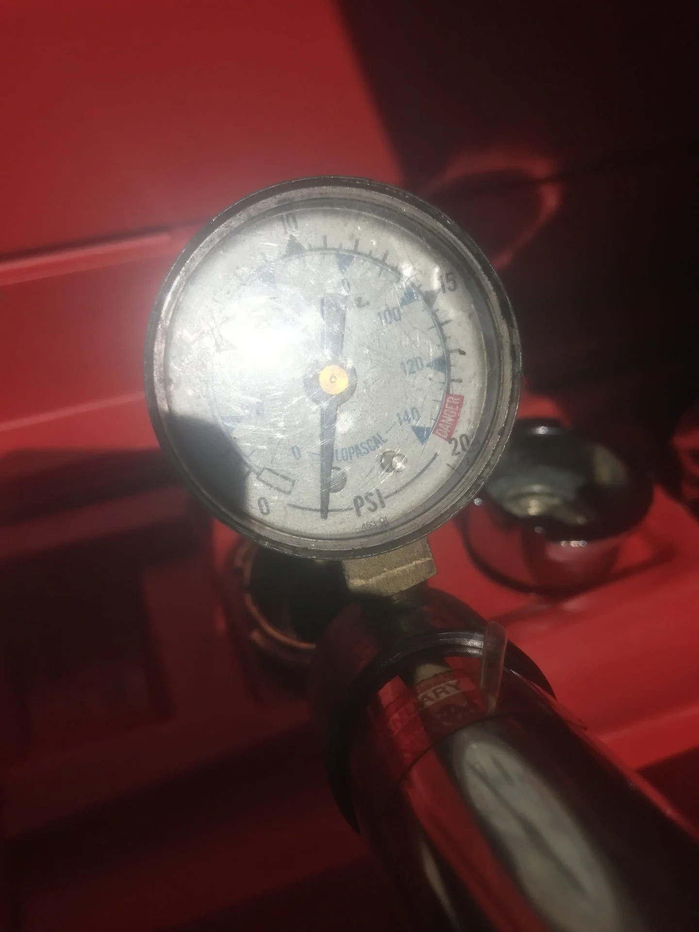

as i recall instructions were heater to ON position, verify the heater control valve is fully to the left/DS (i double checked it). and then 17 PSI and see if it holds.
i’m used to motorcycle tires and i didn’t get much pressure on it but before i continued i checked the gauge it appeared to be up at 80 PSI so i stopped. quickly. i see now i was at kilopascals which is roughly 12 PSI which held fine.
two questions.
1. i had to /file/ some of the vertical edge surface of the cap off (seems fine since it seals at the interior) but it was still a super, super tight fit so i am a bit sketched about doing it again since i don’t want to bust the flange. i don’t know why the flange on my radiator is so damn tight. but i’m wondering if i need to retest. in which case i will probably take a little more off the flange.
2. i had a whole lotta coolant spurt out of the adapter when i pulled the pressure tester off of it. it /appears/ to have come out of the overflow reservoir. what is going on here? do i need to let it sit 20 minutes to let it flow back to the reservoir? should i have a pressure release on the gauge (doh!)?
someone mind clarifying the physics for me so i know how to do it properly next time?
honestly i was so focused on being gentle with that flange i didn’t quite catch what was what.
THANKS

thanks man. i worked it for a week. no way the adapters (the correct ones) would fit. just some crazy oversizing on the radiator flange. i had to take like 1mm off the diameter with a file. then it barely fits.
so 12 PSI and no pressure drop is not enough and i need to see 14/15 i guess and can i just see that it HOLDS the PSI?

Not sure what your goal is, but if it holds 12psi, it doesn't have a leak, is likely to hold 15psi. If there is air in the system, some liquid can be pushed out when the pressure is released.

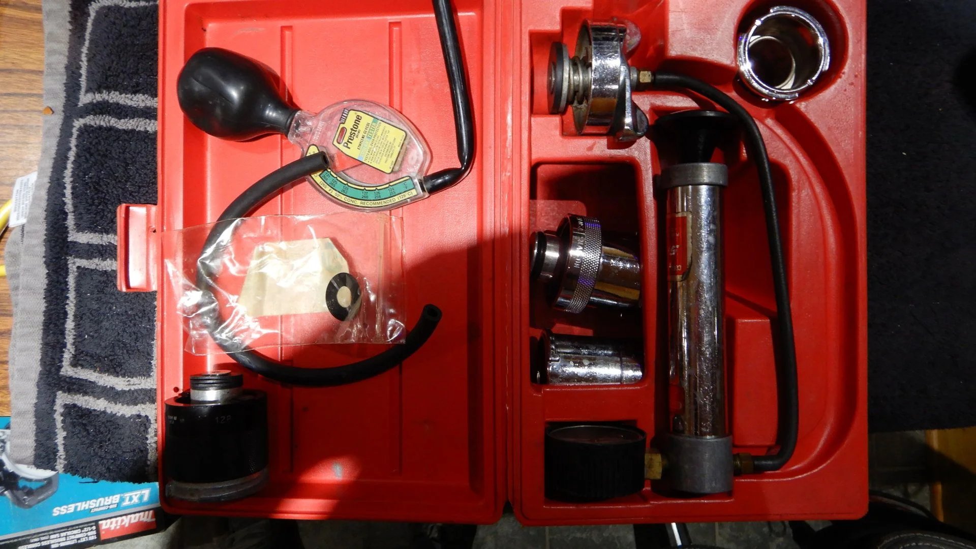

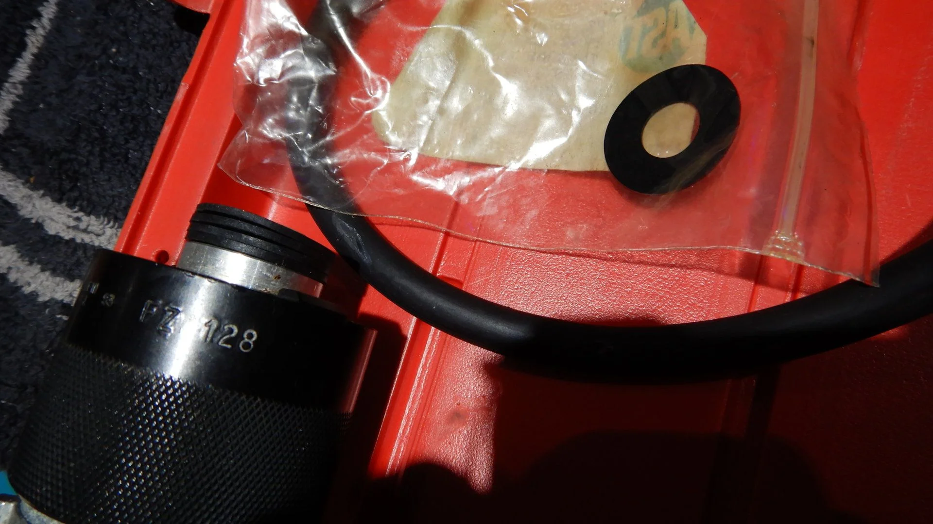

did your adapter come with a variety pack of thickness size rubber gaskets like shims ? gaskets
yeah. the plastic (or whatever it is) flange is just like 1+mm oversized on the OD. kinda crazy. just no way it would fit the OD. i had to take a file to it. if i do it again i’ll take another 0.5mm off so it won’t be so sketchy this time. still a /very/ tight fit...
like my snap-on tester has ?
my black toyota adapter is a MATCO brand
those series of rubber gaskets are like shims , and too much or many would have made life hard installing the adapter
not enough and u will have a Leak Down

I am not near an FSM and maybe someone can confirm for me, but I think the system should hold pressure up to 20-21 PSI. Definitely check before you go that high, I could be thinking of another vehicle’s spec, or I could be high.

i double checked. it is definitely the OD of the radiator flange in relation to the ID of all the adapters. the radiator cap will go on (obviously) but none of the adapters would fit over. i checked and rechecked. it was just simply too wide an OD to get the adapters over.
no one had ever heard of it. so i sat on it for like a week but i have to get this kit back. so i took about a mm off the OD and it goes over and gets down to seal. if i had to do it again i’d take off anouther 1/2 mm and not worry about ripping the flange off when getting the adapter off. it was still super sketchy getting that adapter off.
a bit bizarre but that’s what seems to be happening.
