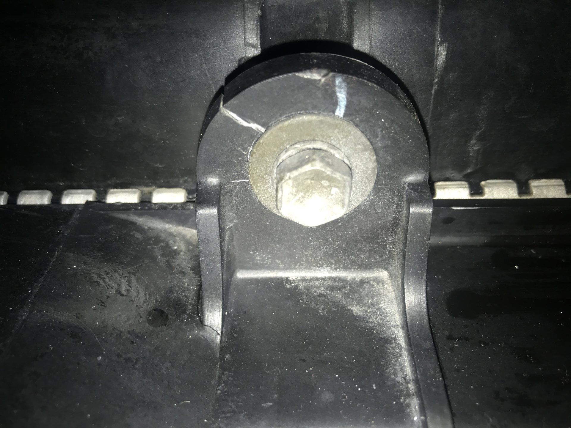

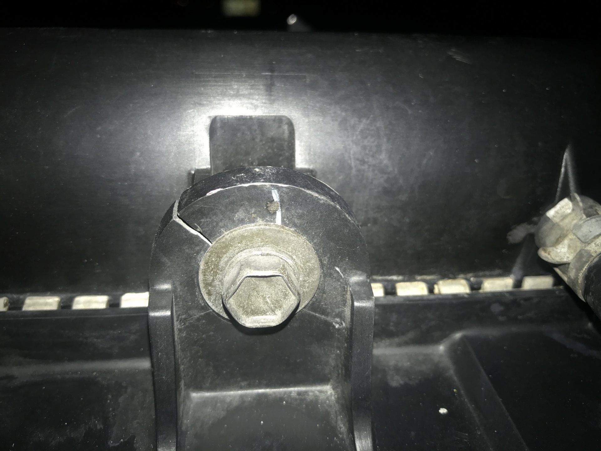

/anyway/ she has dropped to 14 then 13 and now about 45 min to an hour in it is at 9.5. i’m also seeing that both upper mounts are cracked.

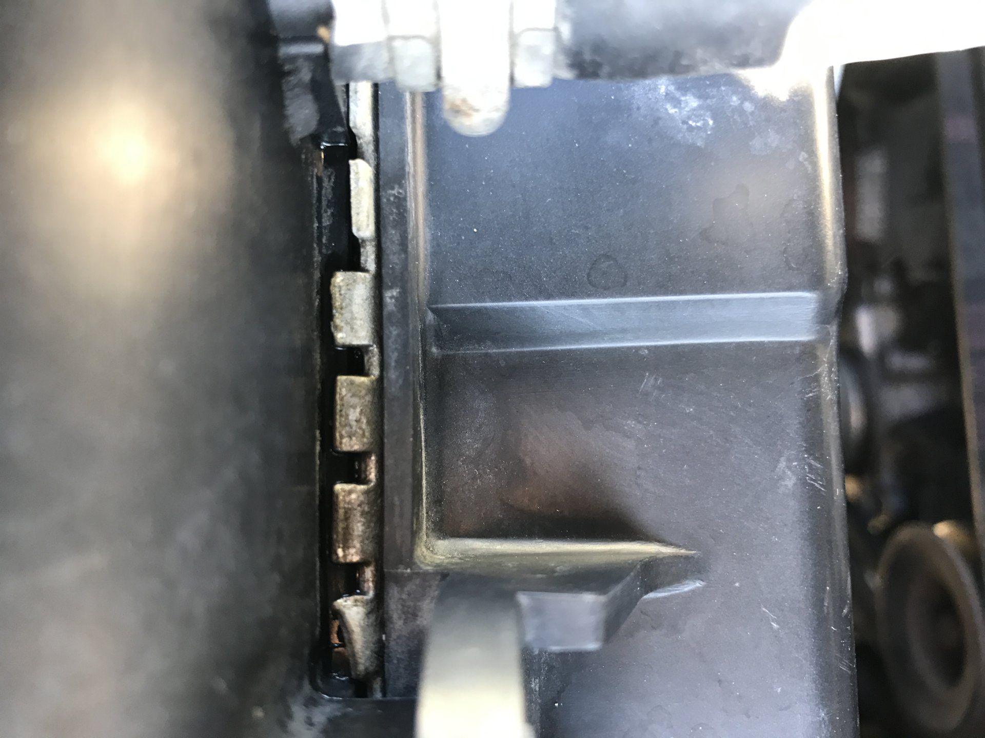

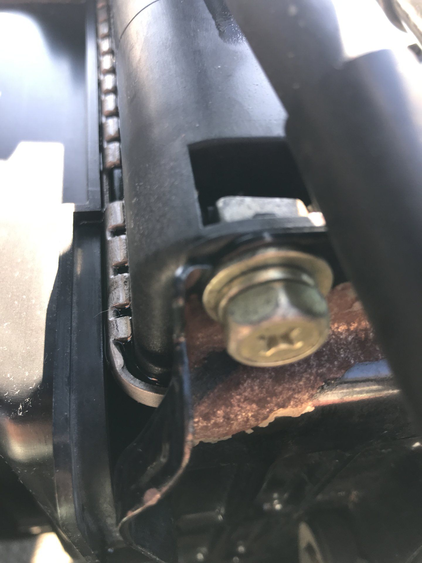

i tried scrambling all over to find a leak and did not seem to find anything. took some pics and did see some liquid but it was hard to tell if it was from originally popping the rad cap. i tried to clean everything but of course this is a bit hard to get all the nooks and crannies.

i tried super hard to clean up at the top but it is hard to know if any of the liquid at the top (super small amounts) is from a leak. similarly there was some liquid underneath but since i didn’t get under there to clean it is hard to know if it was from a leak.
