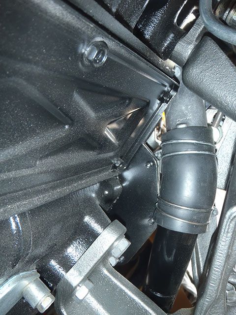

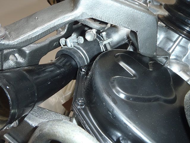

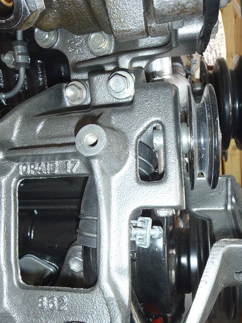

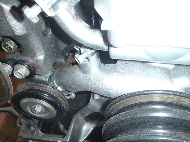

Thought it might help if you saw some "partway in" photos:

So clean!
Thanks. Because it's going into my "forever" (until I kick the bucket) FJ60 I spent a lot of time cleaning and repainting (where appropriate) every used part before going back on the newly rebuilt 3FE. After all grease and grime was removed, all surface rust was removed and parts painted with (for the most part) high temperature engine enamel, then "baked/cured" under a heat lamp for several hours. I really like the way the cast iron color turned out. After the vehicle's put back together and running again, we'll have to see how long it stays clean :-).

But it's basically just removing lwr rad hose . Letting coolant drain. Undoing the clamps to the upper rubber hose that goes to the water pump and the bolt for the metal joiner between the 2 hoses and removing.
The problem u may have is that u may need to remove the A\C pulley to get the top clamp off.
If so u have to crack the main nut first and then loosen tensioner bolt near pulley untill belt is loose enough to remove it. Along with pulley.
But have a good look before all of this to see if u have access with out having to do so.
