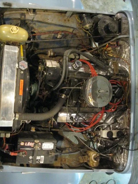

I too switched to Champion about a year ago works great with Taurus e-fan and Amazon purchased overflow. I used some rubber bushings to isolate it a bit as well as a radiator cap with a cathode. I heard about flex and electrolysis causing some havoc with these. Mine was a bit tricky due to motor position after the NV4500 addition. I have some photos of all fab work and parts used if you would like.
Bottom line, best cooling I’ve had so far.
