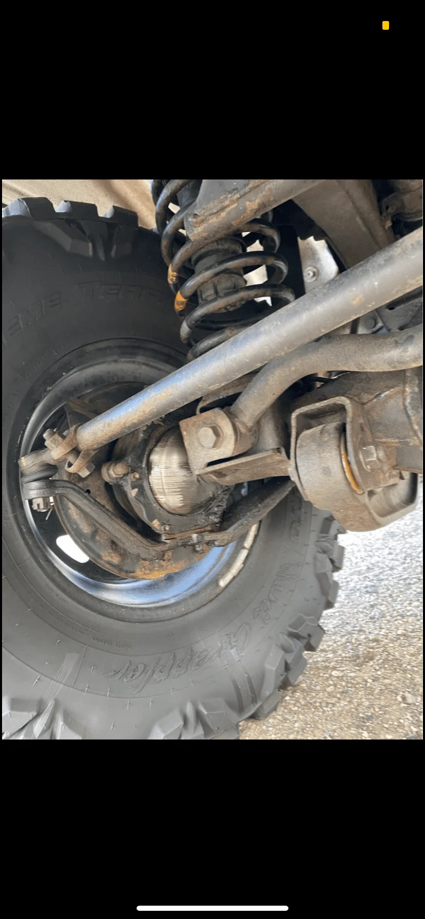

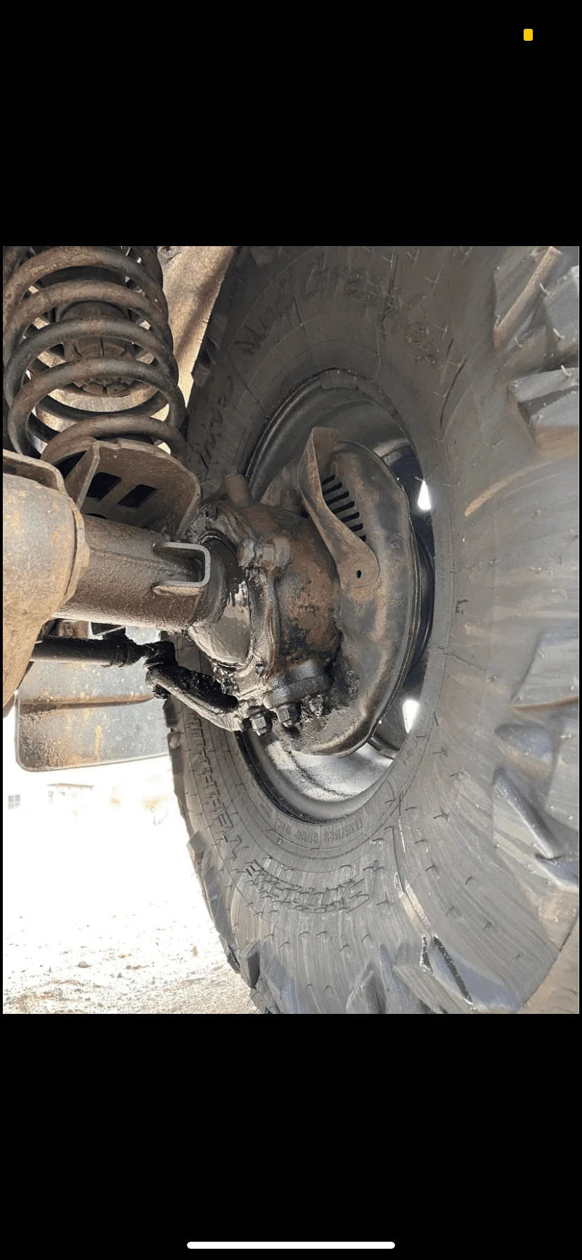

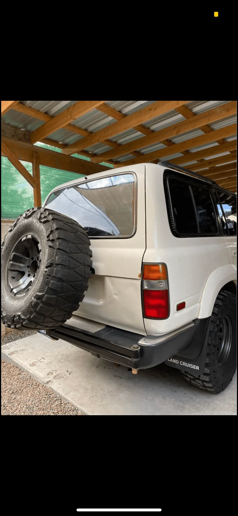

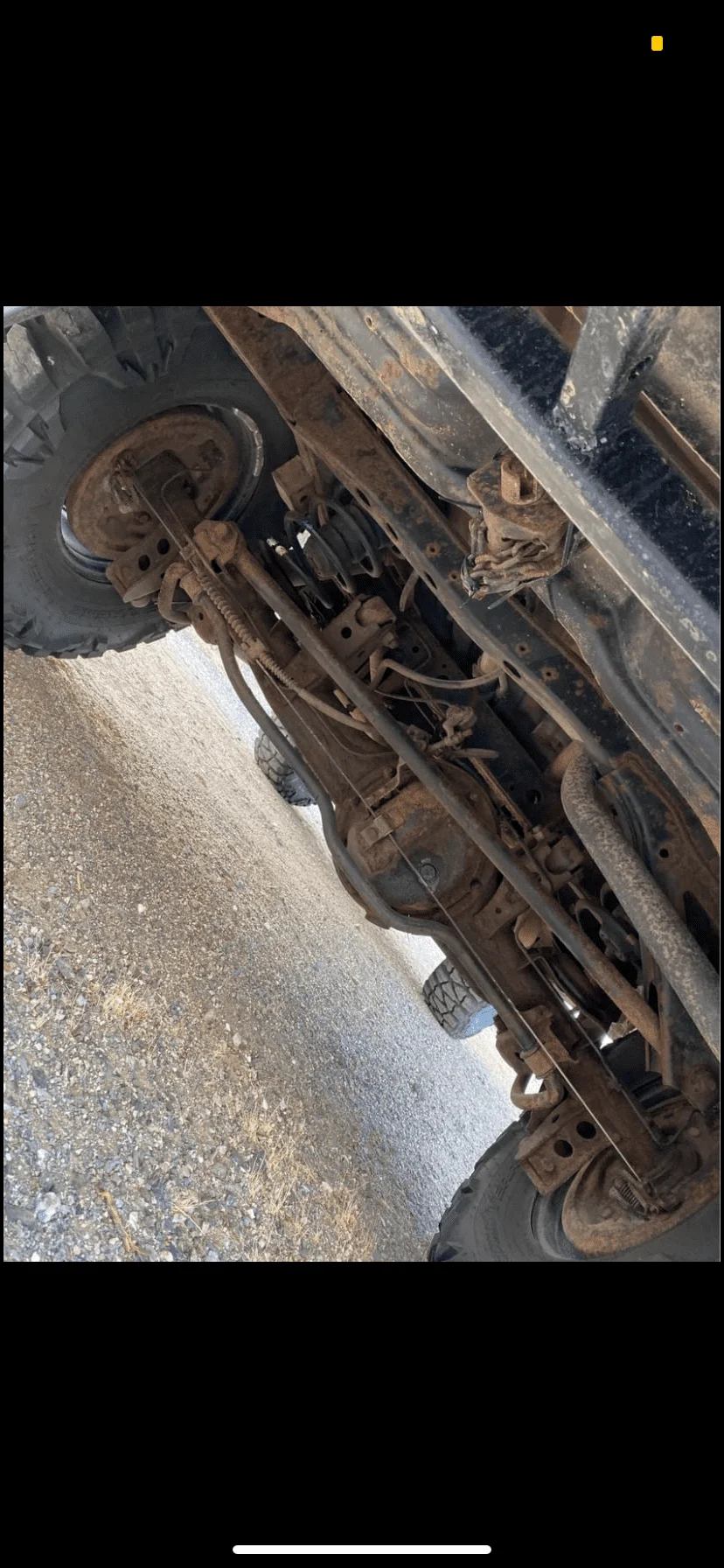

Hey y’all, I’ve been looking to get into the cruiser game for a while now and finally have a chance to actually do it. I’m looking at a specific cruiser that spent the majority of its time in Idaho and I am definitely concerned about the rust since I’ve never had to deal with it being in Southern California. I am looking for some advice on what to look for or test before I decide to pull the trigger. Thank you in advanced!!
Now onto the truck;
here is the ad copied straight from the seller:
“Great running and driving land cruiser, lifted 2 inches with spacers, castor correction bushings, new tires, center diff lock only, good a/c and heat, I believe everything works as it should expect for the rear wiper, engine light is on has code 71 which I believe is egr flow, front diffs leak, selling because I really don’t go off-road and would like to get something a little more highway friendly $6000 obo Possible part trade gx470 lx470 or 4th gen 4Runner ”
I’m not going to lie, I don’t know Jack s*** about cruisers or much about 4x4s since I’ve only built racecars and not trucks so there may be some spoon feeding needed here and for that I apologize.
The seller is asking $6k and is willing to have my buddies shop look at it for a pre-purchase inspection. Does the rust look like it could be a major issue?

The pictures show some surface rust, which doesn’t look too bad. I’d have the shop have a look at it with the rust in mind. Removing the rust and painting those surfaces can be a big job, but the pictures don’t show enough be be a huge concern. I’d want to see pictures of the frame near the middle section of the truck.
The ad makes it pretty clear maintanence hasn’t been a priority with the previous owner. Does he have records? Has the head gasket been replaced?

The pictures show some surface rust, which doesn’t look too bad. I’d have the shop have a look at it with the rust in mind. Removing the rust and painting those surfaces can be a big job, so I’d take a closer look at it. I’d want to see pictures of the frame and the middle section of the truck.
The ad makes it pretty clear maintanence has been a priority with the previous owner. Does he have records? Has the head gasket been replaced?
I appreciate the reply! And I have not asked about the head gasket since it was just this morning I learned this was around the time they start to decline or fail. I will definitely be asking that next! Thank you
