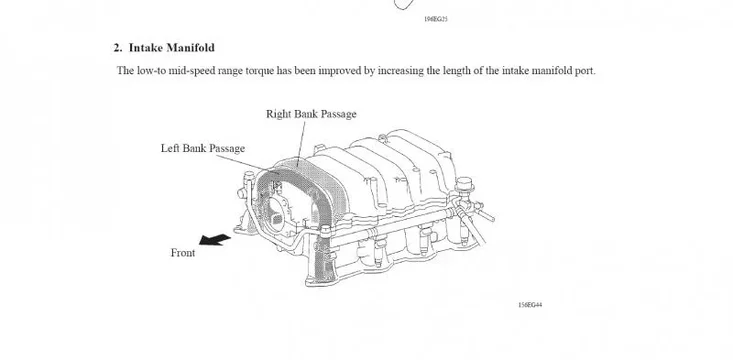

Don't know why one would change the intake manifold. If I found necessary, I'd check by looking up part number for & from specific application along with any parts attached like TB, ECT sensor & gauge.....

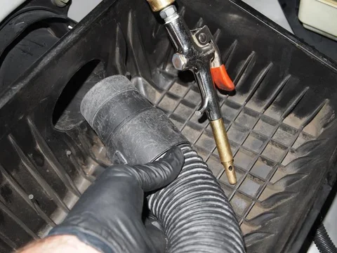

I do look at air box with fine dust discoloration, but don't find same down stream around MAF Meter. I recently tested down stream with Q-tip and happy with lack of dust or grim.

I also think the OP was referring to a intake system, not the intake manifold.
Didn't look at what afe 51-12262 is.

I've read some interesting info on K&N and do find it concerning for the oil issue and dust issues. That is why I check down stream with Q-tip and clean MAF meter, once I've burn through a couple tanks of gas after oiling filter. I really do need to get that K&N out one of these days, just based on what I've read outside of mud.

I was going to do just that some years ago and order the test kit from Blackstone. Shamefully the kit is on my shelf, I just lost interest. In part because my Q-tip's test looks so good. It was a study in; see: bob as the oil guy that first concerned me on this issue.
I tend to oil the filter heavy, and as i said; then clean MAF after some time/miles has past air through filter. Before cleaning I get out a Q-tip and retest, I've not ever seen red oil or grim on cotton tip.
