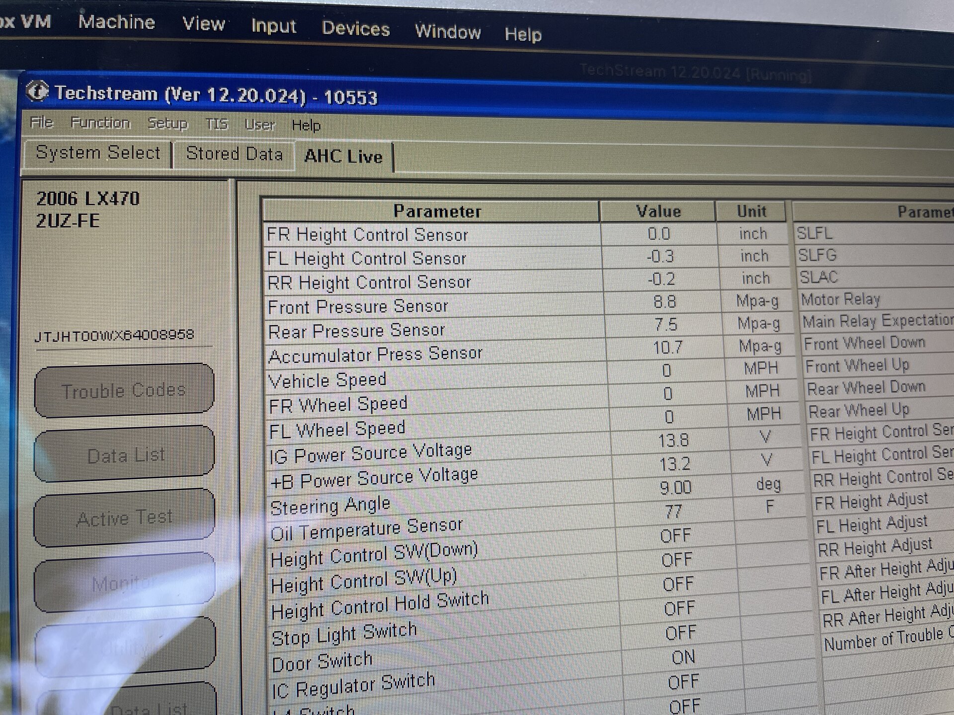

@suprarx7nut oh dear. That doesn’t look good. This is at N.
Haha, you are correct. That is not good.
Free fix though. Turn the torsion bars 9 turns on each side (clockwise as you stare up at the bolt from the ground). 30mm socket. Put the car in high to make it easier. A little WD40 or penetrating oil also helps. Do it with the car off.
That should move front pressure down into spec. Rear will likely move a hair in the right direction as well, but will likely still be high. Not a huge deal though. Do the torsion bars because it's easy and free. You can re-assess later after you get all your other stuff added.

**Also do the gradation test after you get that pressure back into spec up front. That will tell you how bad the globes really are.

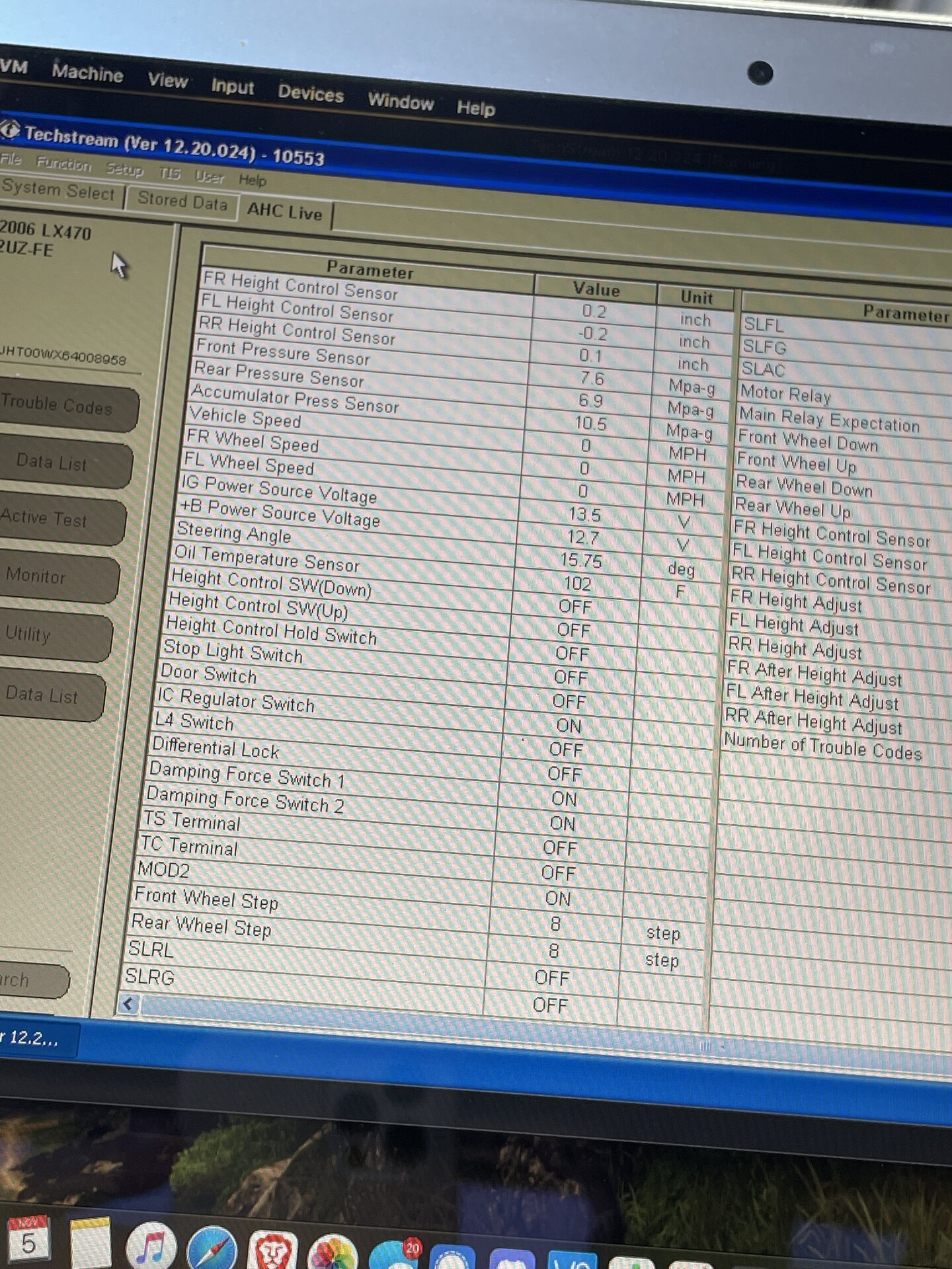

My Mac ran out of juice and I’m not really on a level surface, so I am going to turn the truck around and do it again. The second test with the way the truck is oriented in my parking lot currently was 8.2 front and 6.8 rear. I probably need new springs as this truck is unladen right now, there’s almost nothing in it besides a small box with 15lbs of items and a 20lb subwoofer box in the rear.
Looking a little better turned around:
7.6 front and 6.9 rear.
Oh, well that's not so bad at all.
That would only be 3 turns.
The average between front measurements of 7.6 and 8.2 is 7.9. The rear is what concerns me the most since it has basically no weight in the back right now and it’s reading that high.
That's how it always is. I've tested and worked with dozens of 100's in person and on here. Rear is always high like that. The springs sag and the insulators compress over time.

Ok so I shouldn’t be too concerned. I forgot there’s now a 33” BFG ko2 E rated tired underslung back there too. Most of the time I’m going to be driving this unladen so not sure if I want to go with king springs or just buy some oem springs, or perhaps go in between and get the LC-100 springs, that might be a happy medium?

I would do nothing at all.
Don't do non-ahc springs for an AHC 100 without lots of extra weight. Waaaaay too much spring.
The rear is fine. Adjust the front.

Ok, I should note too that I was unable to take the temperature sensor off because I’m a frail computer technician, so the pressures could be 0.5-1.0 less than its reading. That’s interesting and I suspect it has something to do with it accounting for fluid expansion when it gets hotter. Fluid temp was at 74f when I started and 101f when I finished.
