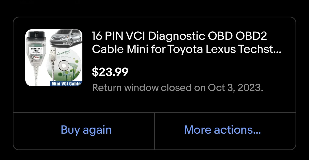

Hope I got the right cable, the links for both cables in that thread are dead links. The listing for the cable I got is dead too but here it is:

Ugh the techstream forum post is full of dead links, needs to be updated desperately
Use this cable: https://www.amazon.com/DIAGKING-Techstream-Diagnostic-Firmware-Version/dp/B07BCNPDDG?tag=ihco-20
Use the software package from post #1 in that thread. Ignore any software that comes with the cable.
Yes thanks, I found that same cable on eBay this morning. Unfortunately the links in that thread are dead and the download asks for a decryption key that I cannot locate amongst the 57 pages that thread has.
