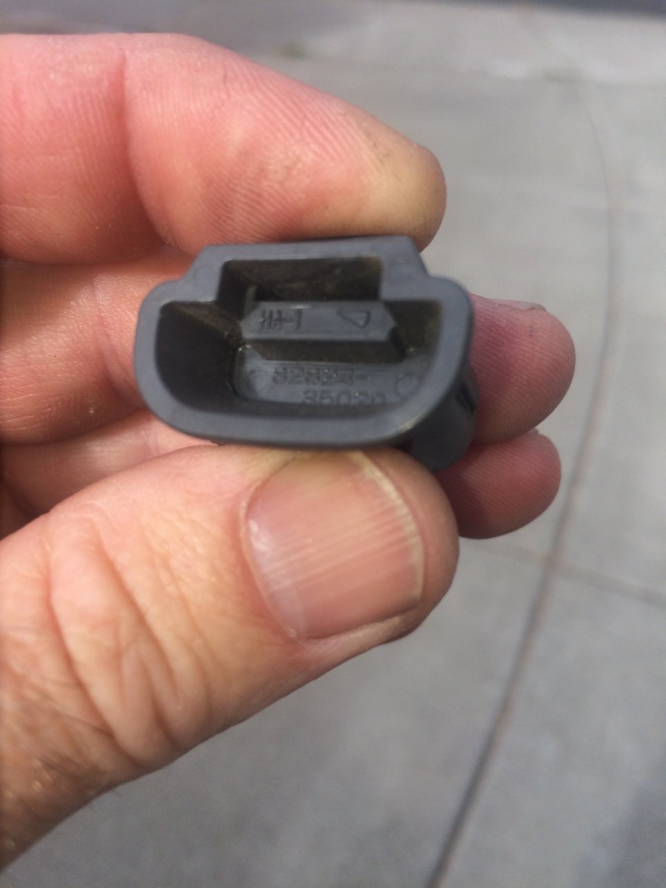

I did this exactly work like magic yanked it all without looking back and in the same time I yanked all silicon houses and replaced with OEM and green stripe and replaced the old bypass around the PAR with metal pipe from newer model
The 93-94 take a slightly different plug than the 95-97, and yes, no resistor. Luckily after hunting around for quite awhile I was able to find the correct plug for the 93-94. I only brought in five to make sure they worked and they did. I have many more on order and should be able to meet demand in about 2-3 weeks.

yes but you dont need the resistor :) i used the plug from the old temp sensor it looks OEM
Agreed, that is why I do not put the resistor in the 93-94 plug.
