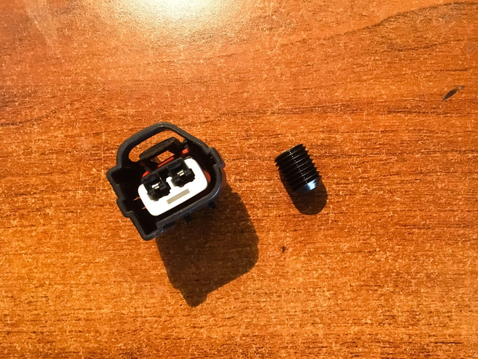

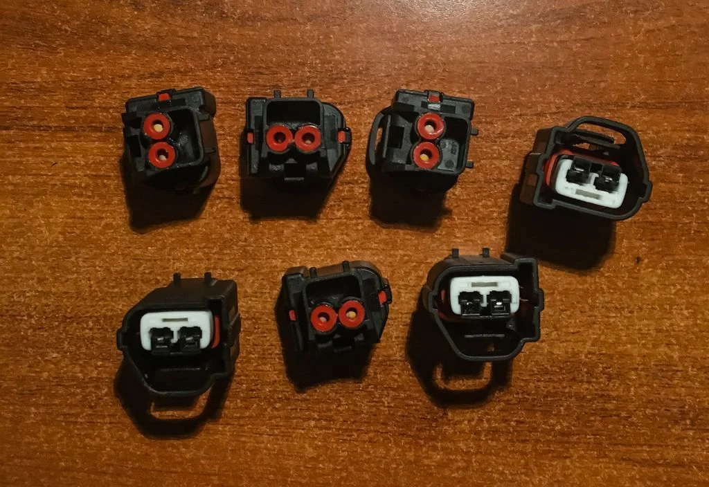

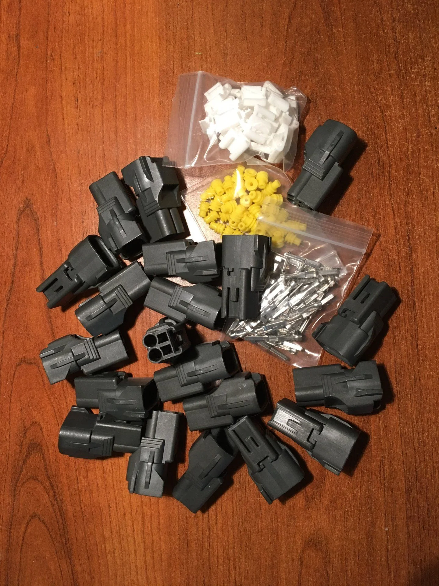

As of now, I have been building these plugs with the resistor hidden in them and it works like a charm. I have about 4000 miles on my LC with no codes and a nice cool pipe near the wiring harness. Here are a couple of pics of the part that plugs into the harness in lieu of the temp sensor electrical plug.

Still working to find some sort of alternative to the temp sensor at the intake and when I figure that out, I will post up the completed temp sensor testing harness. I figure this solution, especially for those of us that are picky about how things look, might be nice to have during our testing and diagnosis of EGR related problems like the common P0401 codes.
