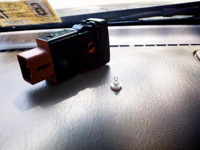

I have a bulb out in one of the quarter window switches and I am trying to figure out how to access it. Does that part of the dash come out or do I need to get in there from behind?
Are they just pried out? I don't want to damage anything...
Yes, and you should get the plastic levers for popping out dash pieces. they are $3
Should any auto store have the plastic levers?
Most yes, but call ahead. Try sears also. Or the webs your friend.
or, you can pull the black trim under the instrument cluster off and then pull the kick panel down and pop the switches out. NO prying required!
Where can I get bulbs for the switches?
