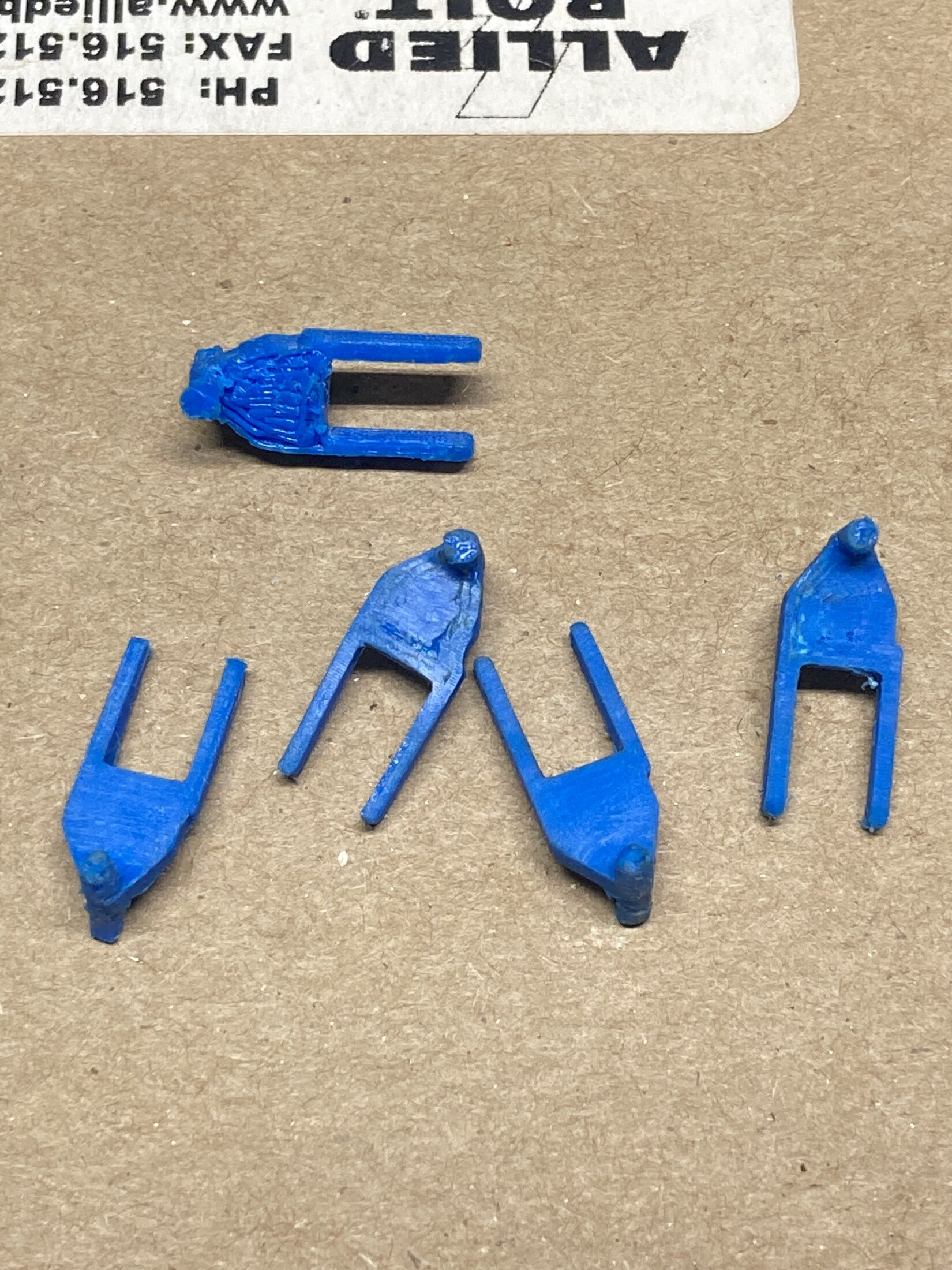

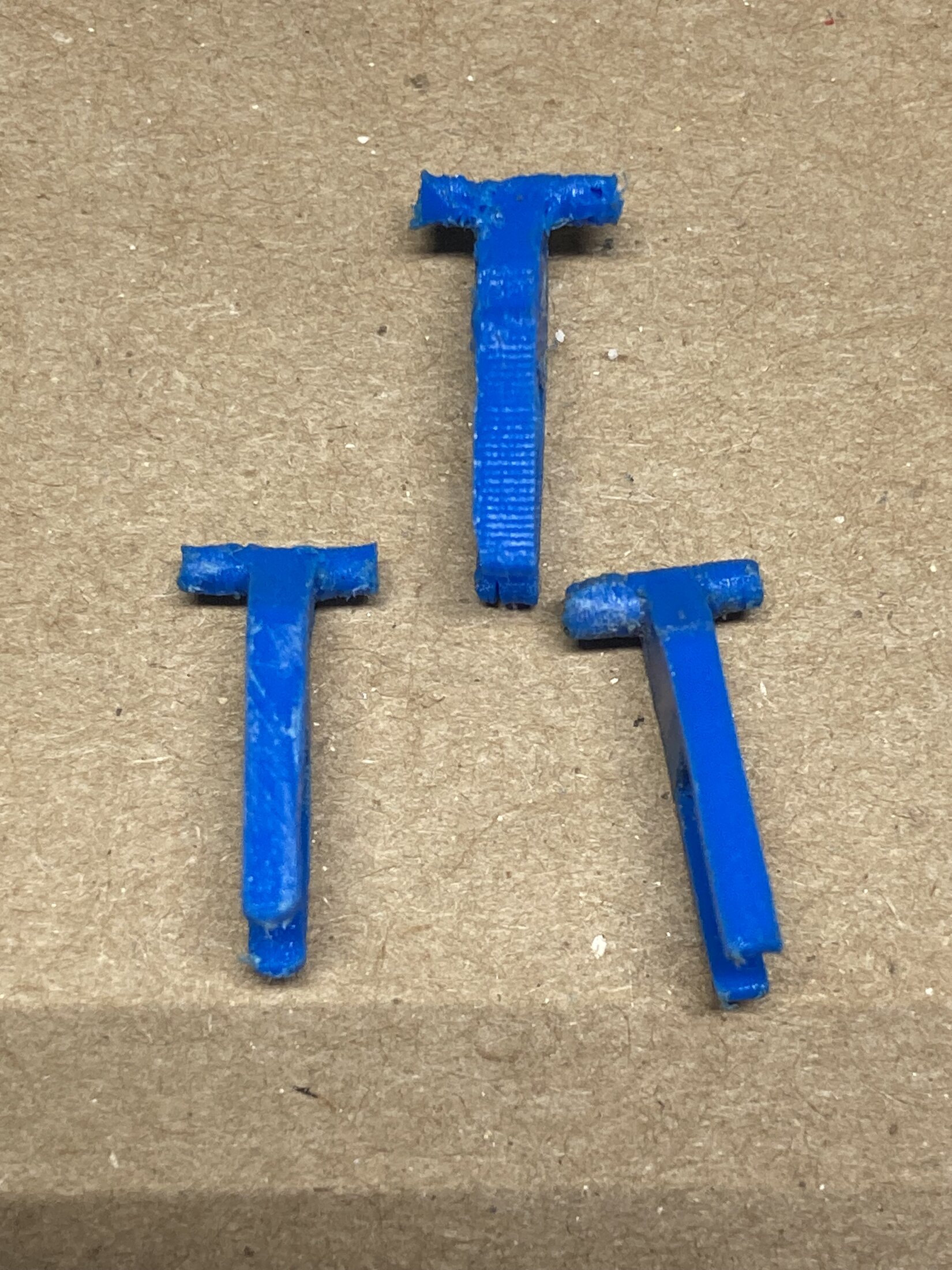

I got the first batch back from the 3D printer. They were a little rough around the edges and needed some sanding to fit. They need to be no more than 2mm thick and ended up 2.34-2.45mm thick near the top. My friend said he will try another material as well.
I was hoping this would be a drop in solution that he could produce and offer, but I am not sure now. Because they are so small, they may be reaching the limits of his printers capabilities.
But my window switch is now working again.
