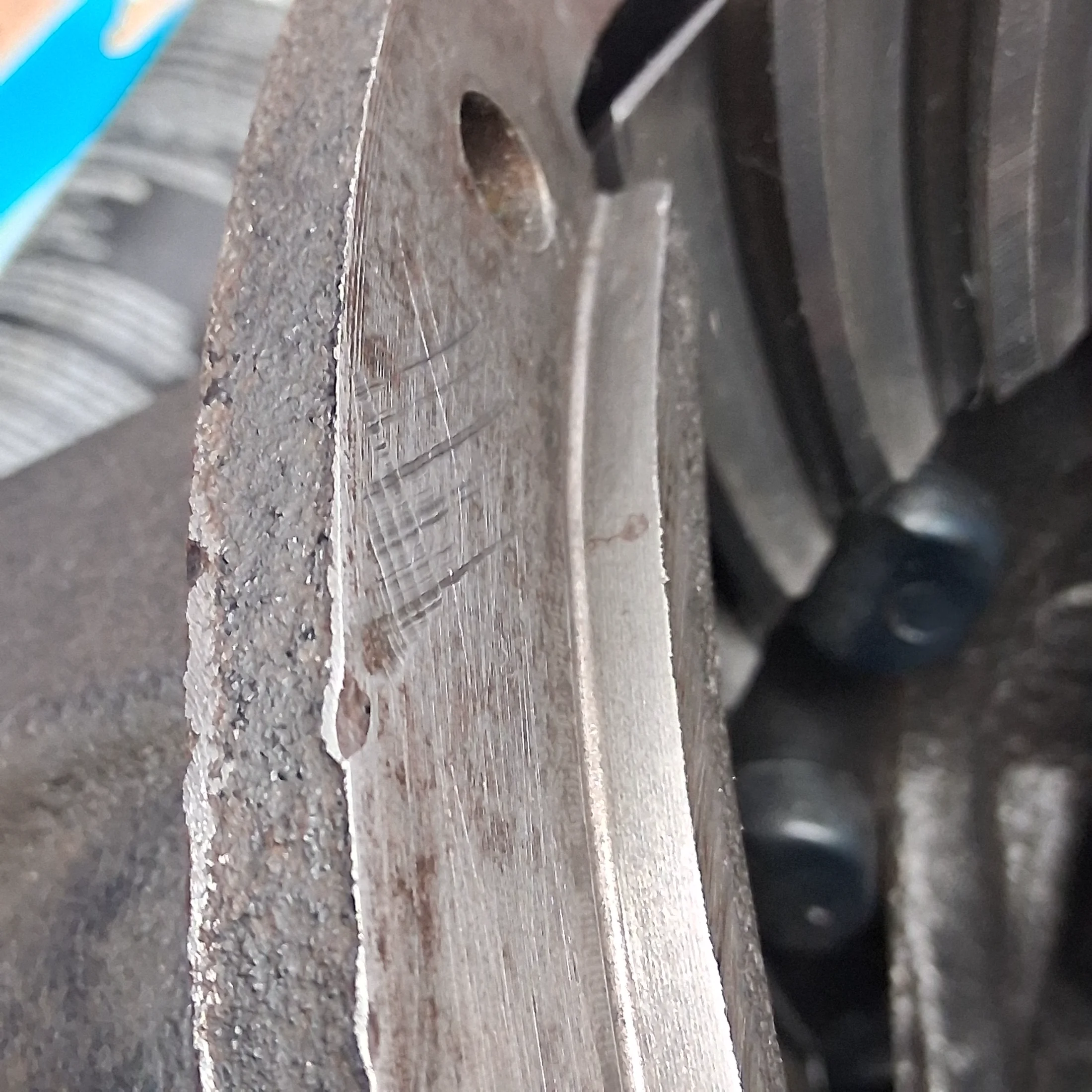

here's the 2 worst offenders. the first picture is the worst and of course it's located at 06:00. second picture is at about 11:00
You should be able to hit it with some Emory cloth/sand paper and take care of it if that.
800 grit should do it then if you want it really smooth go up to 1500 or so.
I'm probably being waaaay too OCD! I may just use some universal blue but @dbbowen may have something with using the FIPG
The OE cork gasket and FIPG will work well, but you'll curse the gods if you ever have to remove it, again.
A good alternative technique is to use the Black RTV and the cork gasket, THIN smear on all sides, and just finger tight the whole thing. Let cure for several hours to a day, then tighten to spec. Otherwise, the RTV just squishes out and you'll leak.
Or, Gaskasinch.
