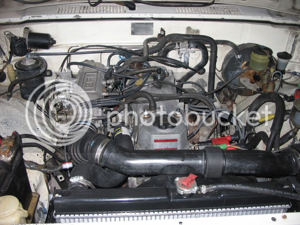

Good evening all,
I am new to these forums and would like to introduce myself as well as seek advice on a problem im currently having with my new to me Toyota pickup. At 20 years old i don't need this kinda stress to turn my hair grayer than it already is. I just recently acquired a 1985 Toyota pickup SR5 with a 22re and a 5 speed. The truck is in absolute amazing shape with the interior pretty much perfect and body and drive train untouched.
Picked the truck up and it ran great and got me home from the sellers house no problem, but when i went to get the smog check here in California it did not pass for one stupid reason. Timing was not set correctly and therefore making it fail. Figured that was no big deal so i went home adjusted the timing to 5 degrees and took it back to the guy but the car had lacked some power. On the dyno with the smog machine it would not spin up past 15mph. Frustrated i took the truck to my mechanic to later find out that the truck's cam timing marks were off by two teeth which was a relief because i thought i found my problem.
I got a call back the next day and he had said that the timing is set correctly and that the timing advances once you undo the diagnostic jumper, but as soon as you go to accelerate the timing retards and has absolutely no power.
He is convinced that the problem has got to be the ECM, but its a hard thing to test and i dont justify buying one just to see if it is correct.
I got a few questions:
What other systems in this basic 22re system would cause the electronics to retard the timing?
I was originally thinking the TPS but i wouldnt think the TPS would retard the timing. Should i look at the tps a little more or is my thinking correct?
What ecm's are compatible with a 85 22re?
What if my engine block is newer than an 85 would that make it run different if it has a 85 ecm on it?
Thanks in advance i appreciate all the responses i can get,
I have used the search function with not luck.
Here are some pictures of my new friend. :)
Jake
