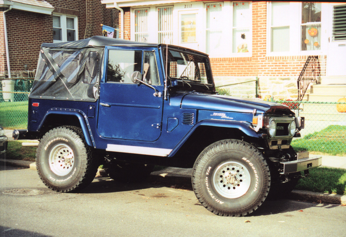

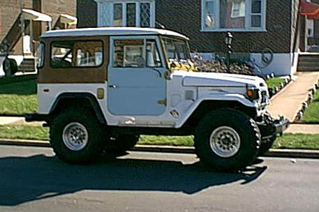

Any pics of your tub? Curious about fit and finish.
Here are 2 pictures of my fiberglass body...
