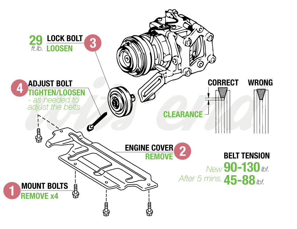

Well I got it off but thats doesn't seem right, if anyone could provide input on that I'd appreciate it. The new belt is about the same size but without teeth
What seems off, or what's the question?
The notched belt isn't original equipment and could easily have been a touch small. Try the new, correct belt to see how it actually fits. It won't be easy/possible to eyeball a small but relevant size difference between the two.
Did you unlock the idler pulley first before adjusting? It'll get plenty loose once adjusted.
So I followed the steps in your diagram and the pully moved up and wasnt touching the belt at all but the belt was super tight. I have to pry it off with a screw driver.... did I miss something???
I guess the question is the belt supposed to be that tight with the adjustment pulls at full slack. It didn't seem right.
Attached the wrong one above. This is the problem child. Also in my pic above the adjustment pully is removed completely so why is the belt so damn tight ??????
