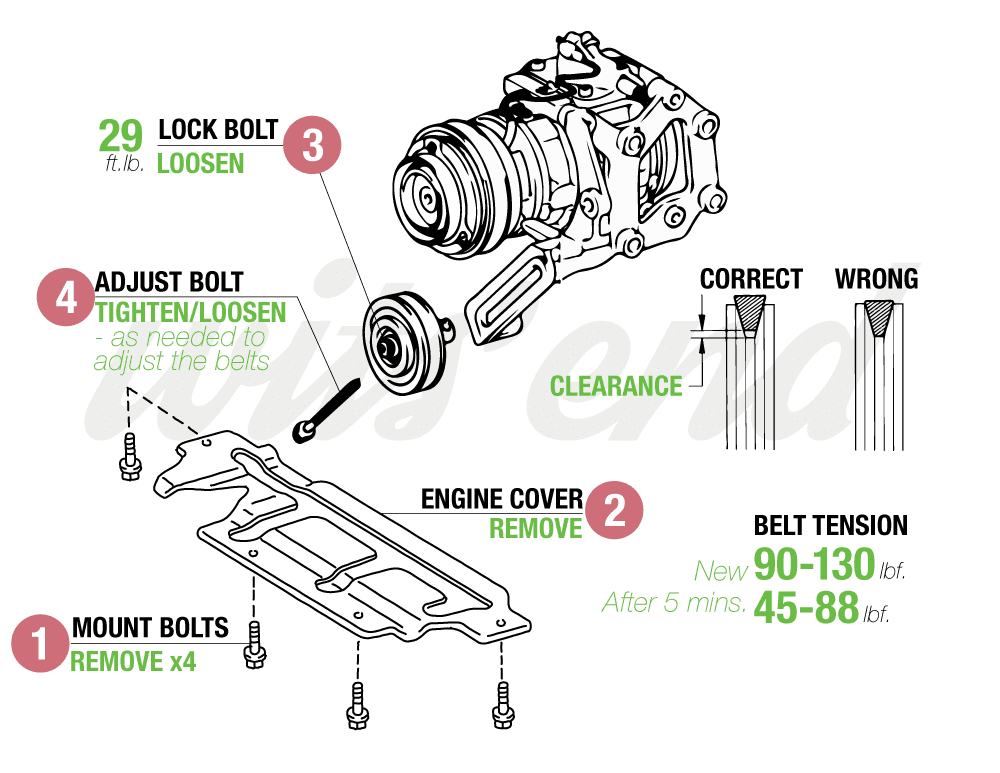

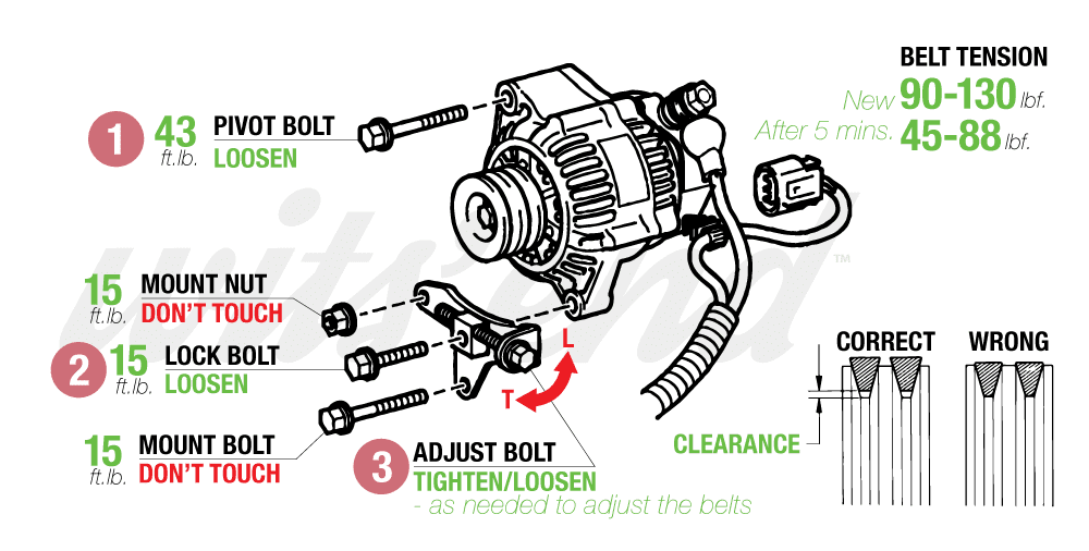

I also keep reading about belts being done wrong and thought that would be simple but apparently I’m mistaken any tips?

  • Just use oe belts, matched for the double belt, and you should be good. Tension is the only other gotcha that I'm aware of but may be forgetting something.
