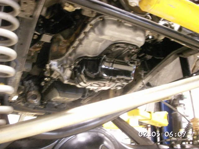

LS400 is a front sump
SC400 is a mid sump.
I don't remember which one I used, but 92-98 for either. I did have to modify the pan a little to fit, and a hard hit could still possibly hit it
Are any of you guys aware if there any rear sump UZ pans that your that arent rare like the marine pans are ? I think I may just mod mine.

I currently have the 2uz ('05 vvti) fitted in the 80. Engine is forward 6". Engine plastic cover just touches the hood insulation. Tundra oil filter housing clears the cross member and filter is 1/16" off the frame rail when removing the filter.....phew, that was close. the vvti headers are a PAIN to modify. I should have taken robs advice and modified aftermarket headers. Thanks for the photo's of the tunnel mod. I did that before the engine even went in, saved me a TON of work.
I vote for the l.c. pan. I used the 92-98 rear sump sc400 pan. fit great, but the front driveshaft poses some obsticles. I had to take out a 4" x 4" section of the pan for it to clear. (lost about a quart of capacity.) and some of the bolt holes had to be drilled out to fit the larger diam. bolts. no big deal though.

Im going to mod the stock oil pan this weekend.

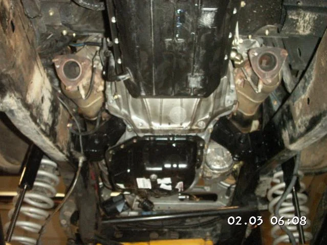

no photos yet. will put a build thread when done....and get some photos. found a 40th with a blown engine at a dealer. paid way too much for it. certainly not perfect, but it has lockers. its going to be the family vacation hauler. anyways, back on topic.....
did you use the stock cats? where did you run the exhaust? i "think" i have it planned out, but not really sure if its the best route. drivers is down along frame, crossing over after c.diff. passenger is over the frame, through wheel well, down along frame. 2into1 collector, 2-1/2" back in stock location.

I ran generic magnaflow, but the stock ECU doesn't like em. I ran my exhaust outside the frame rail on both sides, then back inside the frame rail just after the t-case into an x-pipe. Then dual mufflers and dual tail pipes, one out each side. All 2 1/2" pipe until after the mufflers, then it is 2" Wish I would have stayed 2 1/2", as I noticed a small power decrease, and it didn't sound as nice.

I ran the stock cats and did exactly what your talking about. Pass side out over the frame rail like the stock FJ setup then over the rail and it merges the with drivers side which I ran on the inside drivers frame rail up over the driveline. Then into the muffler in the stock location and up over the axle.
