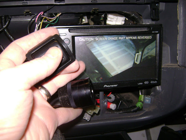

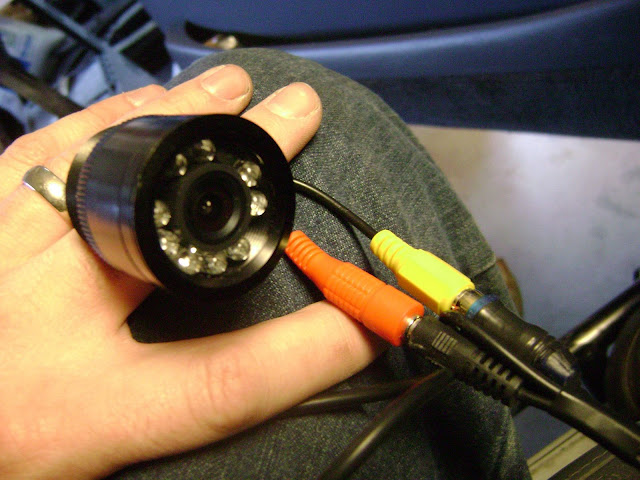

I'm still working on finishing up the interior. I picked up a $5 camera from fleebay for use as a rearview camera on my navi deck. Im not using the ECT button anymore so instead of hooking the rearview camera to the reverse lockout in the radio, I hooked it to the ECT button.

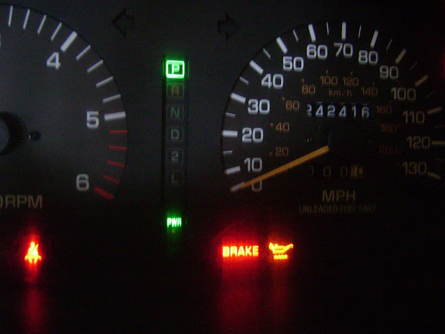

It already has a light on the dash that says PWR. Pretty sweet. Took about 30 seconds chose and to tap into the wire.
Cheap camera. Ill fab a mount off the rear diffuser to look down off the roof.
Regular map or audio/video feed in the off position
Then in the on position - voila
And if the image on the screen wasnt enough to remind you that there would be an image on the screen, there is also a green light on the dash yelling at you as well.

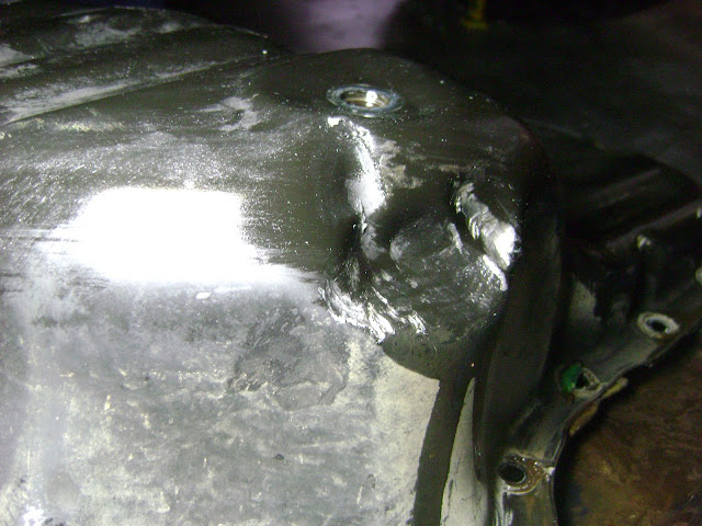

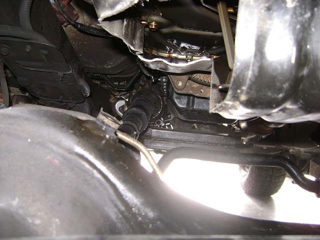

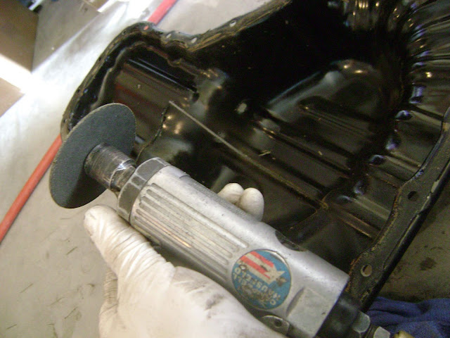

A few posts back I mentioned that the axle was hitting the oil pan. Here's a look at the self clearancing that occured.
Obviously a liability, I started looking for a pan that fit. Meanwhile I wanted to get off pavement and needed to do something right away so heres a few photos of the oil pan I built from scratch.
I either want to find a newer 4.7 landcruiser or LX470 pan that fits or I want to either rebuild this one in it's entirety with a mounting flange thats laser cut, or find a LC sub pan.

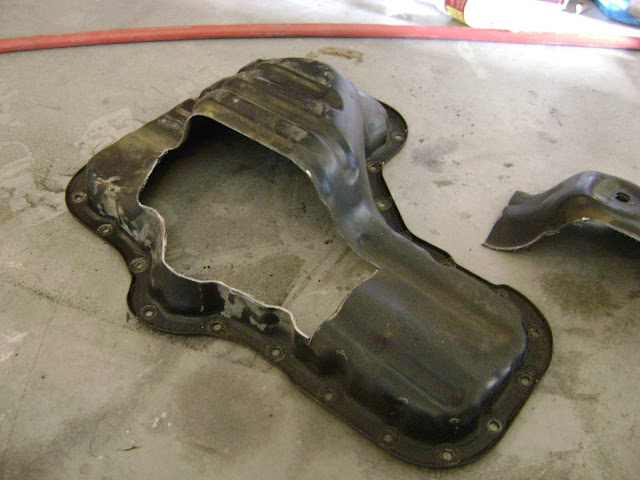

I really only needed to modify the stock pan in one area.
The trusty cutoff wheel to the rescue
At this point I would have probably been fine

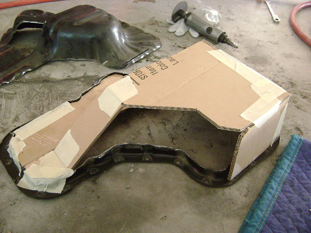

But I was worried about losing capacity, but whats done is done so...I hacked the rest of the pan off and did a super ghetto mockup with cardboard
Once the mockup was complete I used it as a template
I no longer own a tig, so this mounting flange was doomed to get warped to he11 with the mig even on the lowest setting, and going as slow as possible to not introduce too much heat.
I reused the stock drainplug and mounting flange. With spot welds
Its not pretty, but it did the trick in a pinch. I was up till 2am friday night getting it ready to hit the trails at 7am saturday !
You can see here after the trip, I have a small drip coming from the drain plug because I reused the washer, not having a new one at 2am and all
