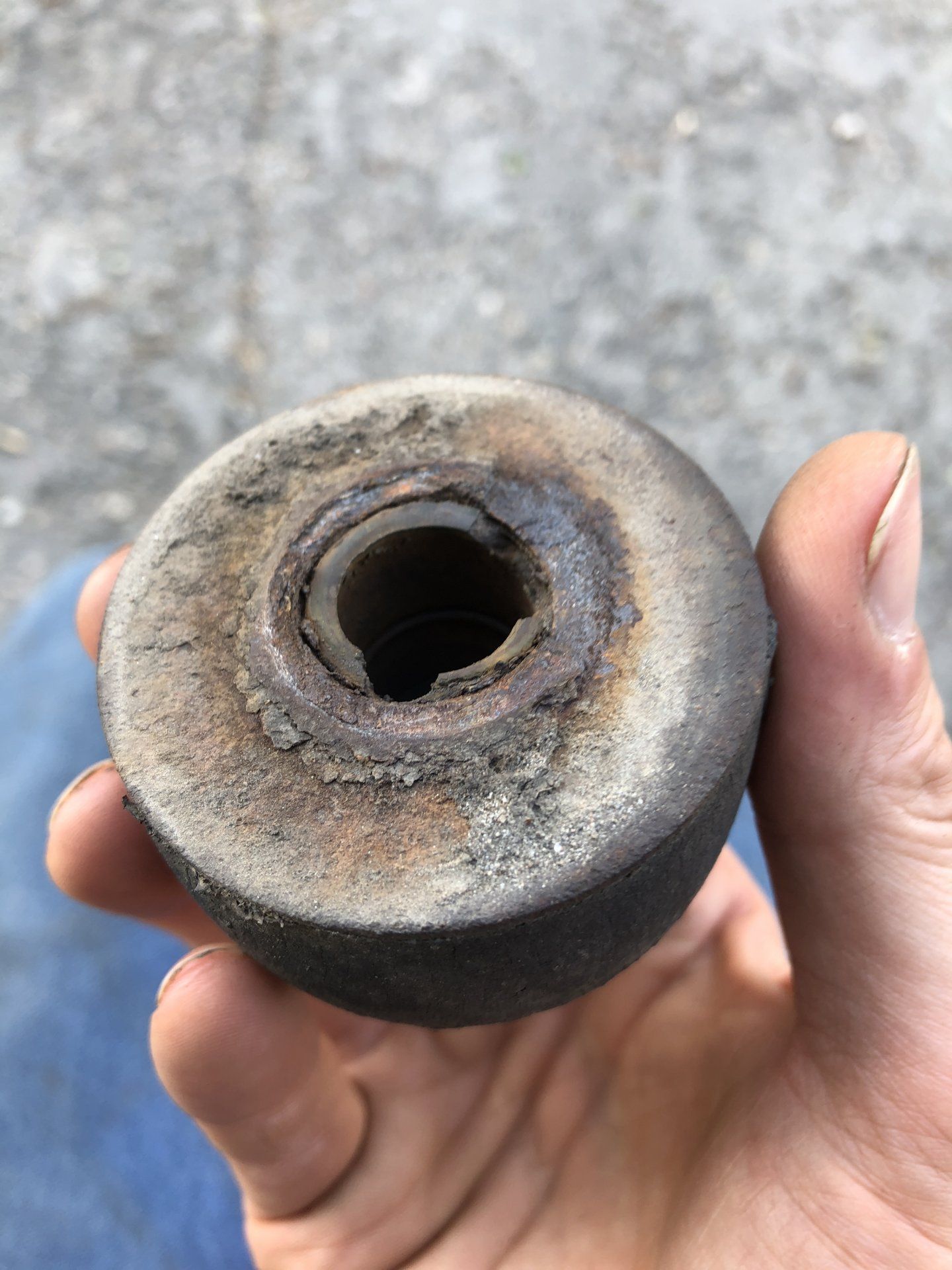

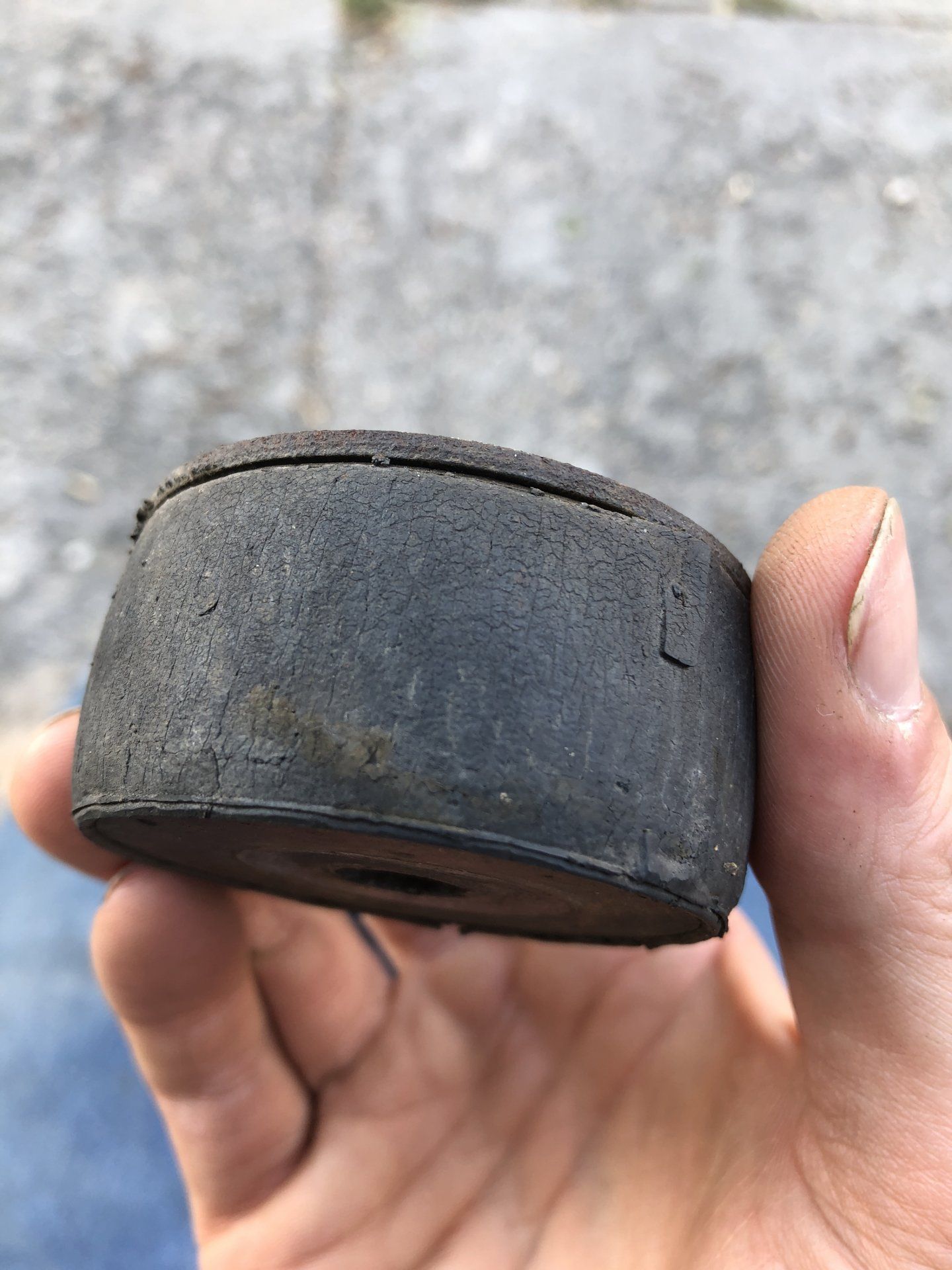

For posterity the Feb 1987 FJ60 has two small, four large, and six medium bushings. I would suggest getting longer hardware because some of the bolts were not long enough. And I would also suggest getting the heavy duty bottom washers to replace the oem cup washers. A few of mine were trashed and I need to find something to shim those two points now.
