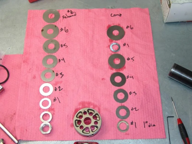

This is an example of the shims and valve that is used in one of our shocks. The size and thickness of the shims is what determines how the shocks reacts. Also the position of the shims in the stack.
So there is not a single number that describes this whole relationship. If we did assign a number to it, it would essentially be a recipe number that tells us how the stack was made up. A shocks response can not be explained in a single number. If you dyno the shock, you will get a response graph. Only then can you compare them.
There is no standard for how these stacks are numbered. So when you talk about a 200/90 Bilstein shock, it tells them what is inside the shock and they can modify from there. It does not mean anything to another manufacturer.
