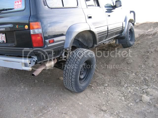

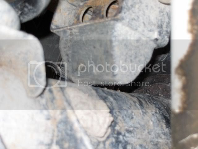

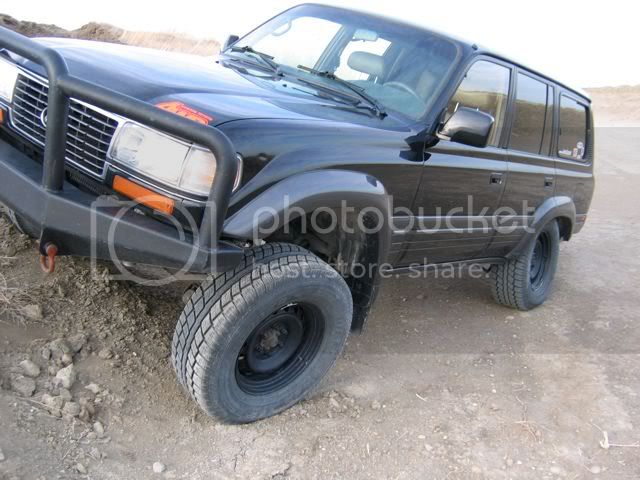

Here are some pics I took last night. As I mentioned before on this thread, one of my shocks blew up after only 2 months of use. After consulting with Ebag, I checked the flex to see if my shocks in the rear were being over compressed. As you can see below, I have a little over an inch left once the bump stop contacts the axle. Hopefully it was just a factory lemon. The shocks have been performing very well!!

Not only are the Pro Comp's travel a bit longer, but their body is longer--meaning that the travel is perhaps more suitable for taller lifts.
The catch is that you need to check to make sure you're not over compressing them, you might need to drop your bump stops down a bit depending on how you setup the shocks and how big a tire you're running.

Hey good pics and nice cruiser, I am glad they are working out for you.
Cody.
Thanks Cody! .. I am really very happy with them.
