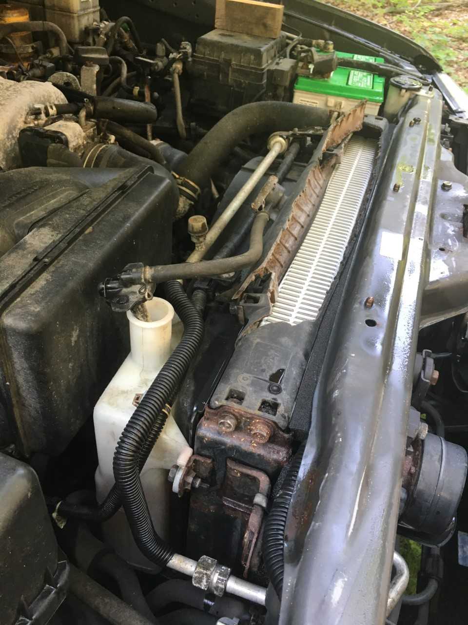

It can certainly happen. Plastic radiator top started leaking on my 100 series but spit on my 80 series.
Not mine below...but representative of what can happen.
