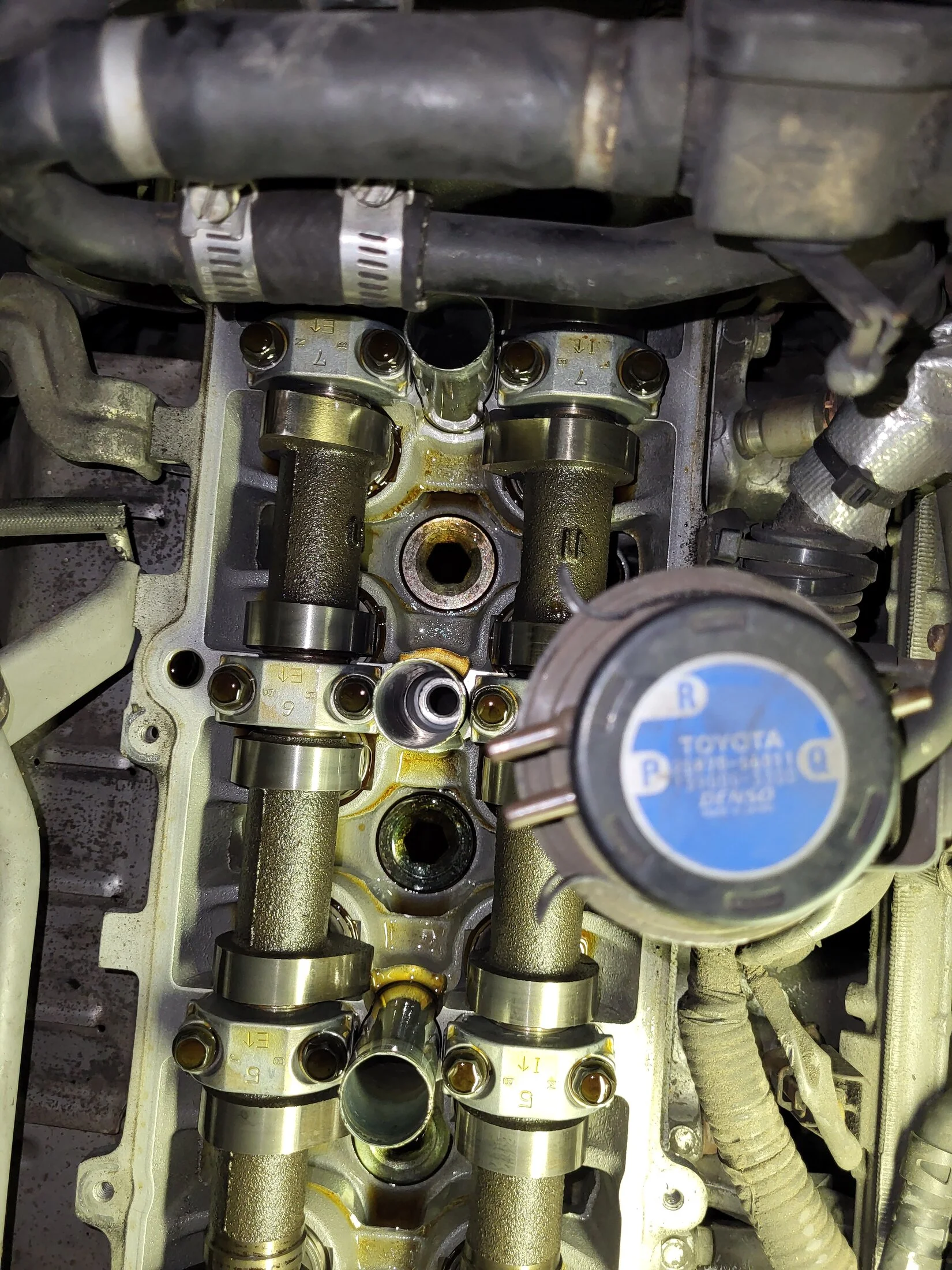

Here's something interesting going on between cylinder #5 and #6 on to of the head. What's that big hex plug? See the darkened area.
As an observation from outside, you have stayed in a couple cases "that's not the problem".
I'm not meaning to gouge, but step back a minute and rethink every test you've done. Take nothing for granted.
You have oil in the coolant.
You do not have coolant in the oil.
You are losing coolant.
Where can oil get into the coolant, but coolant cannot get back into the oil?
The oil must be at higher pressure than the coolant.
Where am I losing coolant?
I hate to say it, but I think you may have a cracked cylinder wall. That's why you need to do an exhaust gases test in the coolant.
After you did the oil cooler clean and reseal, how did you flush and clean the cooling system to get the oil out of the radiator, block, heater cores, etc?
Maybe do a static pressure test of the cooling system with the spark plugs out, and scope the cylinders to see if you can find coolant drips. May need to rotate the engine to observe the entire wall in each cylinder.

Wait. I do have coolant in the oil. I stuck a borescope into each cylinder and no coolant/water. I'll take some pictures in the morning.
My apologies for not stating it clearly; oil in radiator and coolant in oil.

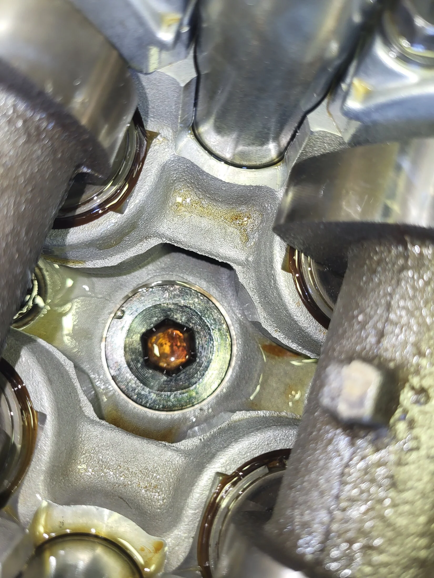

You were right. Cracked head on top between cylinders 4 and 5 exhaust side.

Thanks for the pressurizing idea. The cylinder walls were ok. I found a crack on the head.
I see water but where's the crack??
Did you suspect anything wrong with the head while it was apart? Installed a new head or rebuilt original head?
Is it leaking below the cylinder head plug? You can replace the metal gasket under each one of those big Allen heads. The gaskets come in the engine gasket kit.
