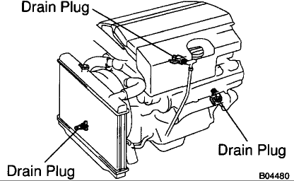

The FSM does not recommend a flush but does recommend using all three drain plugs and torquing them to 9ftlbs.
This pic posted by mabrodis (Here) shows the plug locations. The two block plugs are on opposite sides of the block.
attachment.php
Amando had this advice on accessing the plugs.
You need a 14mm wrench to open it, it's not that hard, also what helped me was I put a 1/4" hose to it so it doesn't leak all over you and you can drain into a pail for proper disposal.
Also, if you leave the radiator cap on, only a small amount of coolant will come out right when you open it (the bolt) , then as soon as you are ready to drain everything into a pail or what ever you want to catch it with then let the air through by opening the radiator cap.
Don't tighten too much, it doesn't need that much and you don't want to strip it later.
Other than Mark's photo from the manual you can look through the wheel wells and see the bolt for the block, it looks funky because there is like a tube looking thing attached to it.
Good luck.

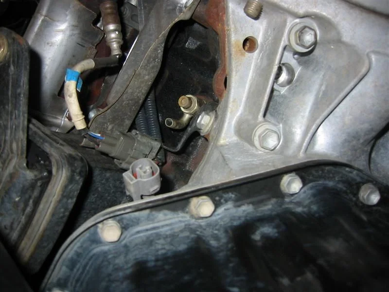

Kathmandu,
I "accidentally" took a photo of the drain plug on the driver side a few weeks ago. It is in this post:
https://forum.ih8mud.com/showthread.php?t=148046
No, apart from some very "slight" surface rust (can be dusted off with a brass brush) on some of the suspension components, the entire vehicle is rust free underneath. But those few areas, where there's rust, looks bad in a photo. Not at all bad in real llfe. Likely the flash that enhances just that color spectrum.

Kathmandu,
