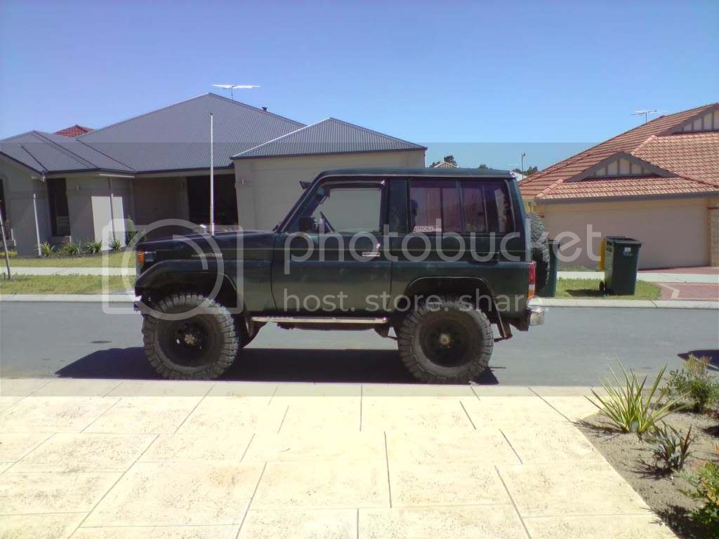

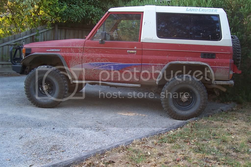

Heavy duty 70 series models have the quarter window vents and electric windows, the whole door wont fit through as the window frame shape is different on models (corner at top of windscreen not curved) with a fold down windscreen. Hardtop/fixed roof models should have the same window frame shape as yours.
Ie Gibs import 70 (i think power windows too), though no quarter window vents, not sure about AUS delivered HD shorties.
a Light duty 70 series (Bundy) has the curved window frame and electric windows, the whole lot might fit a 78 troopy. This one has a curved frame, vents and elec windows.

any lc with a front window that has hinges like the 75 utes and 73 middys if you look were there top corner of the door is (were the front window meets the roof corners ) its pointy as said above look at troopys, shortys ,79 utes and there curved im looking at doing the same mission to my 79 std ute ill probly use the whole insides full length window runners and rubbers and glass out of a old wrecked swb from the wreckers any luck i might get velour door trims
