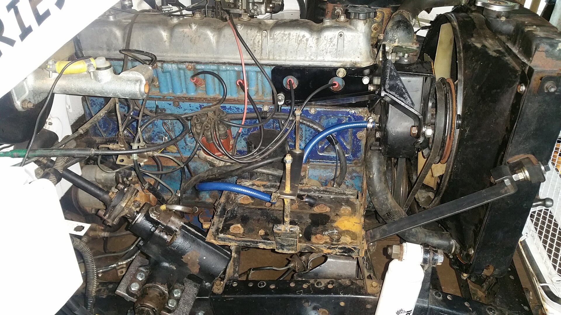

I'm a big fan of the mini truck / hilux PS box conversion. It keeps everything forward if the pitman arm, the column stays as is and all you need to do is make an angled shim to adjust the angle of the box on the bracket, or make a new bracket.
As far as hydraulic PS options, it's the least intrusive.
Excuse the mess of an engine bay, my last 45, but it shows the general idea
