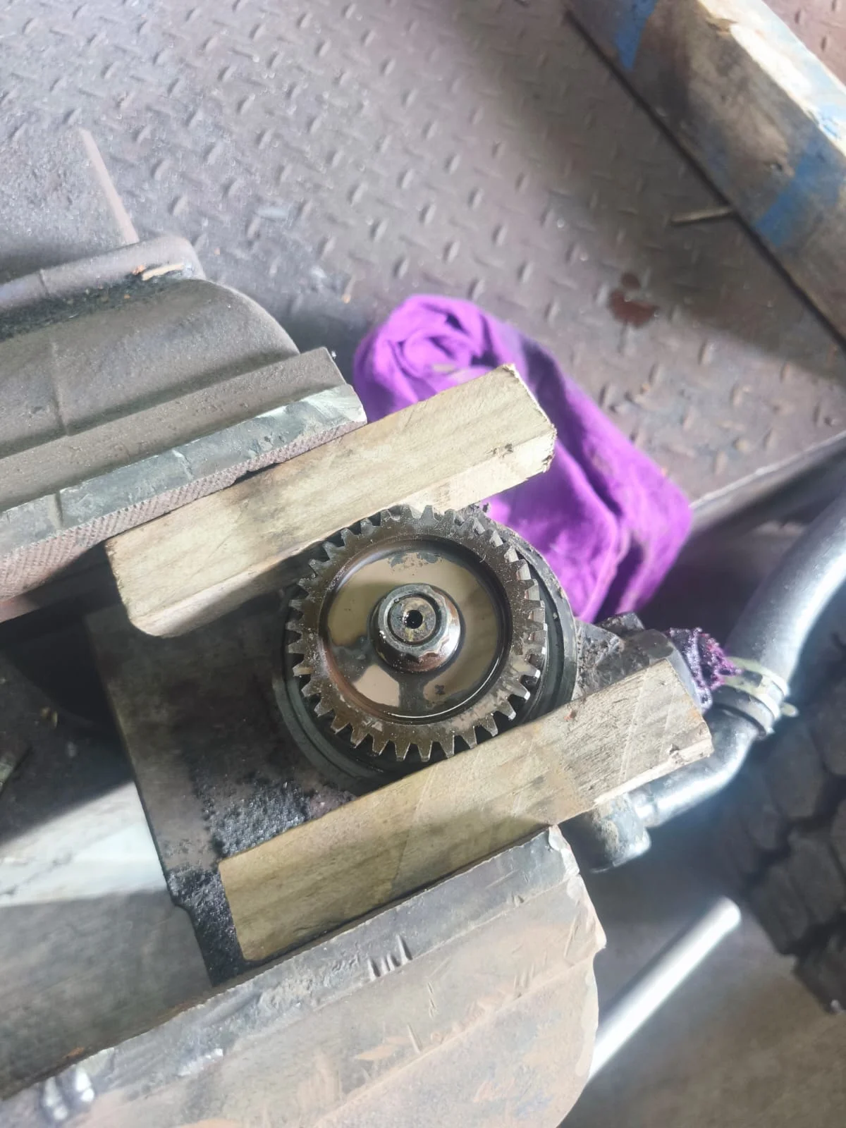

Hello everyone, I’m new here but I’ve known this forum for quite a while. Over a year ago I got my first TLC. It’s an 80 Series 1FZ-F (carbureted) with an H151F manual gearbox and barn doors, which I’ve been restoring and modifying little by little.
Long story short, I noticed I had an oil leak from the power steering pump, so I decided to fix it with the OEM rebuild kit. I disassembled it, cleaned everything carefully, and followed the FSM instructions. When I put it back together and started the engine, everything was perfect, but after a few minutes a soft knocking sound began. Since I’m pretty obsessive, I started looking for information and saw that several people had an issue where, after disassembling the pump, there’s a reassembly problem with the pump gear. When I did the install, I made sure everything was properly seated—the gear bottomed out, the keyway was correct, and I torqued it to spec. My question is: should I buy a new pump with a new gear, or should I try to inspect what’s going on? I know I didn’t damage the gear teeth because I used two pieces of wood to clamp it in a vise.
thanks!

It is probably the gear. You can buy them from Toyota. I did a ps pump rebuild and botched it. Decided on a new pump to get things on the road.
I don’t think bottoming out the gear is correct. There should be a gap between the gear and the housing you needed to keep the same. Like here.
thanks! since is tapered it stopped by itself, probably used the wrong words. i did install it with a press, i didnt want to hammer it or drive it with the nut and the impact.
im thinking the same, but i think i will try to get everything new. if the original lasted 30 years, a new one will last the same. altho now i'll take even more caution
That gear is very soft. When you pull the pump, check for deformation of the teeth.
