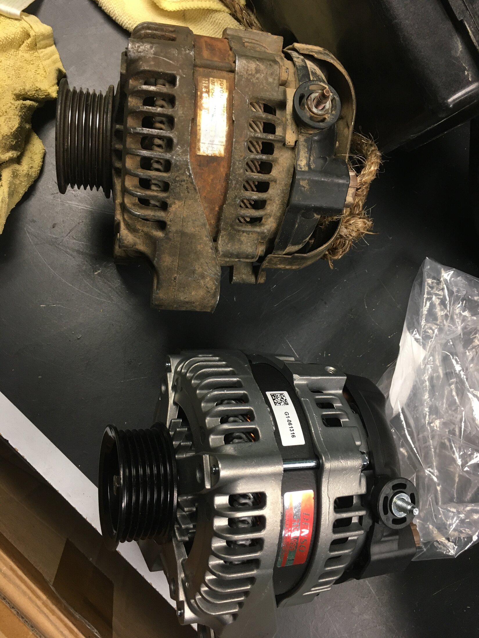

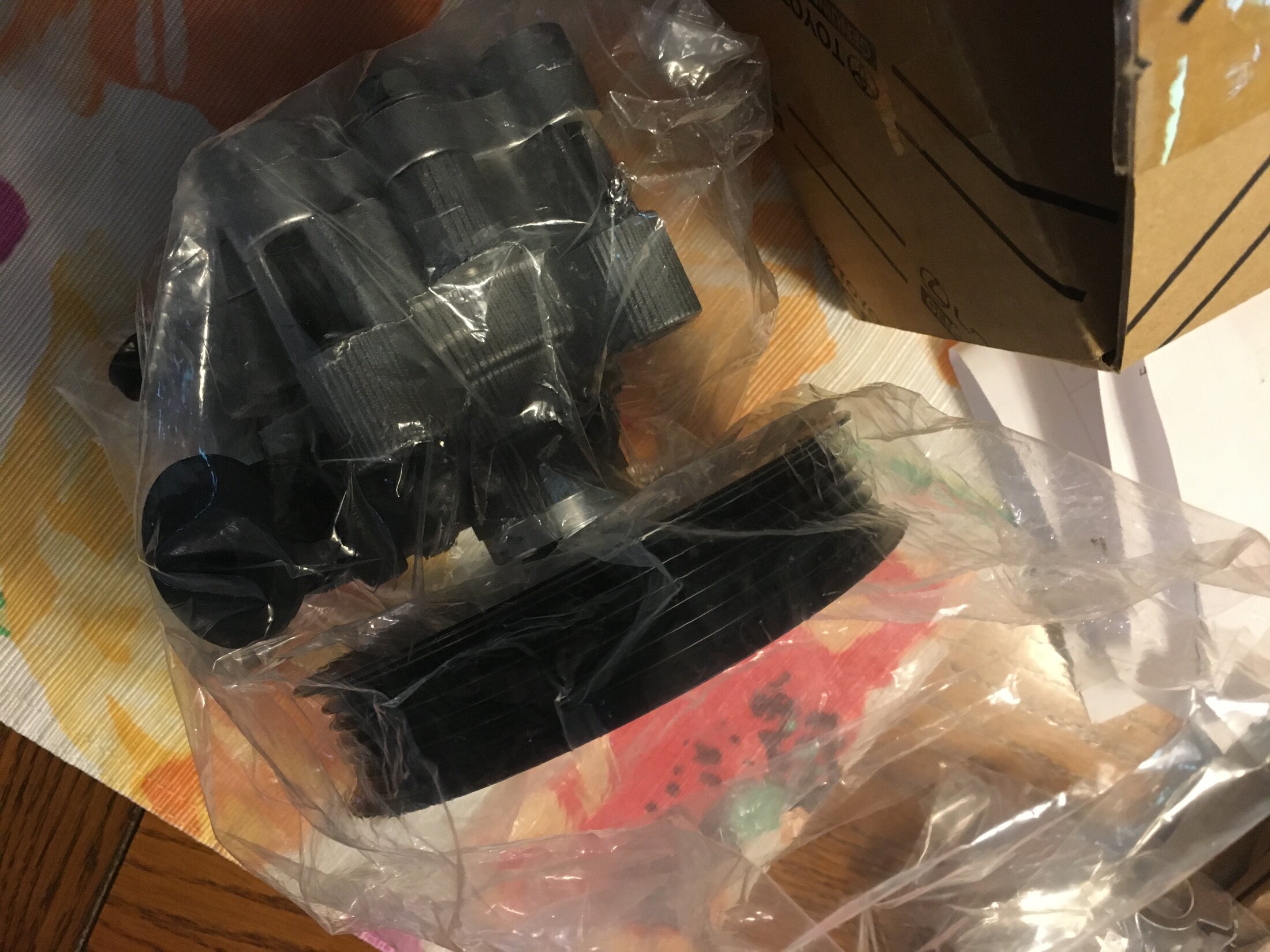

Installed the new PS pump 44310-60390. While I was in there I felt the alternator bearing again and it wasn't perfect so I went ahead and installed a Denso OE alternator 210-1099. I couldn't find the correct puzzle position to get the alternator out, so I removed the plastic timing belt cover and that gave me enough clearance to get it out. Moaning is gone!

Typically when vane pump has gone bad, it's the bearing. They almost always then leak, when bearing bad.
Sound was like a vane pump with air in system.
Make sure you bleed air with tire off ground engine off first, then tire on ground engine running. Each is done by turning steering wheel slowly lock to lock, holding at lock 3 seconds or more and inspecting fluid for foam/bubbles.
Note: Torque spec for three 14mm vane pump mounting bolt: 13ft-lbf. Over-torque, can result in sound and damage, to vane pump.
Note: Make sure to move old wire housing bracket from old alternator to new.
Good for you. Nice to have that done!
