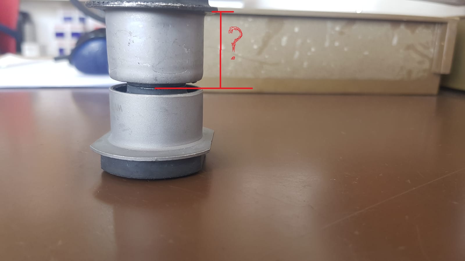

For the OEM bushing - can anyone clarify that it is actually 3 parts? Inner metallic sleeve, rubber material, outter metallic cup? I thought I read that it's just metal cup and rubber bushing but then a pic I found looked like it also had a metal inner sleeve that makes contact with be bolt.
Why hasnt anyone made a 2 part urethane bushing that can be pressed into the cups, thus alleviating the need to remove them?

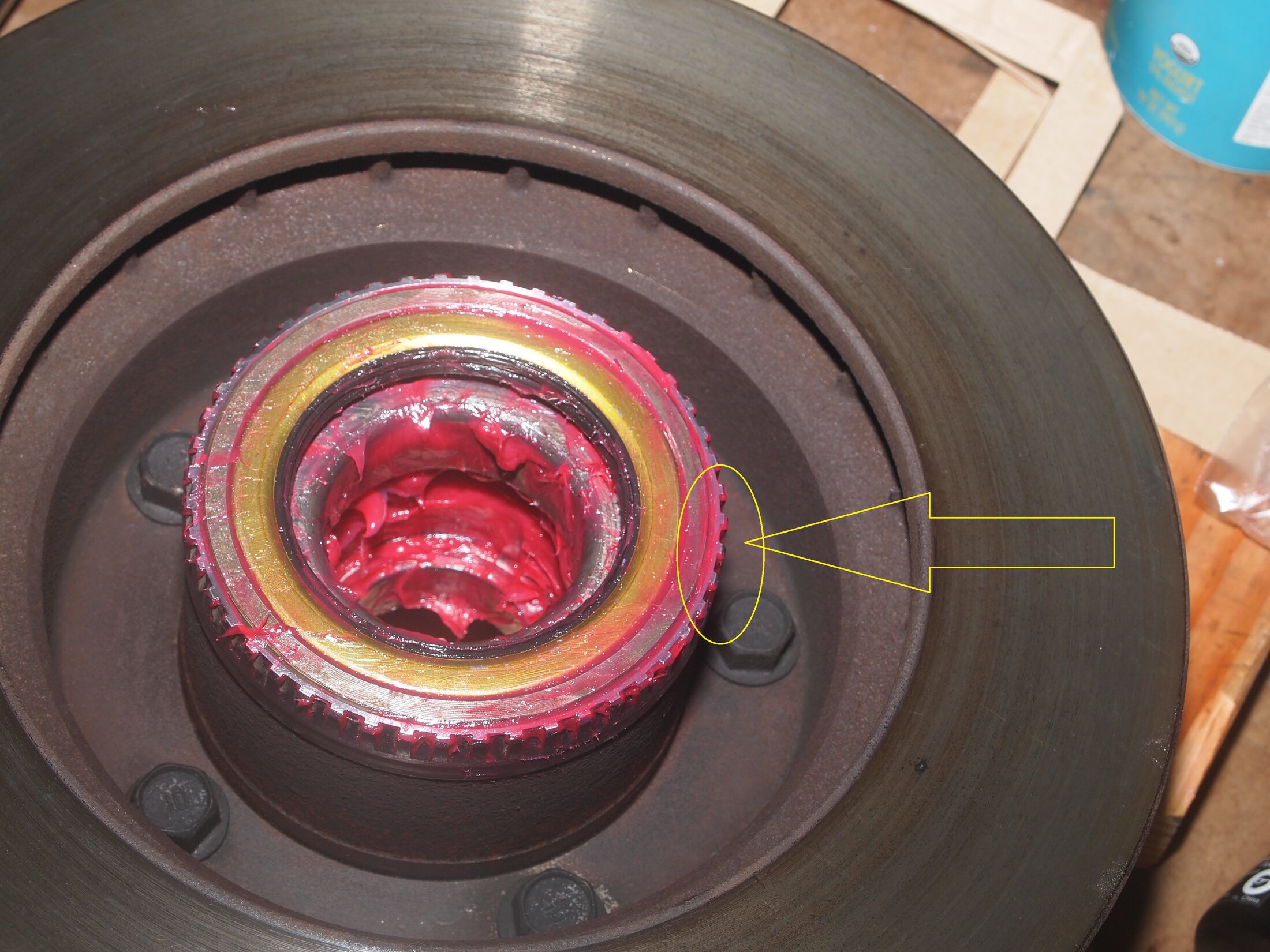

Any play in wheel bearing can set off ABS. This is extreme play:
ABS activates when a wheel is turning at different speed, than others. It the wheel speed sensors job, to relay this info to ABS ECU. Loose wheel bearing result in wheel hub wobble
Backside of front wheel hub, is a tone ring that wheel speed sensor reads.

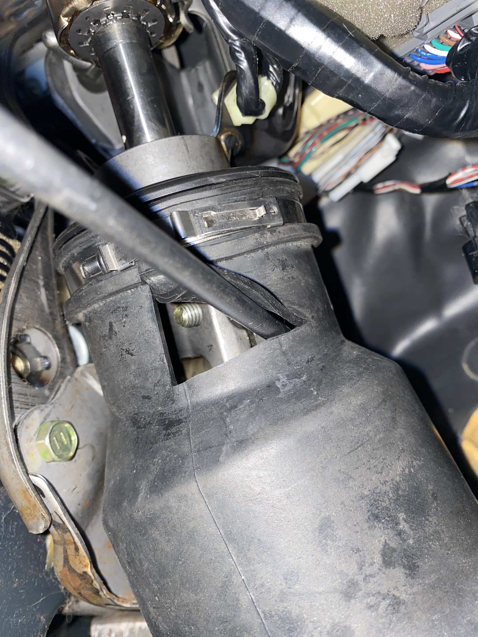

In next two pictures, we see large boot and steering column snap ring that had come free in 03LX VGRS system. This is the reason for 03-07LX snap ring recall. This 03LX with VGRS, hadn't yet been in Lexus dealership shop, for the snap ring recall. Funny at 320K miles, it never had been recalled. Nor did it have any service history at Lexus or even any entries of service in carfax anywhere. It is, my most extensive restore to date. One day with time, I'll right it up in mud.
VGRS actuator is cover by large boot
Snap ring had come loose and slip down shaft. Dangerous!
VGRS Actuator (AKA #1 intermediate shaft). A $3k part at Lexus. Which is so rarely replaced. One very large and busy Lexus Dealership parts department, has not sold one in last 10 years (oldest records they have). Their service departs, sees ~100 lexus a day. VGRS is a Lexus product, and in more than just our LX470. They are very robust, built to last forever.
Here is boot cut, after snap ring recall service. Also notice change in components above the boot on shaft and at outside of firewall. It's the only one I've ever seen where Lexus tech cut the boot open.
The above recall was done so poorly. I got my hands the the recall TBS, with service procedure, to see how should have been done. I learned a lot, about VRGS and calibrating on this one and one other.
For one I found the kit has the fire wall seal included. This/these seal aren't being replace as required by the recall TSB. I checked all my 03-07LX, and found ever single seal was tron. This seal, prevents dust and air from engine compartment, form getting into actuator. The inner boot with its seal at top, also prevent air and dust entering cabin, and dust from footwell entering actuator.
In the above case where Lexus tech cut boot open and didn't replace fire wall seal. It create easy air passage (no back pressure due to boot cut) into cabin. This one 03LX, at the time. Had a bad cracked exhaust manifold on BK1 (DS). Exhaust fumes where filling the cabin. The VGRS dash light was on, when I picked it up. I assumed battery disconnected, and not yet driven up to 25MPH in straight line, than turns LH & RH. Which resets the VGRS. Nope it was not calibrated. So VGRS light would not go out, and steering wheel would not center. I had the hardest time calibrating it. It keep failing all attempts. Until I found ABS zero point calibrations was undone. Which zero point (ABS) must be set first and all flags cleared from VGRS. Then calibration done. This Lexus dealership sent me out in a vehicle unsafe to drive. But due to it, I learned a ton about VGRS. That and another 03LX was was helping someone else with.
