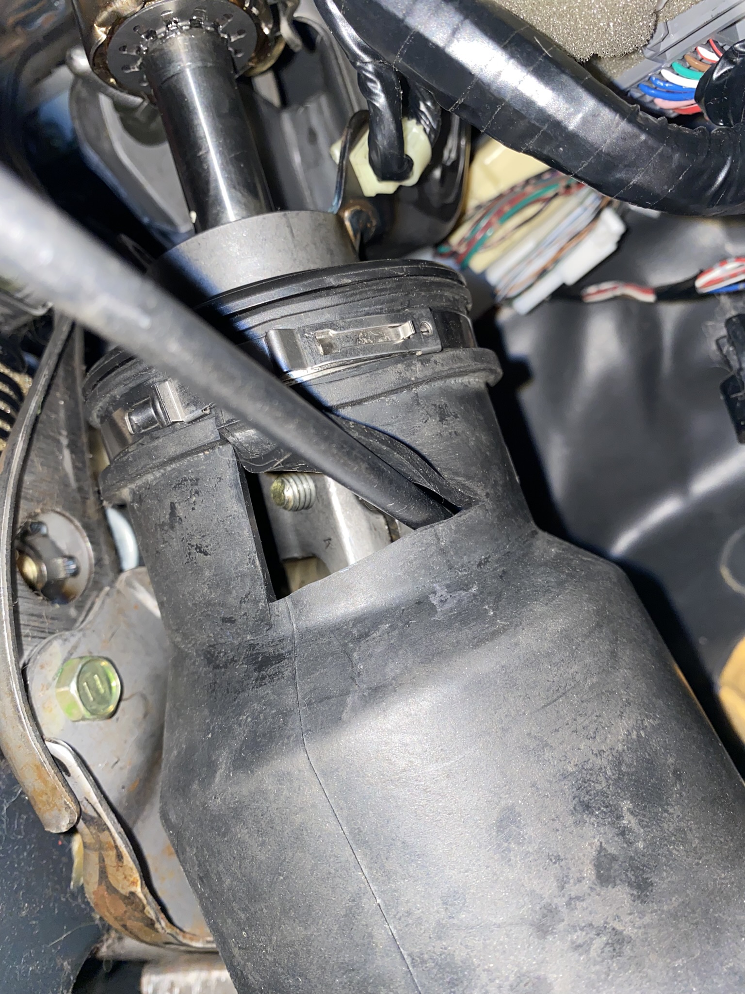

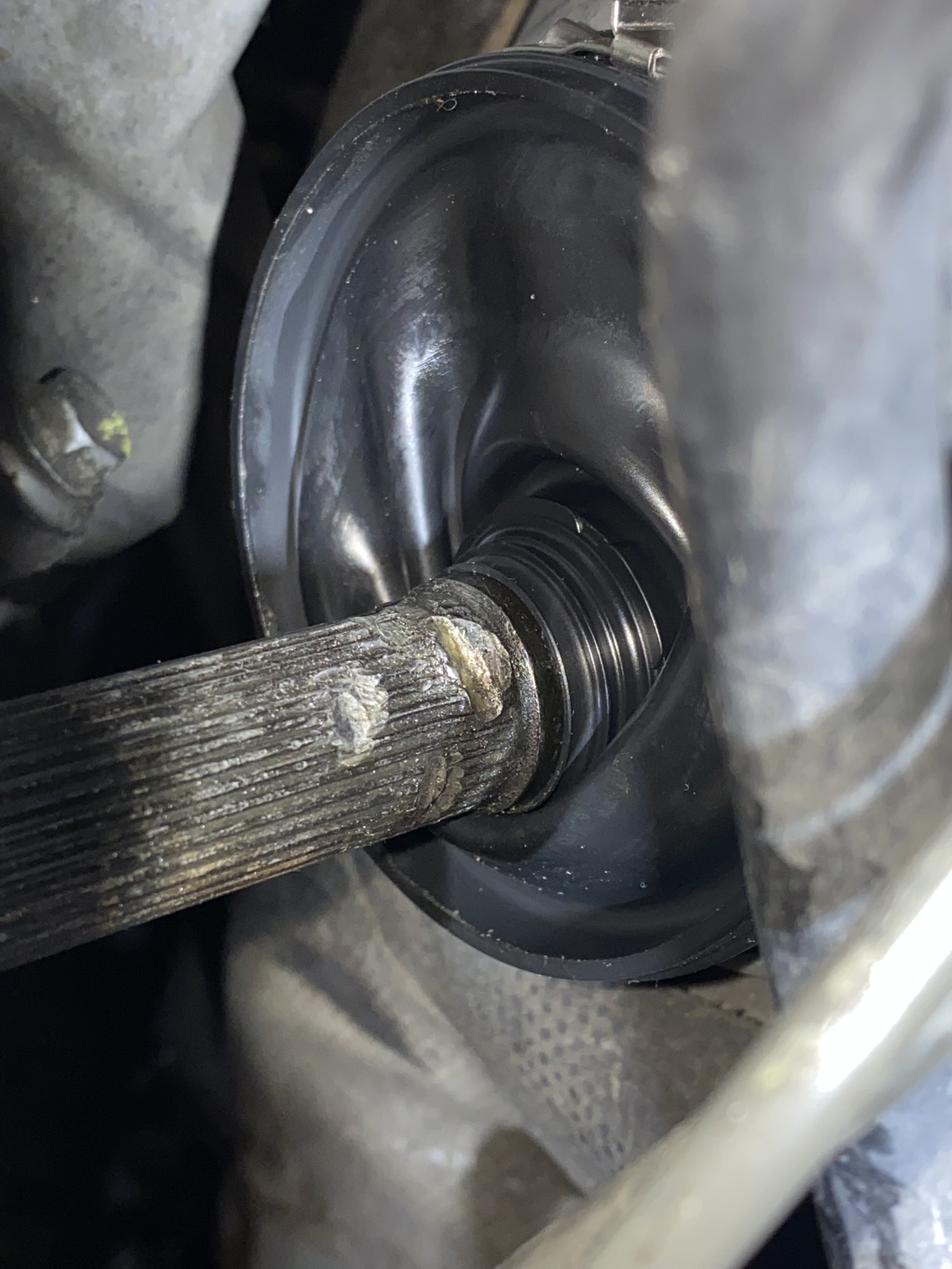

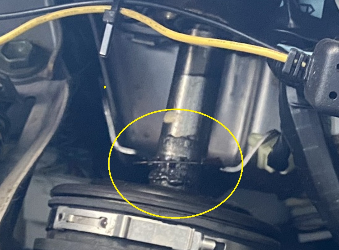

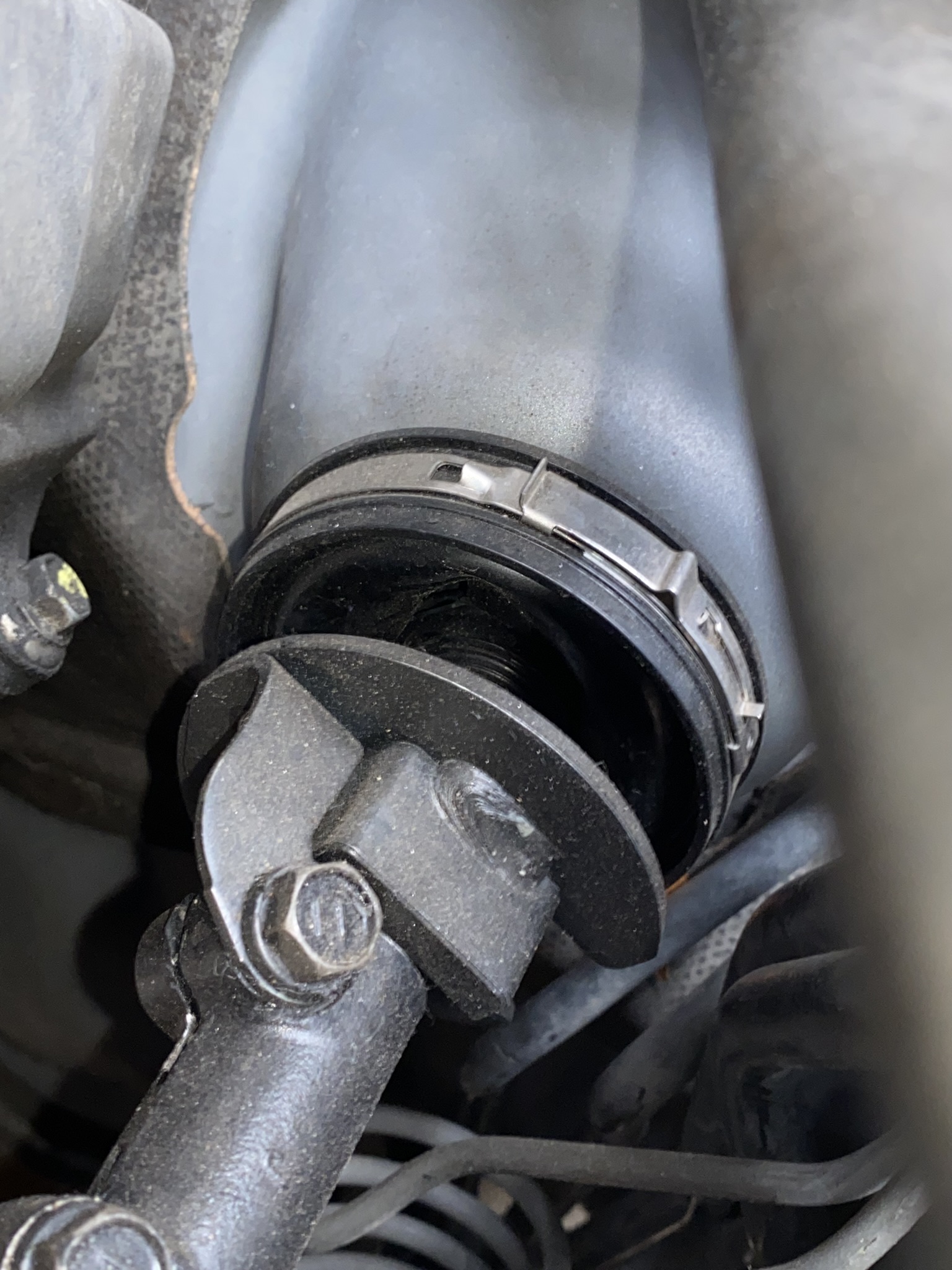

In next two pictures, we see large boot and steering column snap ring that had come free in 03LX VGRS system. This is the reason for 03-07LX snap ring recall. This 03LX with VGRS, hadn't yet been in Lexus dealership shop, for the snap ring recall. Funny at 320K miles, it never had been recalled. Nor did it have any service history at Lexus or even any entries of service in carfax anywhere. It is, my most extensive restore to date. One day with time, I'll right it up in mud.
VGRS actuator is cover by large boot
Snap ring had come loose and slip down shaft. Dangerous!

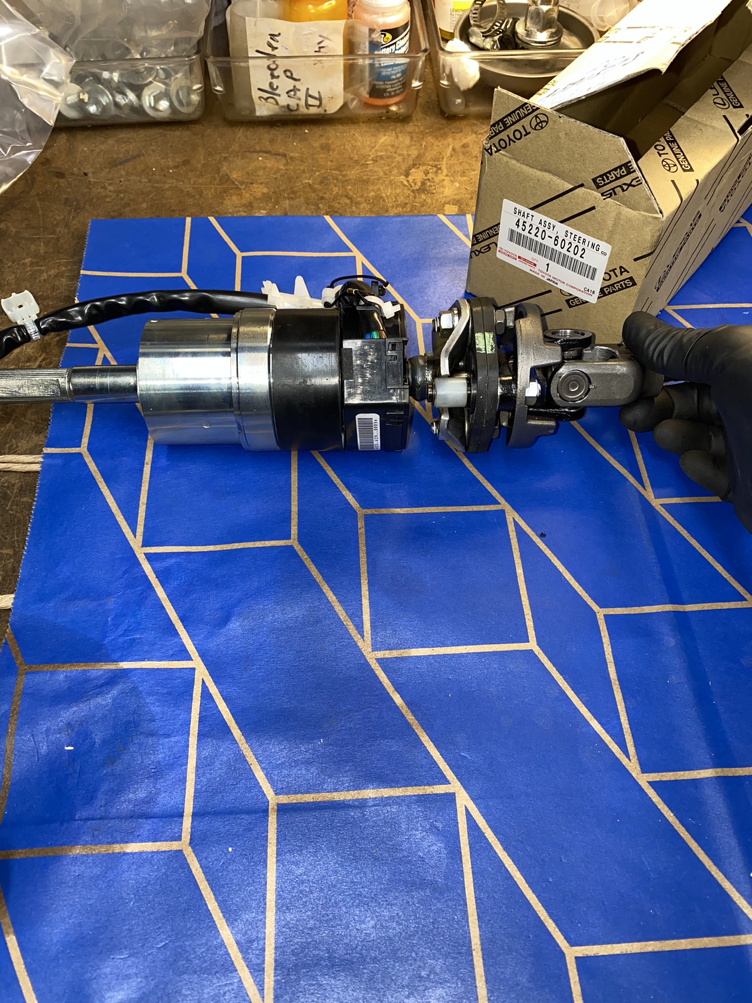

VGRS Actuator (AKA #1 intermediate shaft). A $3k part at Lexus. Which is so rarely replaced. One very large and busy Lexus Dealership parts department, has not sold one in last 10 years (oldest records they have). Their service departs, sees ~100 lexus a day. VGRS is a Lexus product, and in more than just our LX470. They are very robust, built to last forever.
Here is boot cut, after snap ring recall service. Also notice change in components above the boot on shaft and at outside of firewall. It's the only one I've ever seen where Lexus tech cut the boot open.

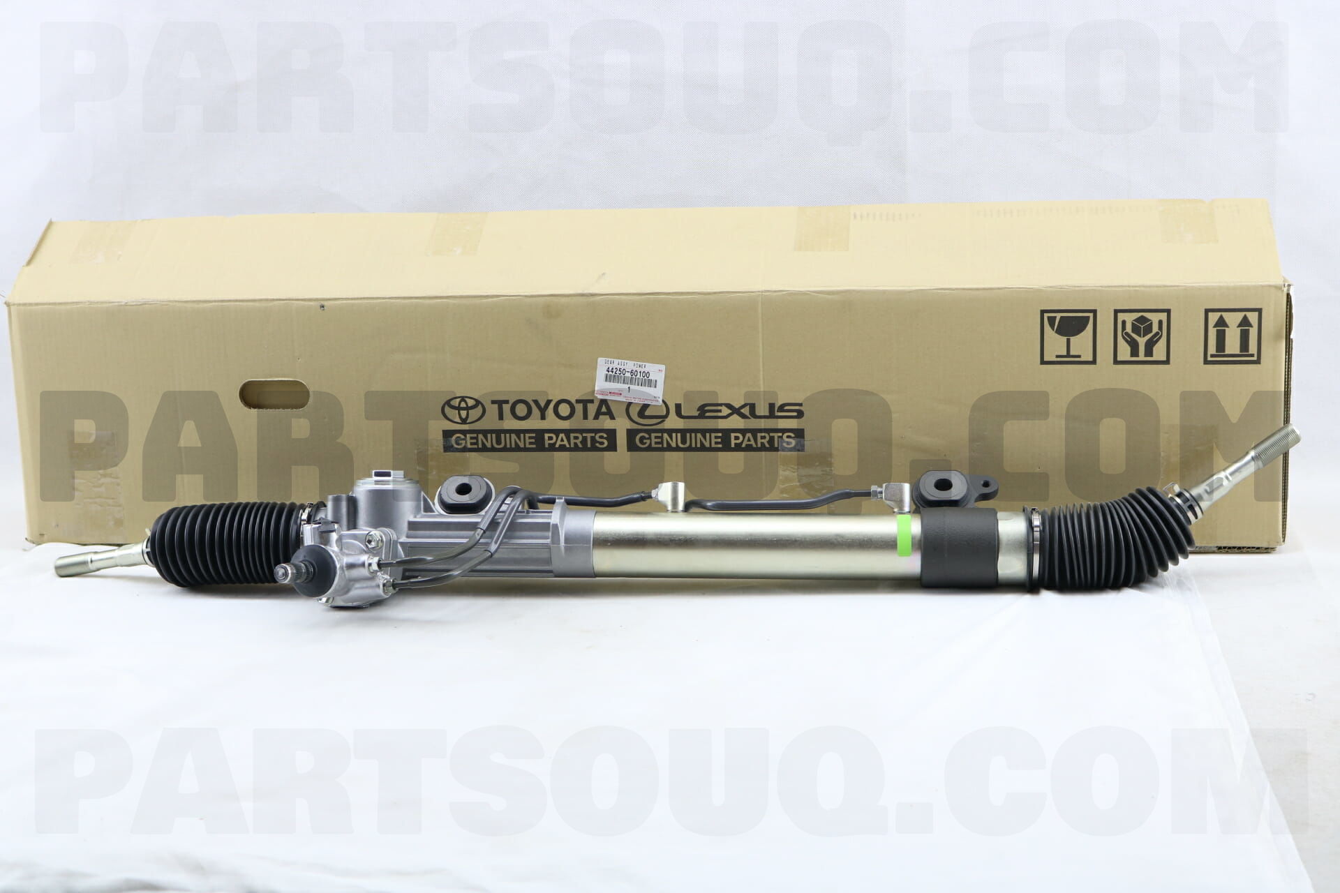

@2001LC just to clarify that 44250-60120 is indeed the correct part number for the VGRS rack for years 2003-2007. (Many Lexus online parts depts display a "this does not fit your 2007 LX470" message when I put it in my cart.)
