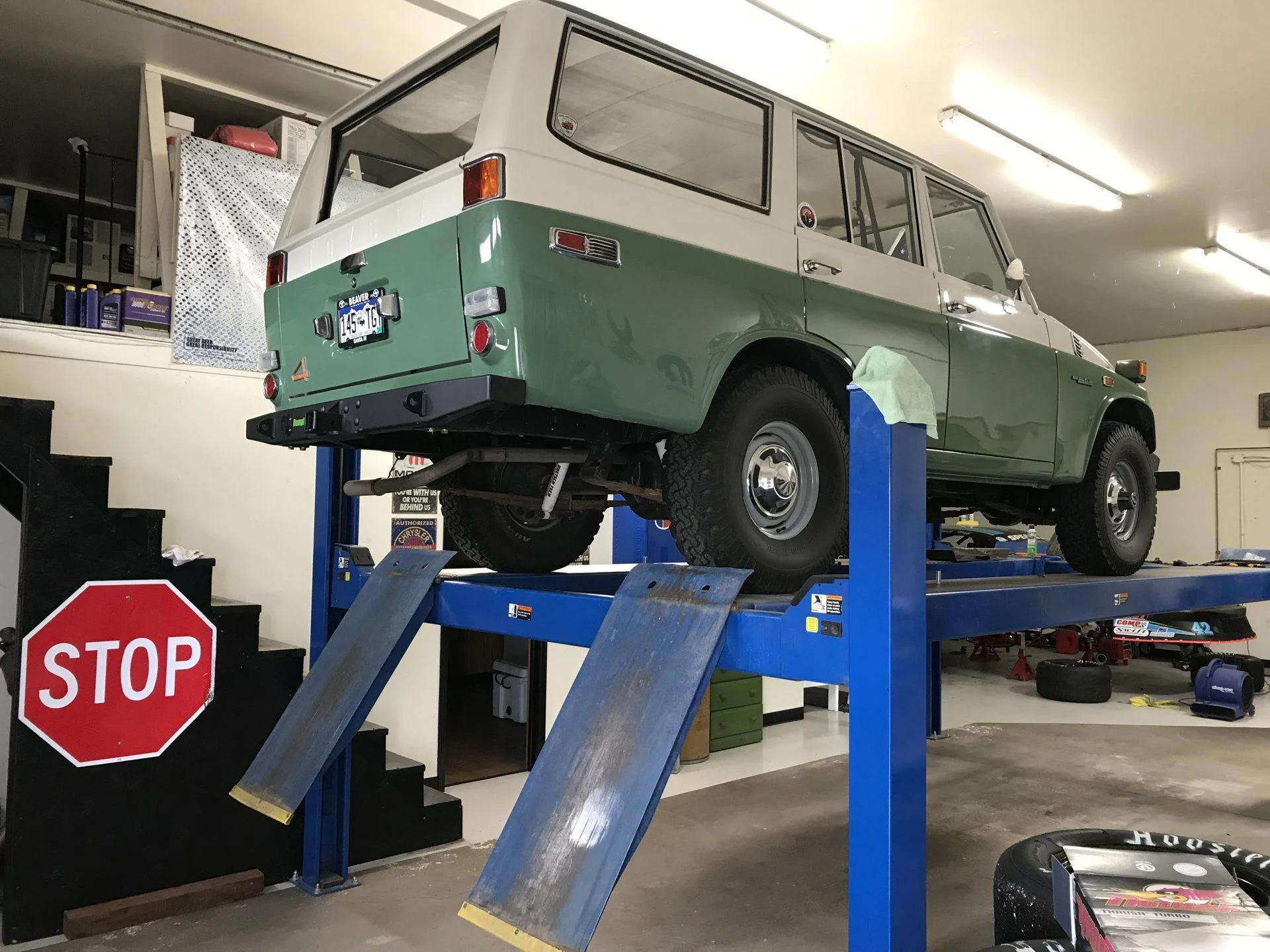

This will be great for hanging a spare under the Pig and freeing up room inside the Pig!
For the 62. I really wanna do the pig, but realized in time that I’d have to cut out the floor pan to fit the auto and full time (soon to be part time) case... and yes... that is the plan; just not this week...

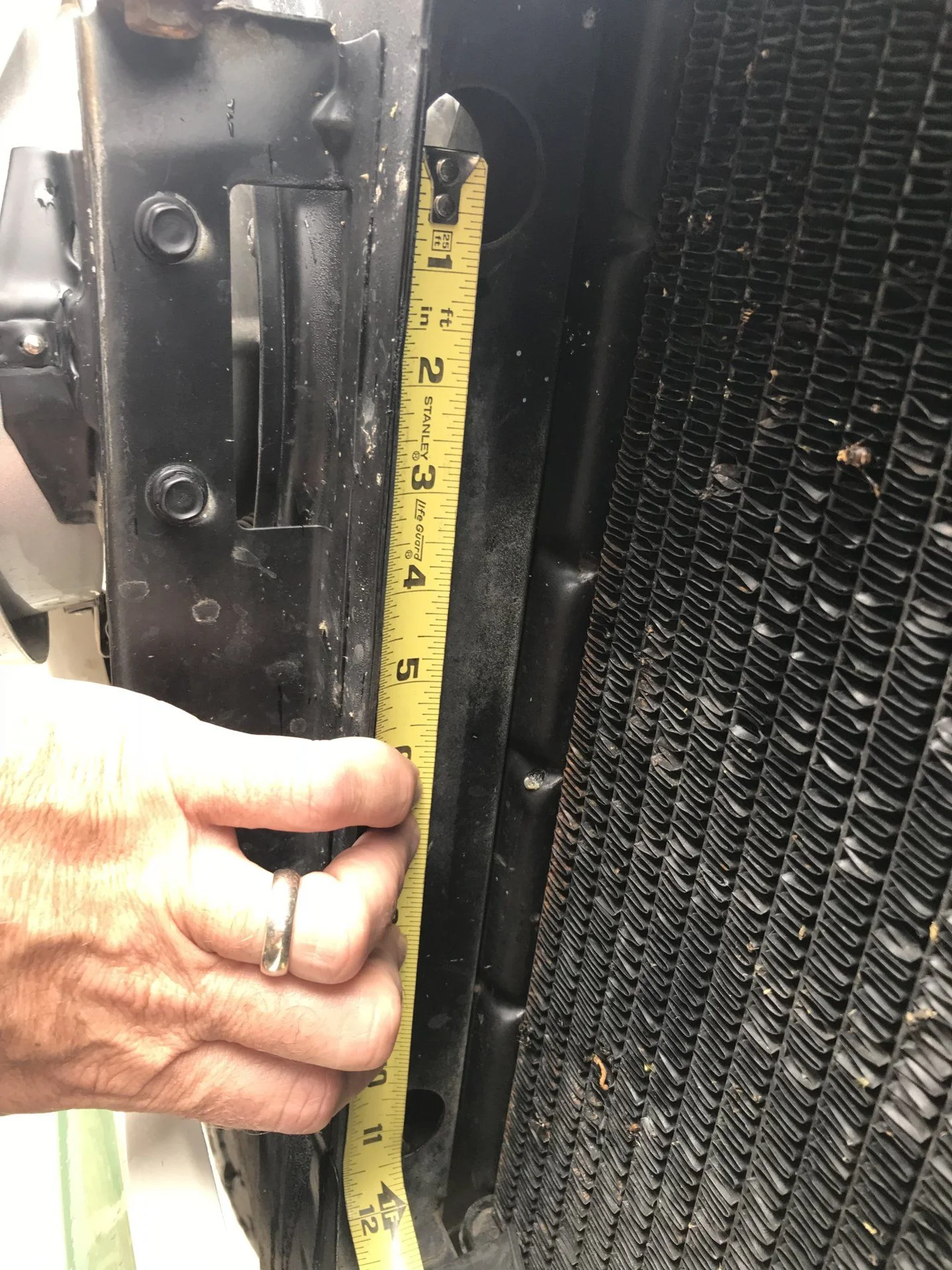

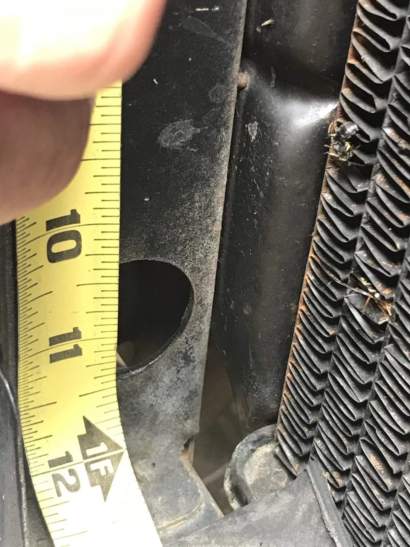

Here you can see compressor pulley lines up with the tensioner pulley:

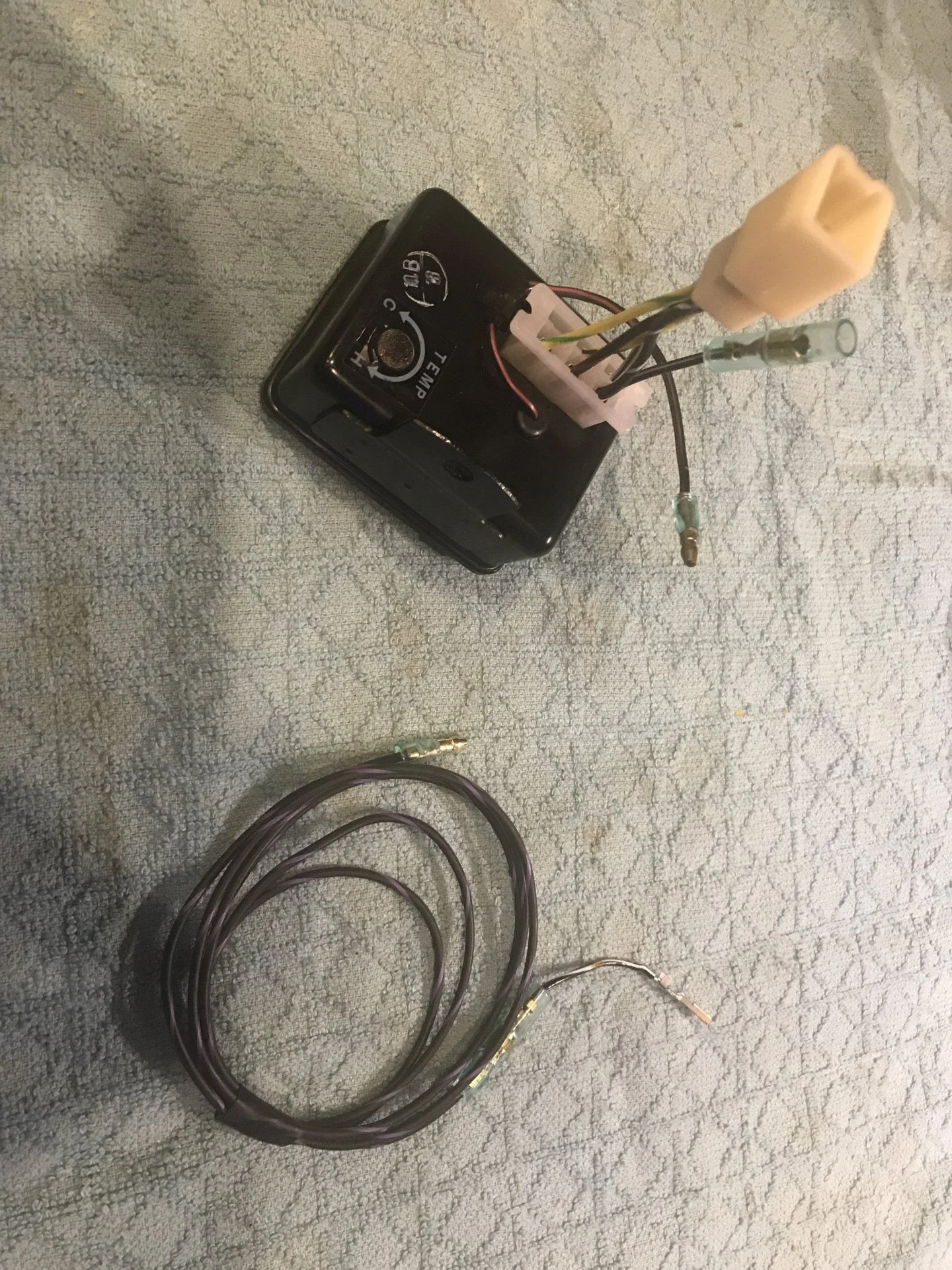

I have a solution for integrating factory a/c to an efi motor; to get rid of the idle speed cutoff function.
Perfect for a piggie with a diesel, or an efi motor that can control idle speed when a/c is on.
It works without any coil input(rpm) but still allows stock thermistor and temp dial to set temp.
More info to follow. Going to build a few for sale, so I will need to get a star. Will include controller box and a small wiring adapter, with or without a wire to integrate to ecu “a/c on signal”
Definitely works with 73 and later systems, but I am going to create a slightly different harness adapter for the 70-73 style.
If you come up with a stock underdash unit, without wiring or controller I can also get you functional with this and a new harness.
Big shout out to Brett - @cruiserbrett for making this happen!
Looking forward to using this controller unit to integrate the Pig AC with the 3FE ECU and compressor.
Thanks Brett!
Thanks Brett!

The pulleys aren’t the issue; it’s the fan shroud.
