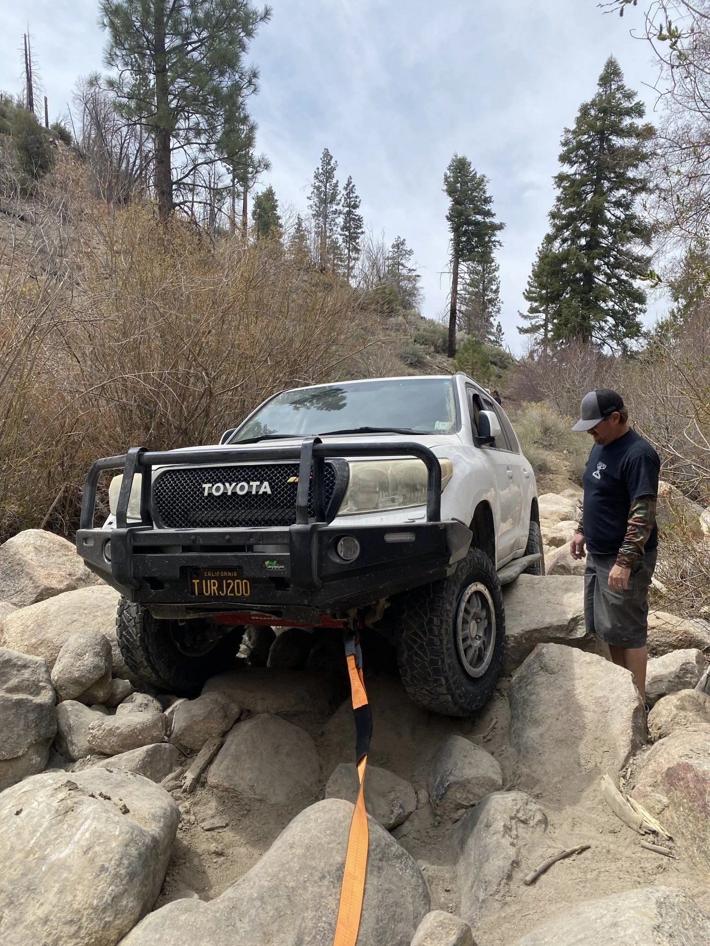

I was at 17-18 , I actually just got the tires 285/75/17 a week ago I used to have c rated but I blew 2 tires out on previous trails, I think the 200 is too heavy for C rated, this time I got the insurance at American tire so anything happens I get a free tire, but instead of it blowing out the tire the bead just popped, I was actually going to try 15 psi but I needed more clearance, this Trail has 5 rock gardens on it. It’s one of the knarlest trail in big bear arguably the worse, it’s this one and John Bull, my buddies don’t suggest me tot try John Bull till I get lockers.

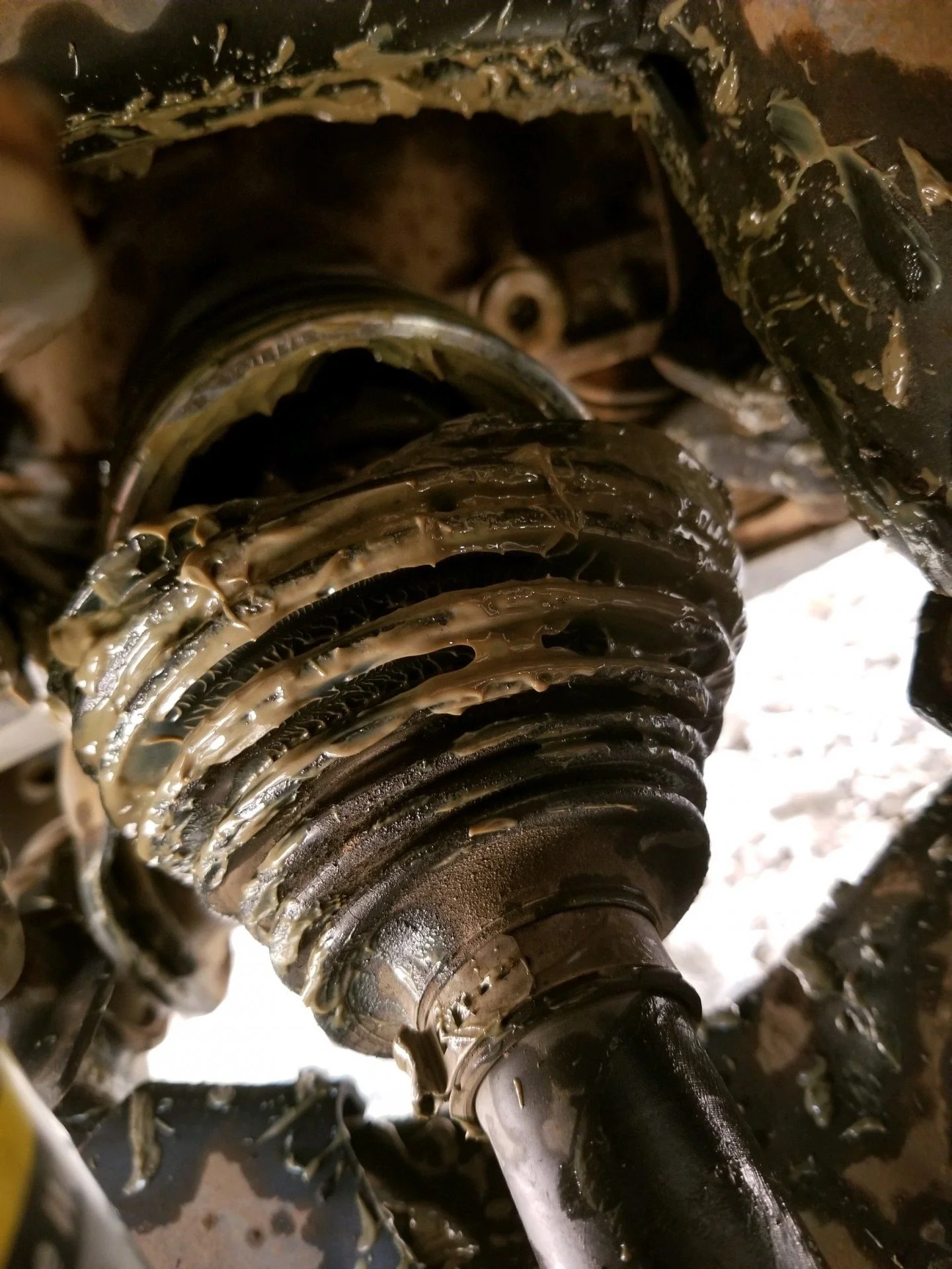

Right I thought at first before seeing the video my wheel was spinning but it wasn’t I think the CV was just tired and gave up
Seems like it wasn’t anything too crazy but could be fatigue combined with some slipping and catching traction for a second. I think that’s a good life for a CV especially if wheeled.
I’ve only wheeled it for about 57,000 miles or so, I got it at 120,000 but I have wheeled it hard all over Southern Cali, this is arguably the second hardest trail in big bear some argue the hardest trail,and it gave up on the 3rd or 4th rock garden after wheeling probably for 2-4 hrs straight, after watching the wheel i think it was just old and failed but who’s know I’m going to start carrying a extra cv like the Aussies do from now on
When my CV blew its guts it was after some wheel spin on a steep incline. I was surprised it went as there wasn’t anything Crazy going on like the wheel spinning and then coming to an abrupt stop while flogging the gas pedal. Earlier on the trail I do vaguely recall seeing Some grease around the LCA but thought nothing of it. Maybe I tore the boot earlier on the trail and then the CV finally gave out a couple miles later. Could be Something like what I experienced Happened with your failure.

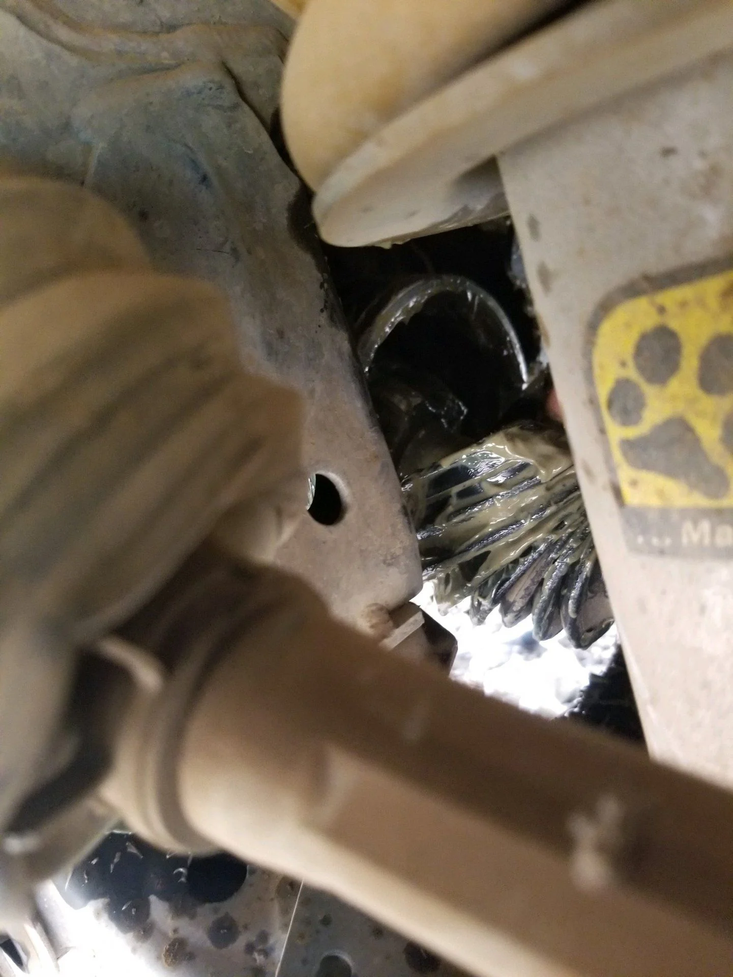

I removed the front drive shaft on the trail and then drove home with the center dif locked. Having a winch was a life saver. Had to use it a few times to get over obstacles as i only had RWD with the front drive shaft removed. It was a Noisy 2.5 hour drive with the cv flopping around. Luckily no other damage occurred. Ended up replacing both CVS so I now have a spare. I was fortunate to have cell service and could get real time help from this forum. Mud members rock! Contorting the front drive shaft out was a real pain.

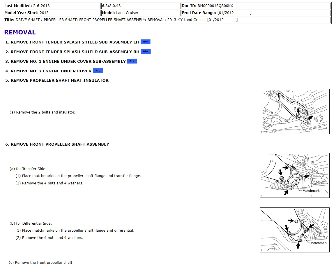

To pull the driveshaft was it just this procedure?
I didnt do steps 1-5. I just crawled underneath and unbolted the drive shaft from the transfer case and then from the front differential. Most important step I learned is that the zirk fitting on the driveshaft has to be removed inorder to get the drive shaft compressed (shrunk down) enough to slide out. That took the longest and I embarassingly spent close to an hour on the trail trying to contort the driveshaft out once it was unbolted. Captain struggle at work. It was still a pain even with it fully compressed. Kept getting hung up on the transmission bellhousing.
Maybe removing the front propellor shaft heat insulator would have helped.
