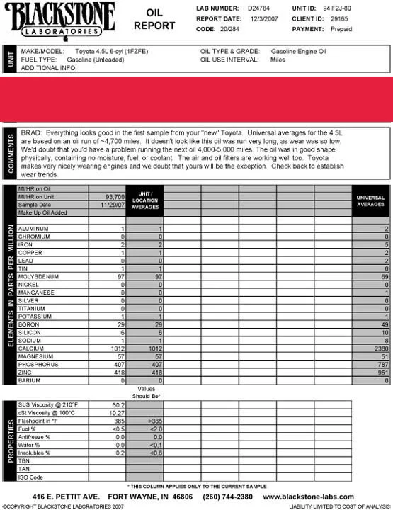

Here's mine. Its been a minute...maybe I should run a second sample
Wow, that's a great report. SUPER low miles on your cruiser too....amazing!
That report was dated in 2007.......

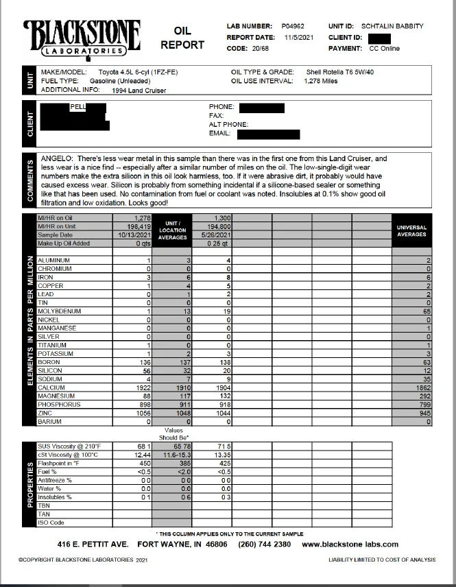

Here's a timely BS report for my baby. Don't know why I have a spike in silicon but I'm going to run another BS report on my next oil change. This time, I'm going 3,000 miles and doing a TBN.
Here's a timely BS report for my baby. Don't know why I have a spike in silicone but I'm going to run another BS report on my next oil change. This time, I'm going 3,000 miles and doing a TBN.
My spike in silicon was due to a hole in my air filter. (silicon, as in sand, not silicone as in a sealant)
Sometimes, if you happen to "drop" your dirty filter during a change and it knocks off some of the dirt into the intake line, it will suck into the engine at start-up and can disperse that way. It may take a couple oil changes to eliminate it.
I had considered doing the washable filter, however they have a slightly larger open area between the fibers and will allow a slightly higher amount of dust through than a paper filter element.
I have stuck with the Toyota paper element so I'm just replacing and not keeping additional in stock. The miles I run are not typically dirty, so it's not a frequent change for me anyway.

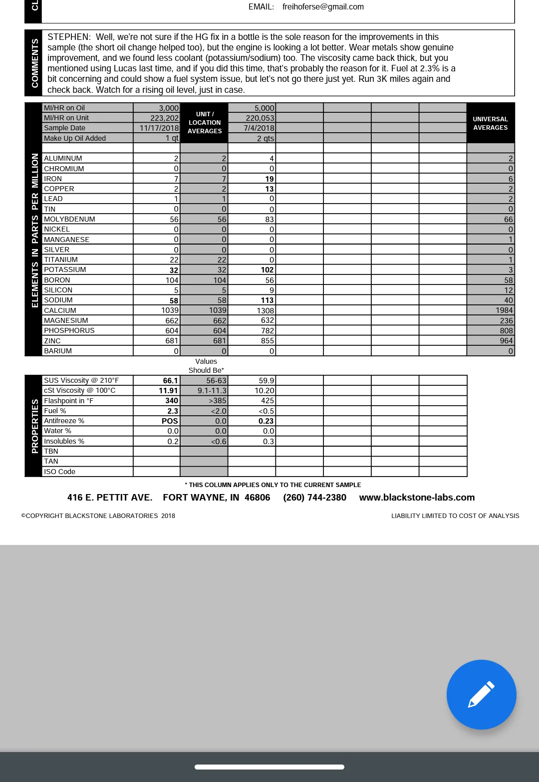

The engine is now pulled and truck getting ready for a 6.0. worst part is the first sample was 10k after a head gasket job.
What's up with this damn silicon?
1) Replace your air filter with a new paper version (It's finer filtration than the washable polyester one) Wipe out the internals before installing the new one, taking care to clean out any dust that dropped from the used filter into the "clean air" side of the opening.
2) Empty your tuna can on the bottom and wash it out.
3) Clean out the inner part of your intake filter housing lid and hose to remove all stuck on contaminants.
It took about 3 oil changes for mine to come back down after a tiny hole in a previous air filter. Scared the crap out of me and I started getting all worried about engine rebuilds. I do very little off road and it really bothered me since I am rarely in dusty conditions (hardly even gravel roads)
Hmmm, I'll check it out! My filter is new as of 7K miles ago and I've cleaned everything you mention as of about 3 months ago. I will do it again and report back. How often do you empty the tuna can?
Whenever I think about it. Since I rarely see dust, it's not often.
Since you are HI and may see sand and beach more than I, you may do it each time you check the oil until you see a pattern. Some guys do it every day if they are desert driving or driving in a row on dusty gravel roads.
