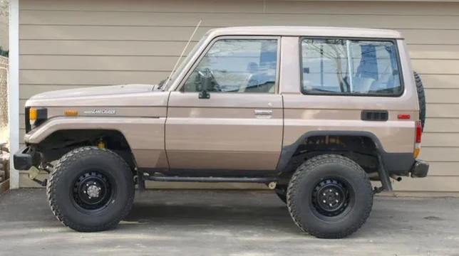

I just got an OME suspension (2.5"). Here are some before and after pics of my 85 BJ70.
First pic shows how I got the truck last year. Tired original suspension, pretty alloys, 31 x 10.5 street tires.
Second pic shows new skinny 32" MTs on steelies (235/85/16)
Last pic is with the new suspension. The old springs were sagging 1.5" so my net lift is 4". And what a difference in ride quality!

^^ Nice ride, Cayman Dennis. Are those factory Toyota steel rims? Looks great. Where in Canada are you located?
Thanks. Yep, those rims are Toyotas. They were used for the spare on 4Runners back in the early 90s. I'm living in Winnipeg (if you call that living!).

Dennis,
Do you know the backspacing and wheel measurments? i.e. 4.00" backspacing and 16"x7" wheel?
Thanks,
Sid
I believe the Toyota part # might be STL69358U45. 18-hole 16"x7" rims with (I think) just 15mm offset. Nothing rubs for me but again my tires are skinny.

Nice, I used the same rims in my Bj70 with the same tire size ...no problem..Dennis, can you post more pictures of the sliders?
