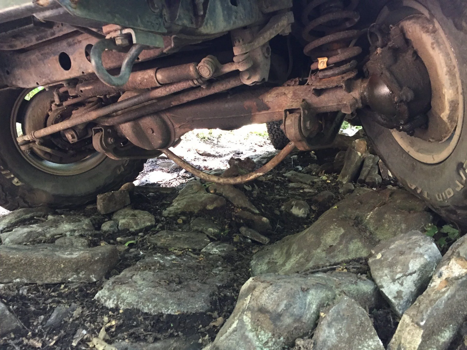

My '96 is having a sleepover in the Western Reserve...I hope it's still in one piece tomorrow morning...
Yeah... you've definitely broken some things... do you have a front locker?
She looks a little pigeon toed!
The bent (badly bent????) tie rod was not the worst problem. The attachment point for the driver side lower control arm was broken off. The passenger side is cracked and displaced, too. Ended up with the axle being twisted upward in the rear with the driveshaft waaaaay out of position. Had it roatated just a little more I think the bottoms of the coil springs might have popped out the front!
Of course this happened way the hell far away from the entrance/exit to the west property. And on a very rocky downhill section coming down off Fern Ridge. Couldn't steer the damn thing with the front wheels splayed outward on both sides. Had to hook a tow strap up to his rear bumper and David dragged the rear of the 80 back onto the trail facing backwards. There were several areas on tight turns that the 80 just wouldn't steer around and Dave and I both had to pull the 80 around some of the corners. Was a bitch. We were able to move it downhill driving backwards for a few hundred yards till we got to a spot that was somewhat level. By that time the tie rod had straightened itself out a bit and the axle was still kind of settled in it's awkward position. Drove forward for a while trying to get to the exit but then the tie rod bent again. We removed it and hoped to sleeve it with the hi lift jack handle but we couldn't straighten the damn thing.
Greg made the decision to just leave the truck where it sat, and removed whatever things of value that were inside it. We drove out to the exit (about three miles from where the truck is sitting) and had to call the office to have someone open the gate as we were way past the 2PM deadline to exit the western property. Lucky enough Greg's wife was in the area and was able to pick him up at AAOA and take him home.
