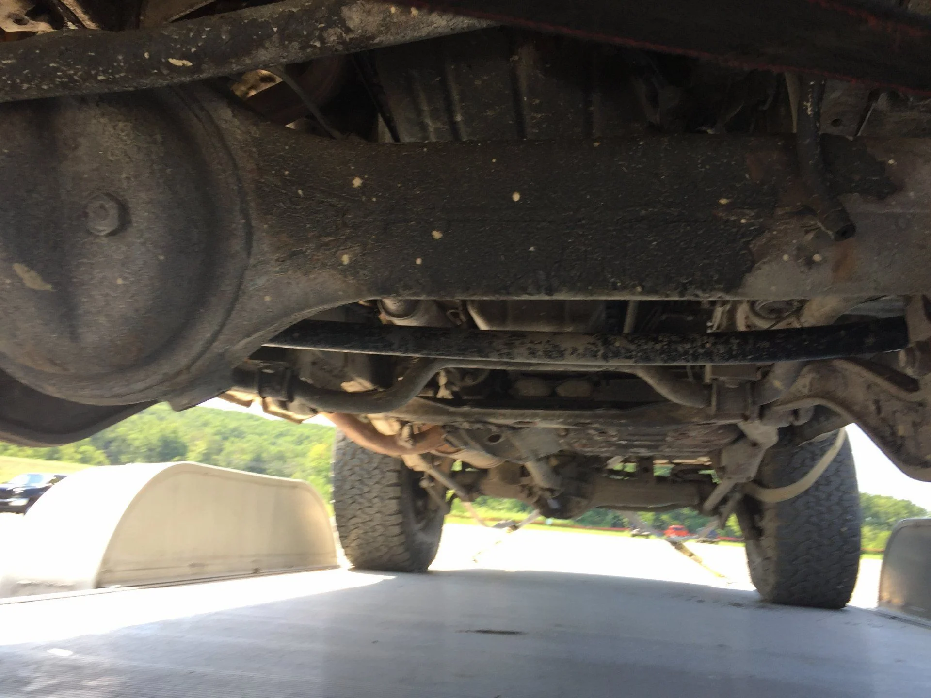

Made it back to the lot safely and loaded it on the trailer. Took a peek underneath and the tie rod, which ws totally straight, was now significanly bent. Some weird forces going on with the broken control arm mounts.
Here's a few pics of the rear lower control arm mounts that used to be attached to the fromt axle...
I'm not entirely sure what I want to do with this truck. I could put some rust free axles in it, which I have, or I might just sell it as it sits. If I go the axles route, it would also mean new springs and shocks, and brake hoses, and..........

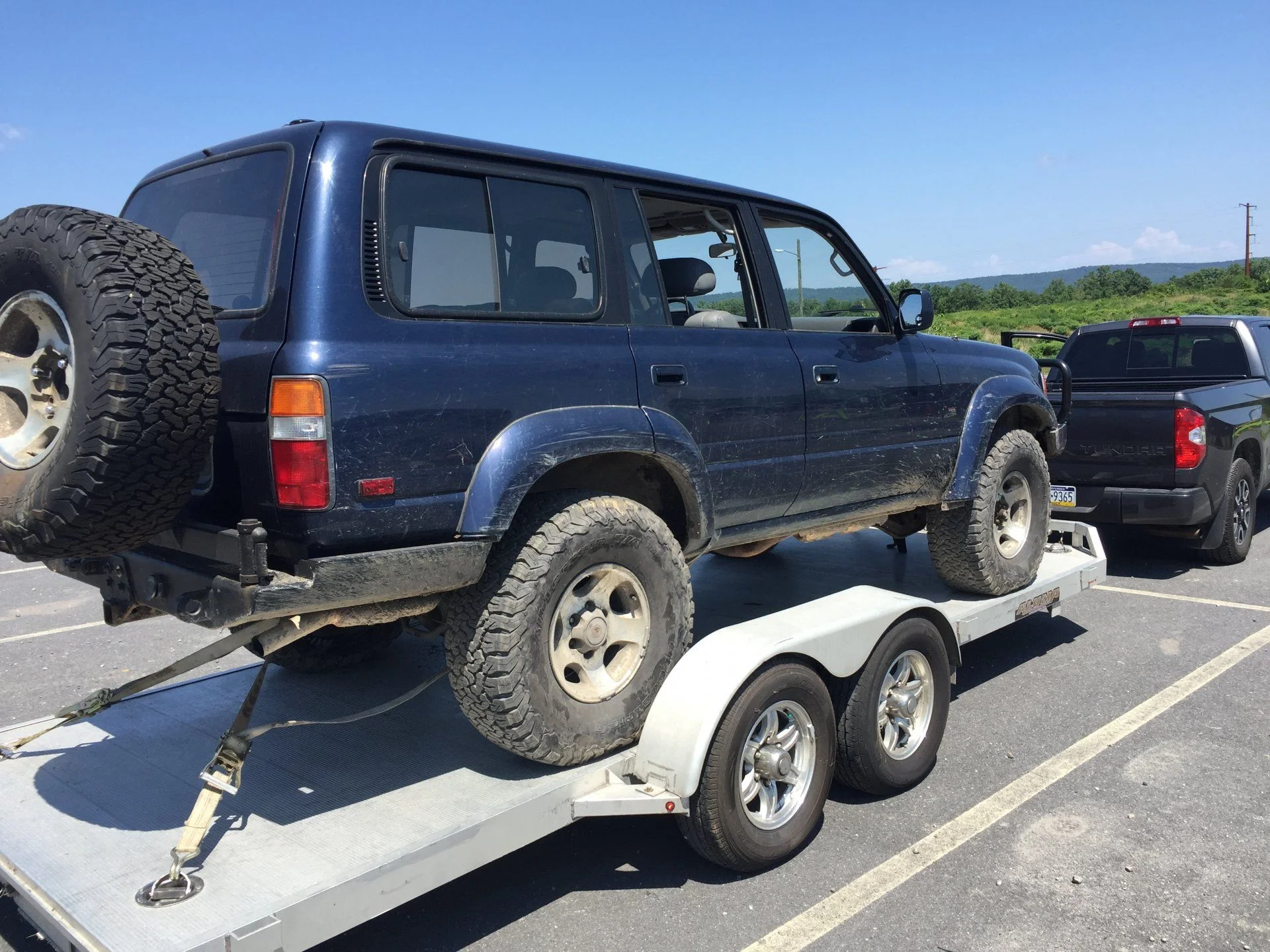

@jamarquardt22, we did utilize my new trailer!
Poor truck went through the ringer yesterday. R/F flare almost torn off,
L/S doors are now dented, and a large dent in the left rear behind the sliding window. I backed hard into a tree and bent the spare tire carrier as well :oops:
It's starting to look like my'93 :rolleyes:
Yeah was quite the bitch dragging an 80 with almost no steering backwards through a tight rocky trail and negotiating all the turns around trees! Amazing that this story ended , or should I say got to this point, as good as it did. I managed to bend the passenger front fender on the 40 when I slid into a tree while trying to winch Greg's 80 off a tree. Whew was a tiring day but today has a happy ending.
Oh. I see. I thought a steering arm failure happened. I didn't realize it was the axle mount. How bad is the rest of the frame? If the axles are still sound and the frame is solid you could do a real 3 or 4 link for her.
What's the buy it now price on it?
Brian, if I do go that route, I'll give you first crack at it. Right now, it's parked up in the woods on my property (out of sight, out of mind). I'm going to let it simmer on the back burner for the time being. I have a LOT of other things going on right no that demand my attention...
