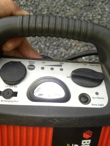

What are the amps on that one?
This is what is on the sticker:
Model: VEC010BD
Output: 12V DC --300 amps instant
5 second 225 amps DC
It's even got a light! ;)
Sent from my iPhone using IH8MUD

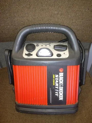

I had two HF ones, and both failed within a few months. I bought this one last October to crank a Cat backhoe in the winter, and it worked great. I have only had to charge it once. They are real handy once you get a reliable one.
$50 @ the Depot
BLACK & DECKER 300-Amp portable jump start
